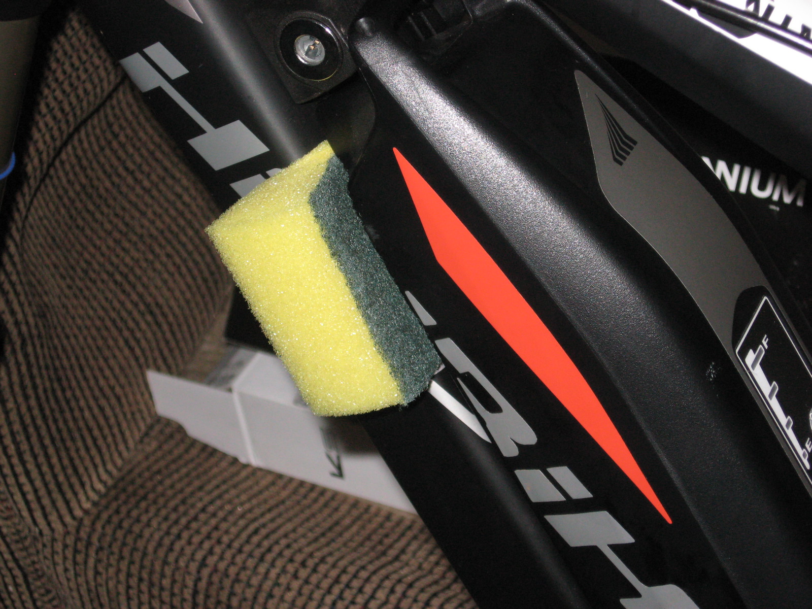

Thanks, that helps. Looks like a closed cell foam. I'll look for something like that. Check out the pic of what I'm using, a new pan scrubber from the kitchen. It works great too. For how well designed and finished the rest of the bike is, surprising the battery is allowed to have so much play.
that looks awful.

Thanks, that helps. Looks like a closed cell foam. I'll look for something like that. Check out the pic of what I'm using, a new pan scrubber from the kitchen. It works great too. For how well designed and finished the rest of the bike is, surprising the battery is allowed to have so much play. View attachment 13579
Try your local auto parts store. They'll have all sorts of DIY adhesive backed weather seal foam for doors, hoods and trunks. It's fairly inexpensive and will hold up to outdoor use. Prior to applying, wipe the surfaces with a soft cloth and isopropyl alcohol (rubbing alcohol).
