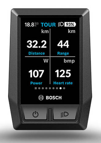

Let's quickly mention the Homage's only serious flaw – its Kiox display (** 2). Kiox is clearly a work in progress and R&M should have clarified this. For the Kiox to be more than a glorified Purion (Bosch's most basic controller), it requires an app which is not yet available to everyone. Has anyone been able to download the app? Is the app available in Germany or elsewhere in the EU?

David, it sounds like whatever you don't like about the Kiox can be--eventually--fixed with some necessary software updates. I suggest you make a detailed list of what you don't like about the KIOX and send that list to @Court. That is what I intend to do after I have spent some time on my new Homage. It is currently being prepped by my LBS. I have written software all my life and use a large assortment of applications on my Mac. When I find something that is buggy or poorly implemented, I email the developer. Most of the time I get a positive reply and often my suggestions are implemented in subsequent releases.
Court is friends with a lot of Bosch folk and they respect and listen to him. I once pointed out to him, after seeing his early KIOX demo, that the color for ECO mode was blue. I asked him to mention to his BOSCH contacts that ECO mode--for obvious reasons--should be green not blue. Court also pointed out early on that the horizontal scrolling on the KIOX display stopped at the end. Court mentioned this to BOSCH that it should wrap around to the beginning so that the rider didn't have to click his way back to the first screen. His newest review of the KIOX shows that the ECO mode color is now green and the display wraps around at both ends. So clearly someone is listening.
The KIOX is a brand new product and as such is a work in progress. Most engineers don't know how to design a good user interface. That's why it is considered an art. Crikey, look at the poor graphical interfaces you find in automobiles. That's why it is important that we, as the users of these devices, send feedback to the developers so they can correct and improve the usability of their products. In this case, there is no one more qualified than the cyclists.

With regards to the KIOX, honestly I believe Bosch is charging enough to not release work in progress products. They should only release something once it is close to flawless, I find this disappointing. We are not paying beta tester prices...
David Berry
Most engineers don't know how to design a good user interface… In this case, there is no one more qualified than the cyclists.
Ah, exactly! I think Bosch needs to find a developer with two heads that can work on a project independently and interrupt each other to get the optimum result. There must be a name for such a character.

  • As the battery drops in capacity the percentage indicator on the Kiox display (d – top right) will change from white to yellow and finally red, at which stage the motor assist will shut down but…

Some of the things I like about the Kiox display…
  1. Screen legibility – high contrast, high resolution, daylight-usable.
  2. Choice of background – white data on black background or vice versa.
  3. Restrained (and logical!) use of colour – green, blue, purple, red for ECO, TOUR, eMTB, TURBO.
  4. Continuous page scrolling – no need to backtrack from last page to first.
  5. Correct use of SI symbols – km/h, Wh; not DIY abbreviations – kph, w/Hr's.
  6. Logical settings menu – easy to set wheel size or E-14 start gear.
  7. Power outlet – smartphone fully charged despite continuously downloading map data.
  8. Case – neat styling complemented by bespoke housing.
