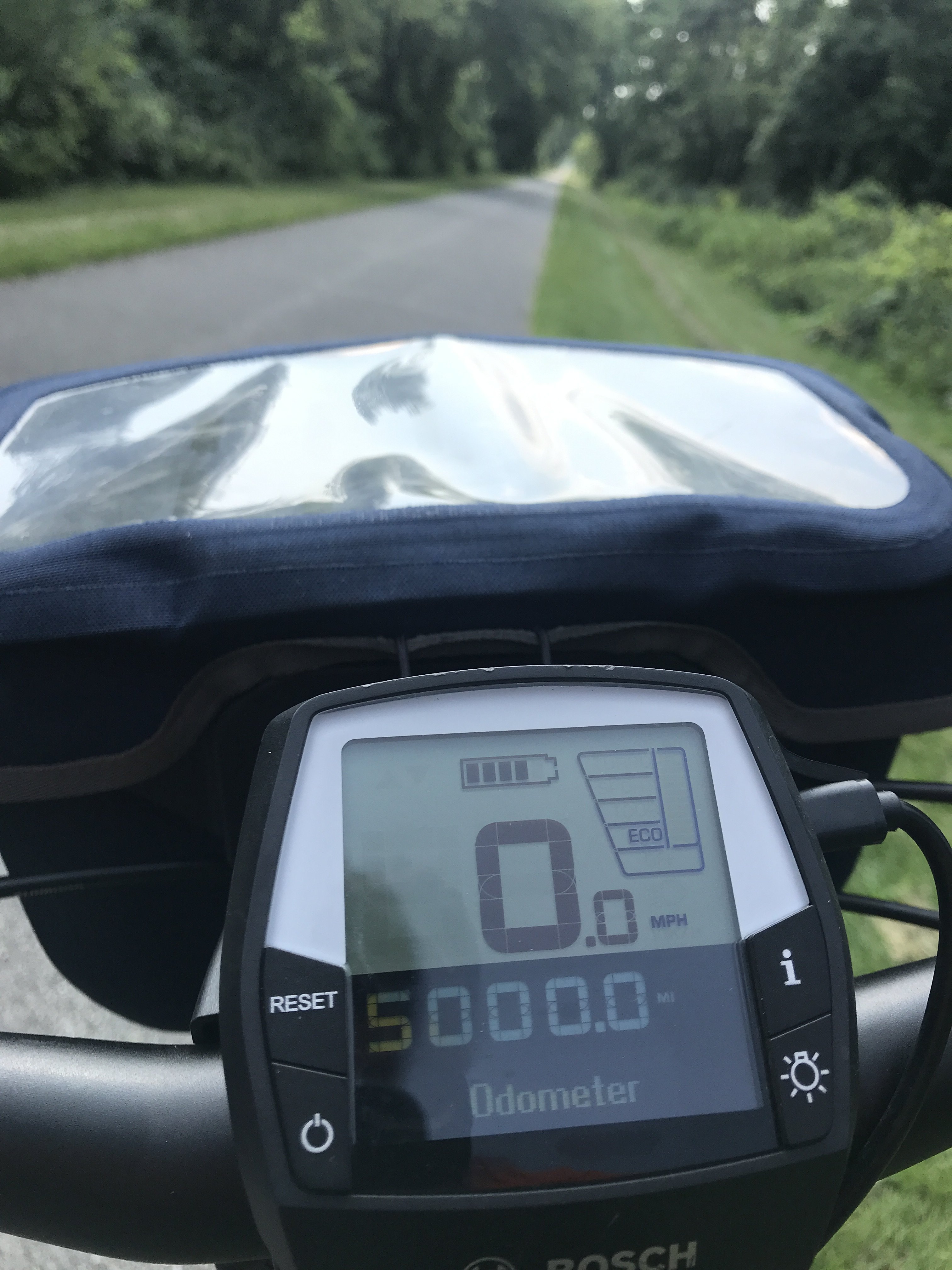

5000 miles, xm700+
Saratoga Dave
What can I say? 15 months since I bought this in Saratoga County, NY, rolled past 5K this morning on a HUMID ride along the Mohawk River. Bike has been near flawless. Replaced the chain and cassette around 3K, had one incident where the boost level wouldn’t behave (dirty contact)... one rear tire.
All pleasure riding, I’m retired and don’t go anywhere I don’t want to anymore. This has been one terrific companion. I should get another 1000 on it before the snow flies this year.
Highly recommended.
