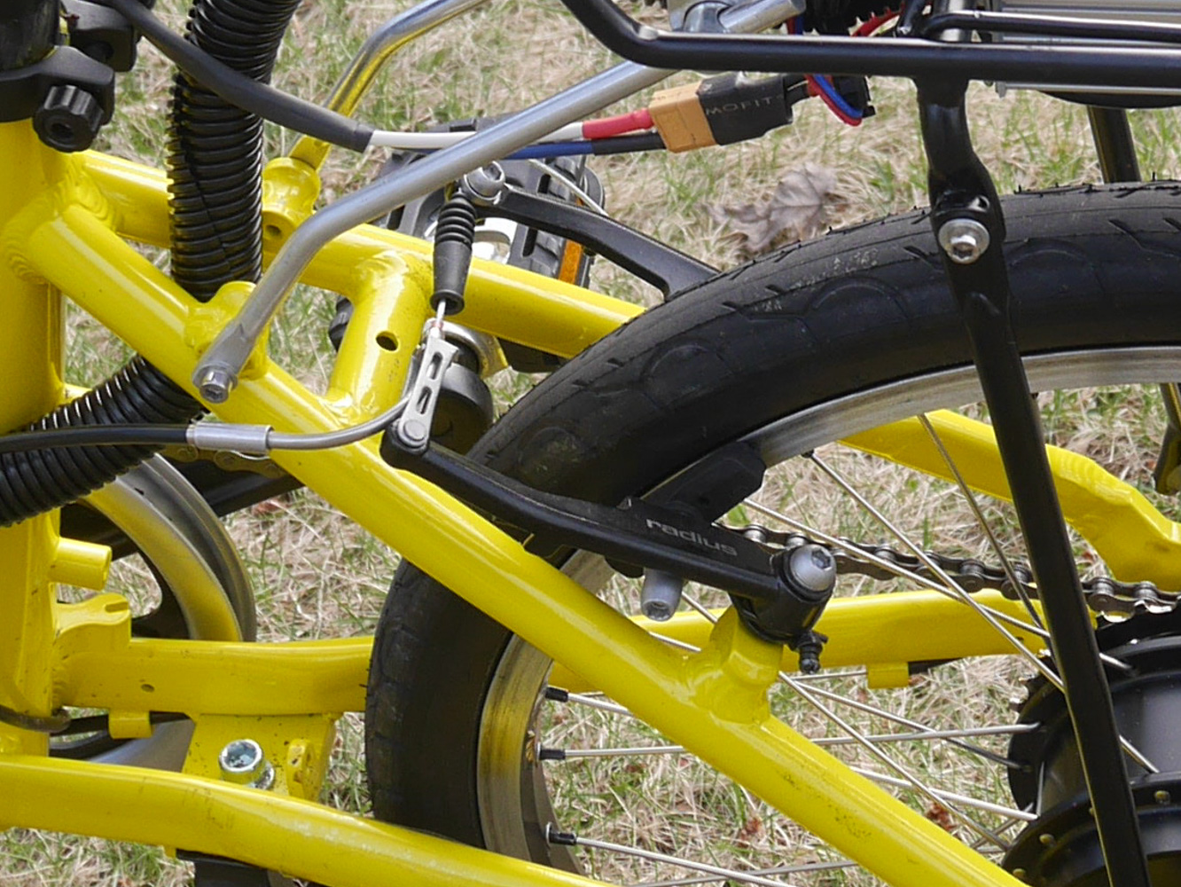

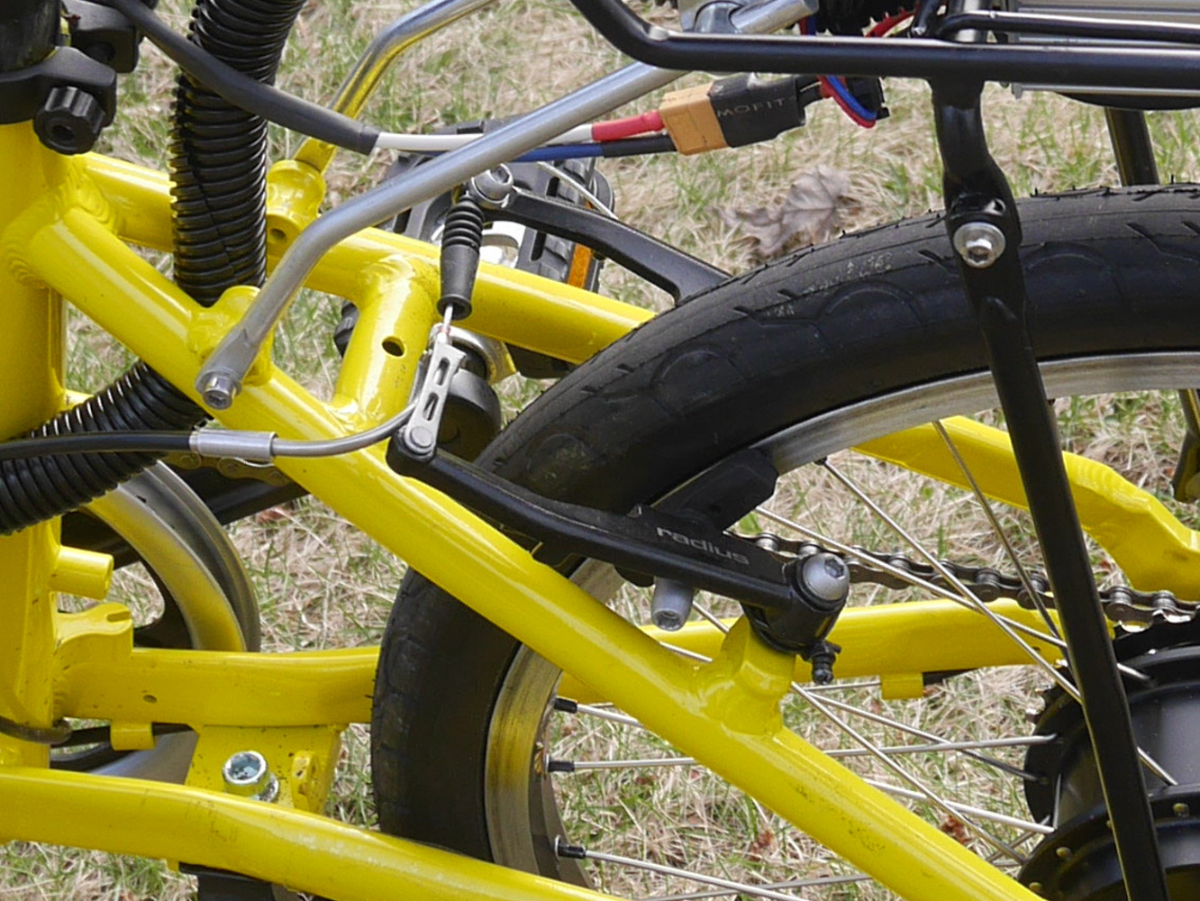

3) Switch to this kind of brake. I have them on half the bikes I converted. In fact, the first ebike I converted wouldn't stop and it had 20 year old center pull brakes like yours. I was losing a lot of friction in the cable because of rust so I changed that too. Least expensive solution. and worth a try. It also has the same ebikeling motor and stops very well with these style of brakes. I also changed the fork, but never saw the need to put on a front disk. This pic is of a later bike.
