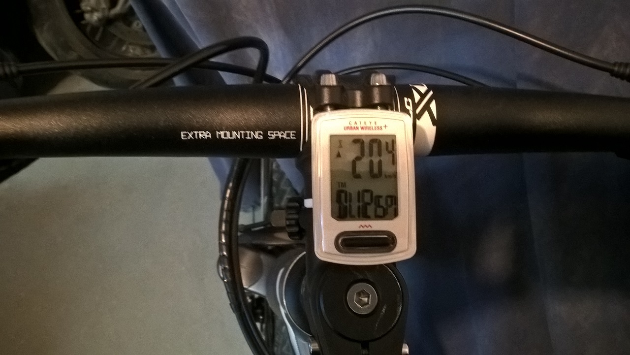

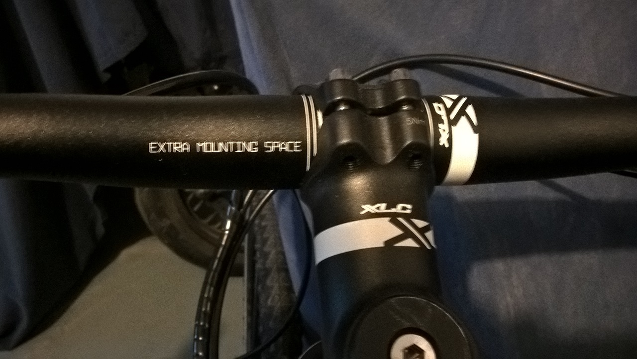

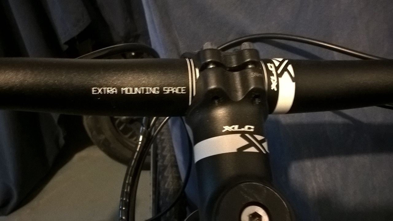

I found this detail on the handlebar pretty amusing. I'm wondering if it was something that was written on a design drawing and accidentally got included in the final product:

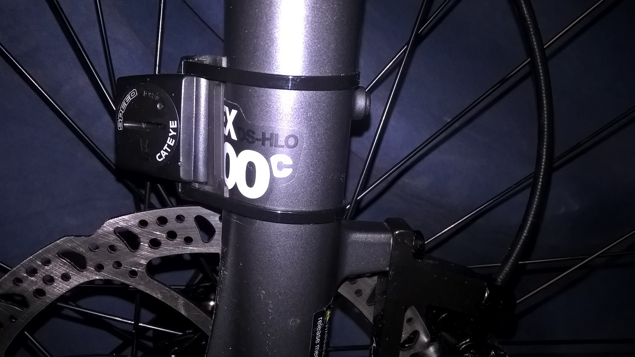

Since I ride an SDuro SM which doesn't have an odometer I picked up a CatEye Urban+ wireless. One advantage of this is that if I move the speed sensor to the crank from the rear wheel I'll still have an accurate speedo and odo.
I didn't want to use up any of my valuable "Extra Mounting Space" :D

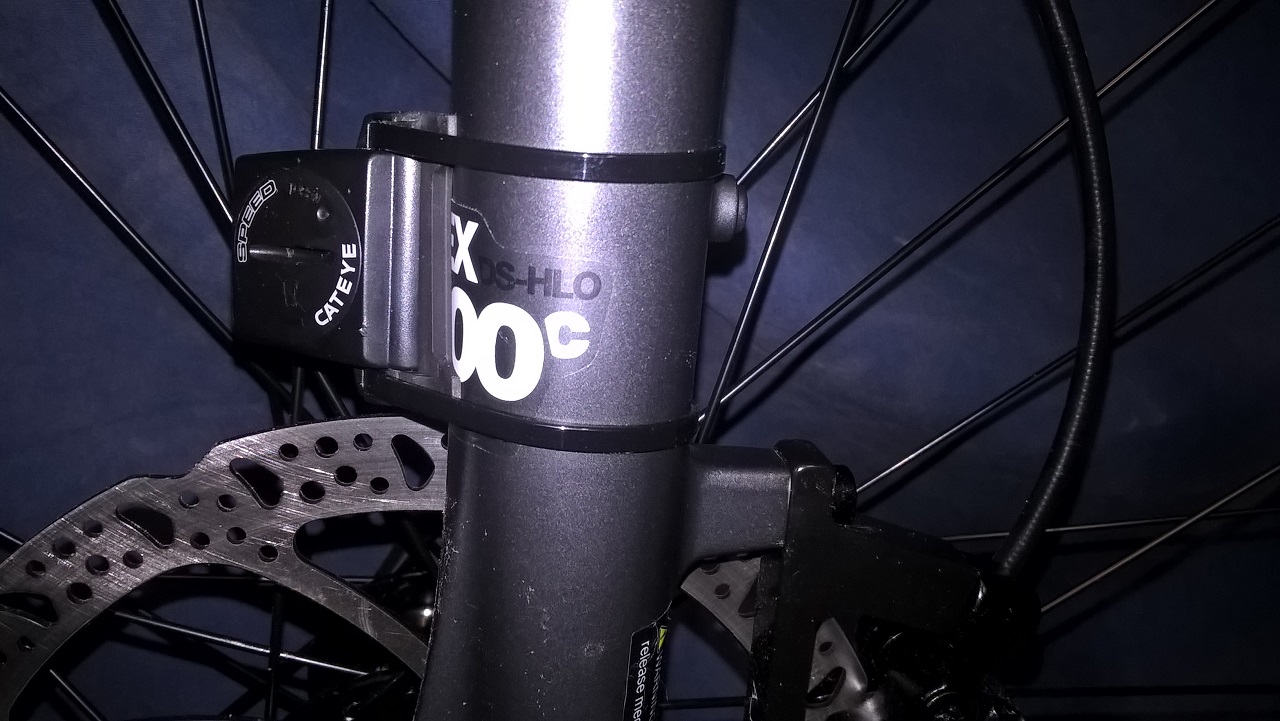

I located the speed sensor right over the front rotor. This is the third mounting location I tried. It seems awfully close to the rotor but the it's stopped from moving down by the bung for the front fender mount. Also if the sensor should come in contact with the spokes the spokes will just knock it out of the way. I had originally mounted the sensor on the back of the fork but if started interfering with the spokes it would be force into the wheel instead of away from it.

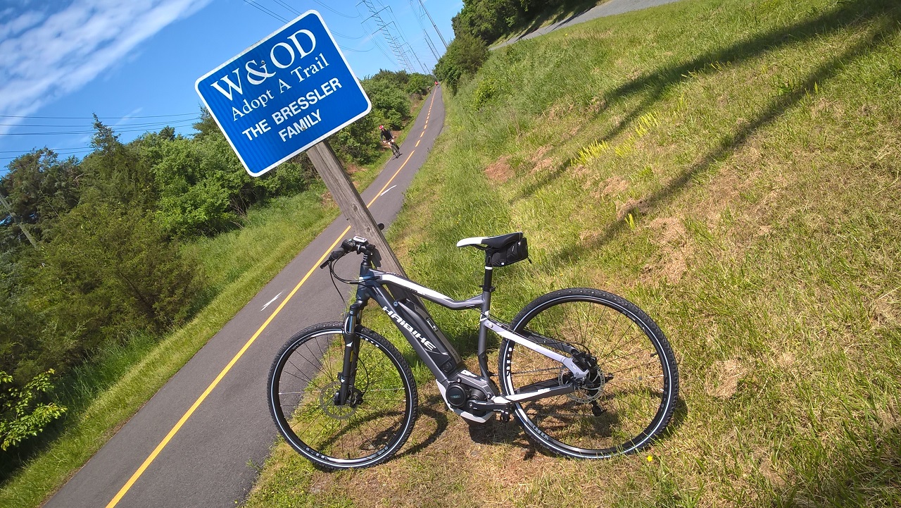

Here is my SDuro Cross in it's natural element on the W&OD bike trail. I took it out for about 10 miles on Sunday which isn't particularly far but it is the longest bicycle ride I've taken in the last 10+ years.

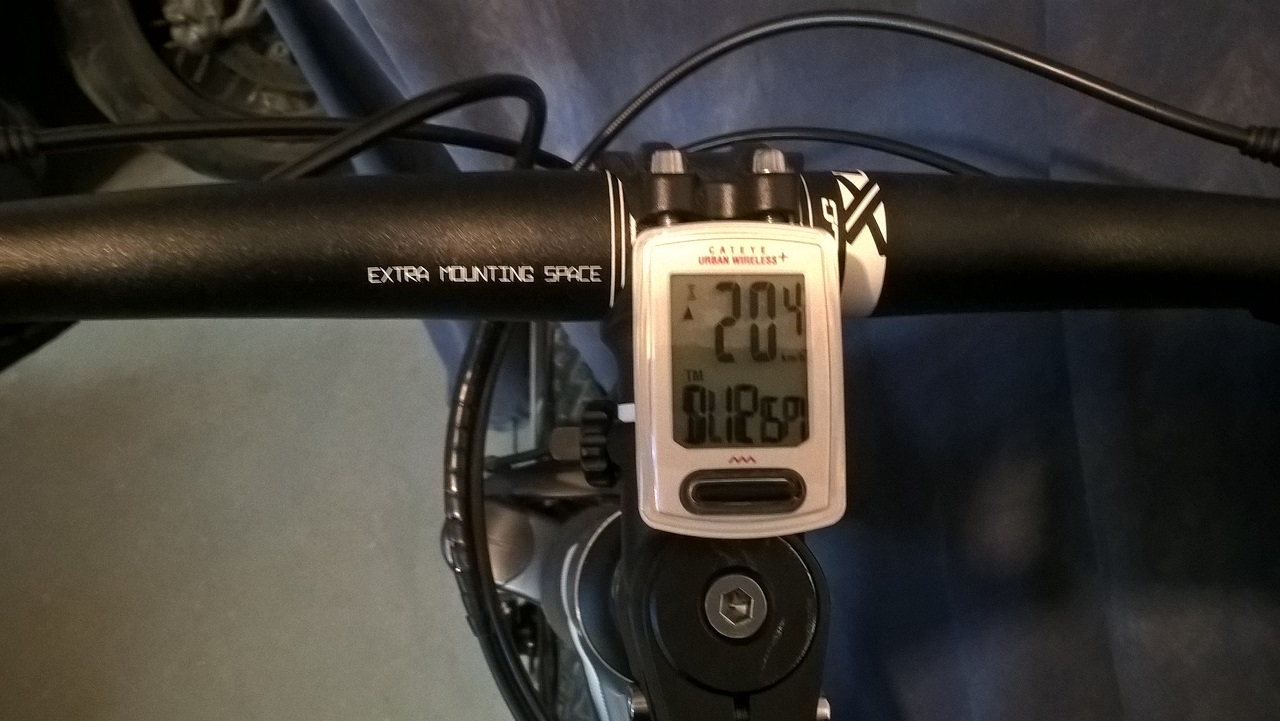

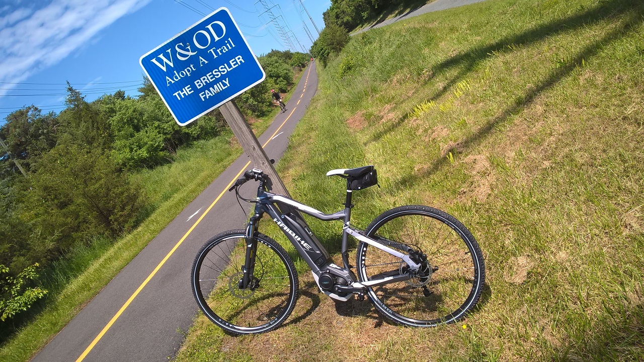

Thought I would start a thread for all the SDuro owners to share info, pictures, ride reports, issues, mods and whatever else might be SDuro related. If you have an SDuro please post up the model, size, your height/inseam and anything SDuro related.
I'm 5'8" with a 29" or 30" inseam ( I buy 30" leg jeans). My ride is an 48cm SDuro Cross SM and I believe it's the ideal size for me.
I found this detail on the handlebar pretty amusing. I'm wondering if it was something that was written on a design drawing and accidentally got included in the final product: View attachment 16520
