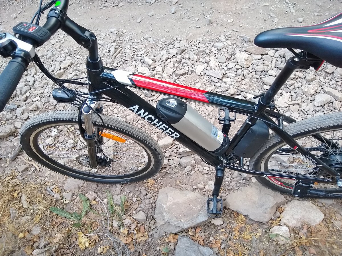

Court sent me an Ancheer Ebike for testing that Mikey had reviewed prior, thanks Court and Mikey! Not surprisingly, it failed during testing...
Here's the data, with a failure summary toward the end:

  • Complete hill climb: One mile long hill completed in 6:55, average speed of 8.5 mph, average pedal power of 186 watts. NOTE: The motor stopped just short of the crest – ebike inoperable after that. Failure determined to be motor controller, most likely due to overheating. Read below for more.

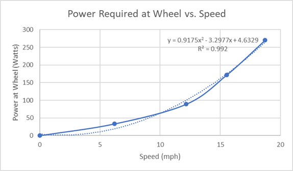

For the road load range evaluation, the bike is simply pedaled with zero assist at 5, 10, 15, and 20 . The power required to move the bike at each speed is then determined and an equation is developed to represent that relationship. The Ancheer Mountain Bike results are below:
Once this is determined, one can calculate the power required to maintain the speed of each PAS setting:

Ancheer Road Load vs. Speed

However, with only 10 feet or so left to the crest, the motor stopped assisting. Both the motor and controller housing were very hot. After allowing for the ebike to cool off, the motor would not apply power, or even make any noise, with throttle or pedal assist. After some diagnosis, it appears the motor controller had failed as there is no DC voltage going to the hall sensors. The motor tests okay with a digital multimeter but it too may be damaged. This report will be updated as more is learned about the failure.
