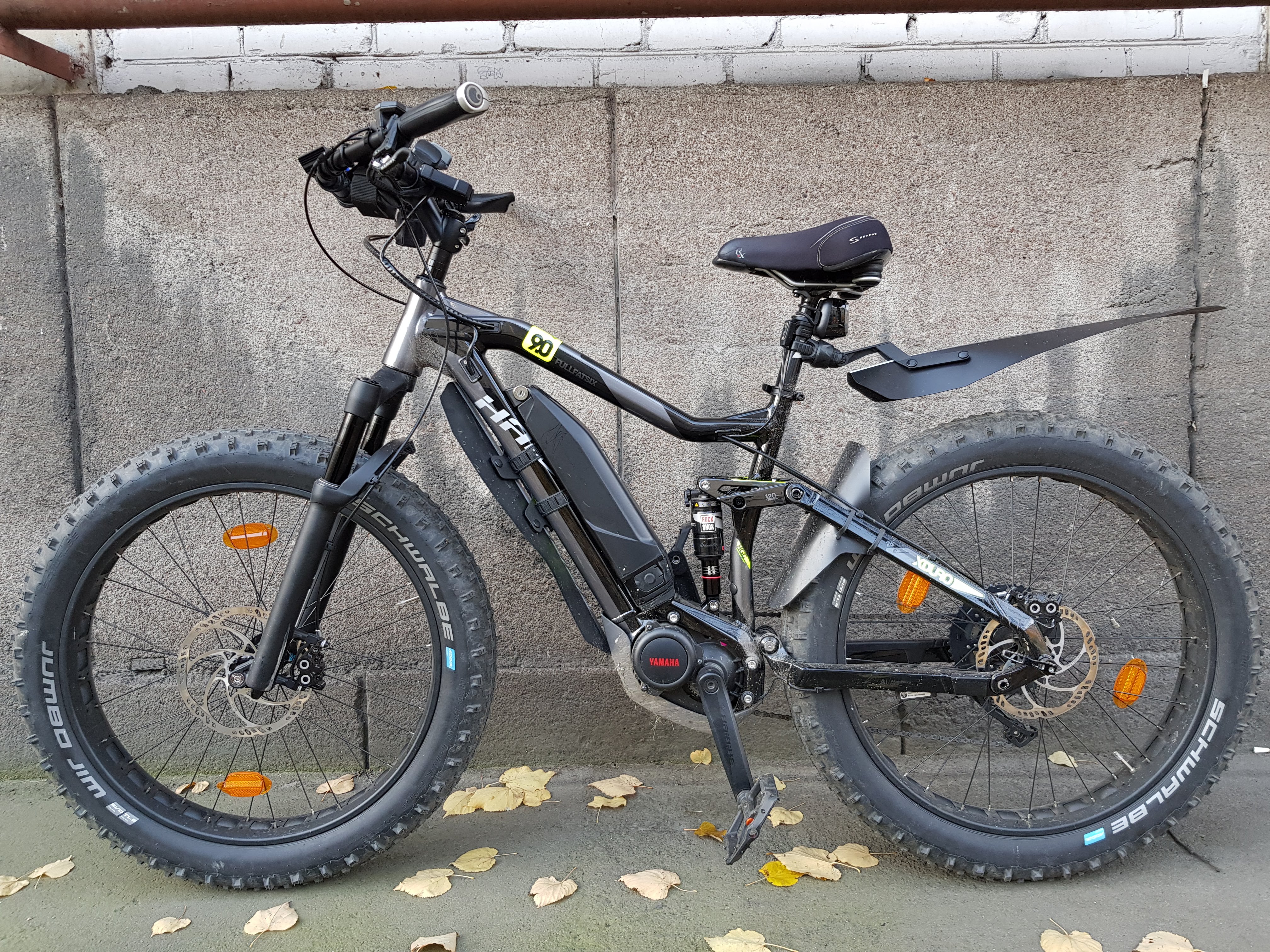

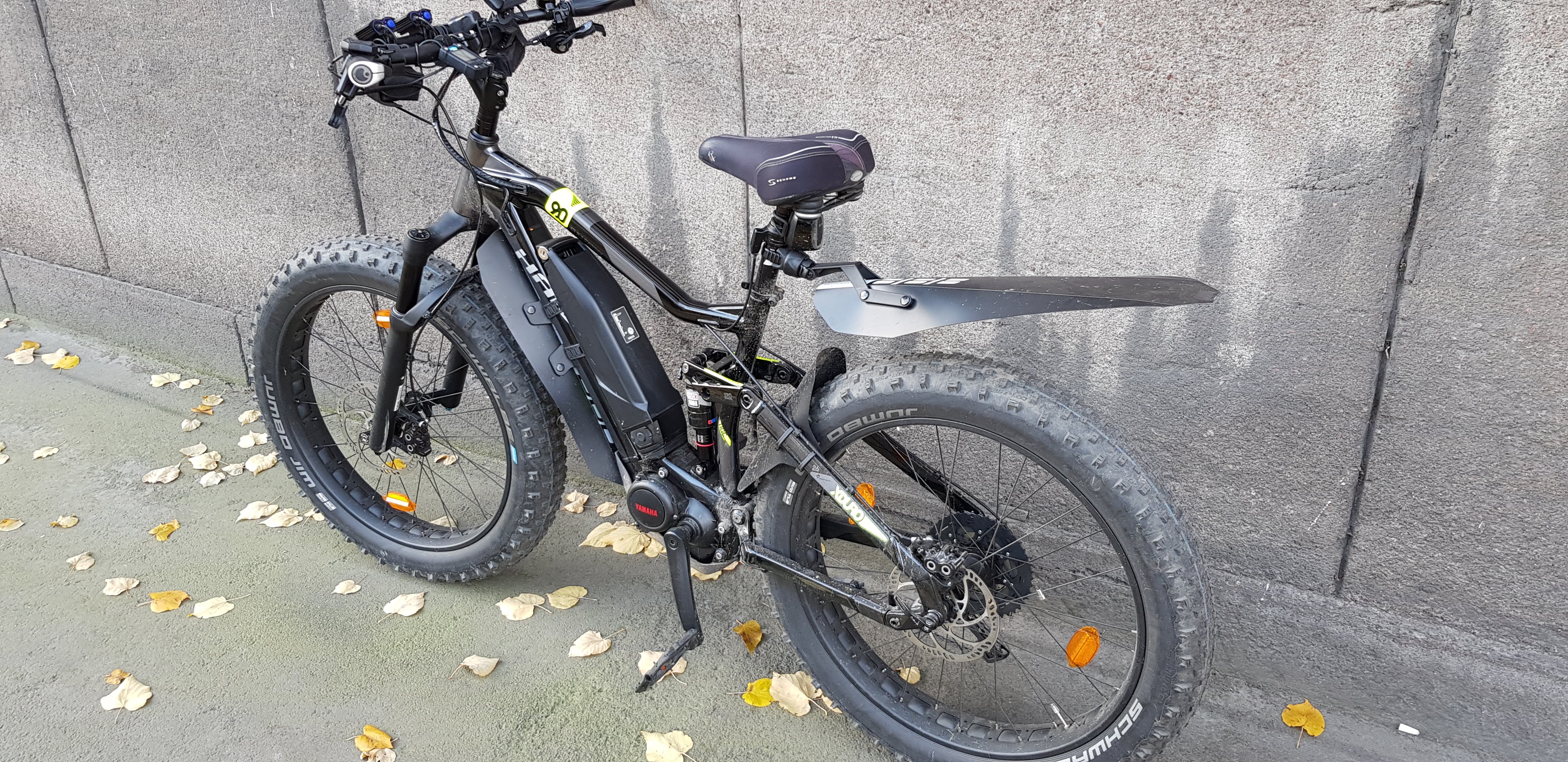

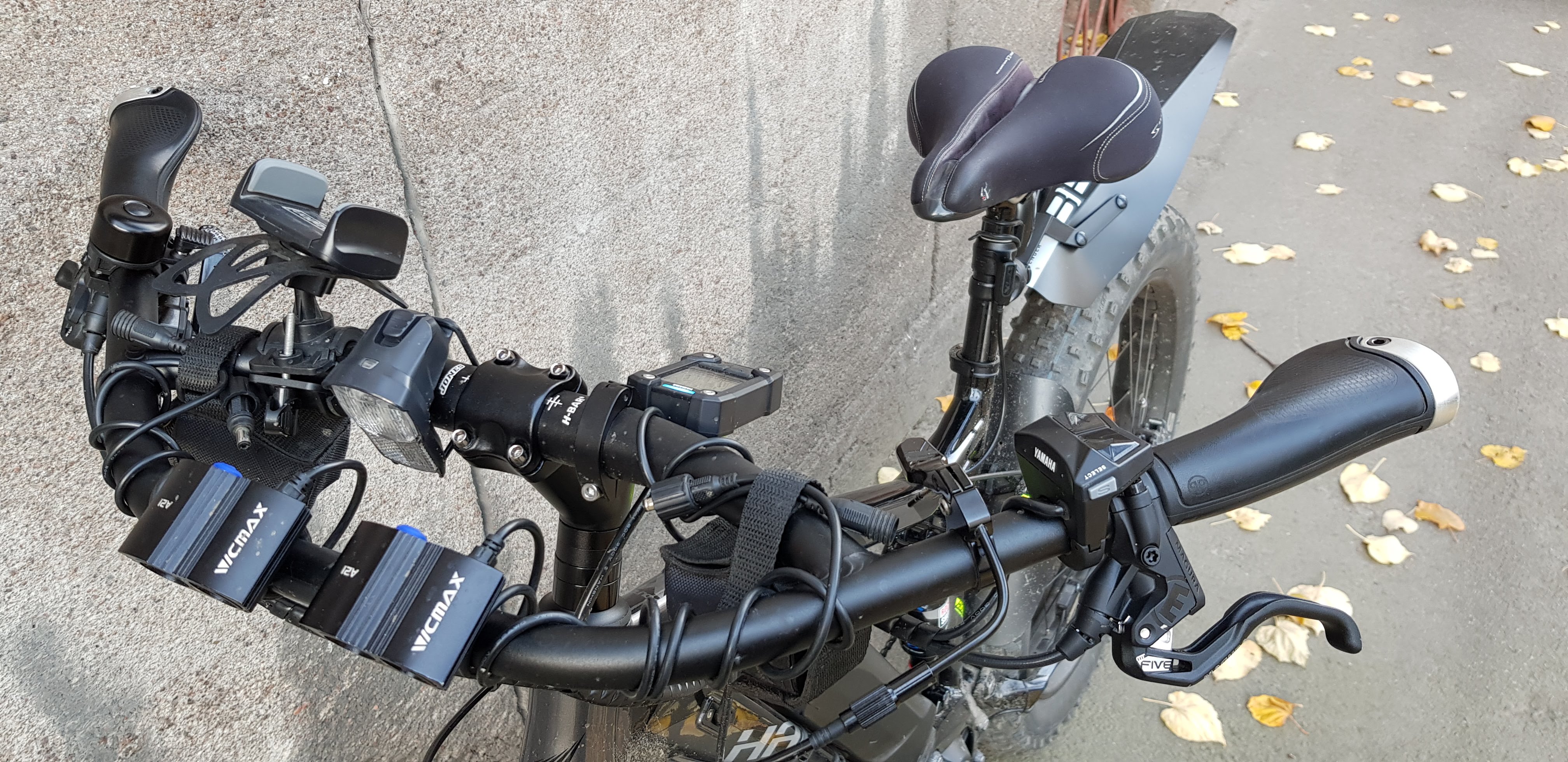

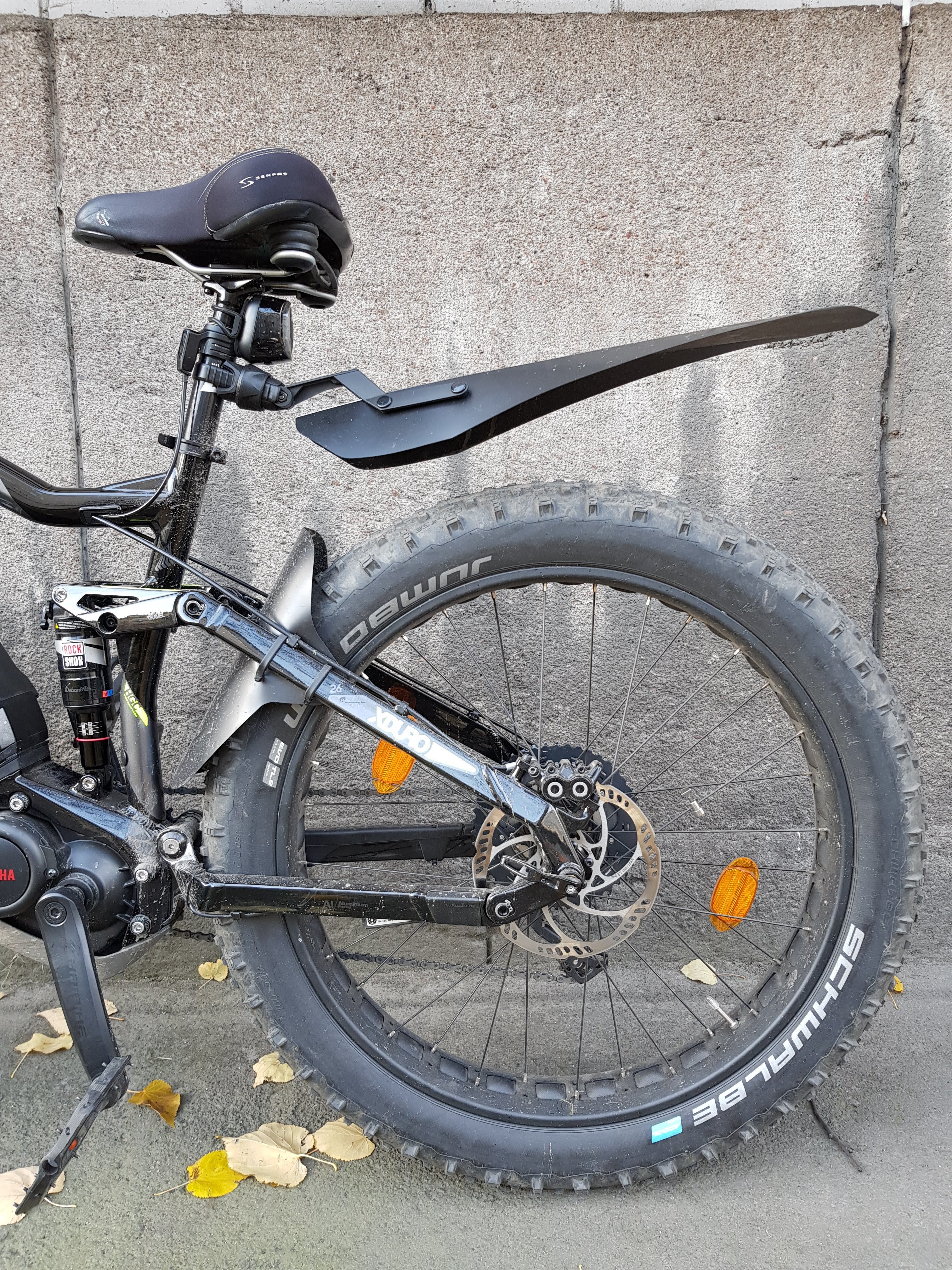

Just wanted to do an update for those of you interested how the bike handles in actual use after a few months:
  • The two smaller sprockets on the rear cassette got annihilated and had to be cannibalized from a different cassette.
  • The inwards-curving Ergon grips absolutely do not work on this type of handlebar, had to be replaced with more flat-looking ones.
  • I purchased a Jones-specific handlebar bag and it is super useful. I also built some battery packs to go into this bag.
  • Instead of purchasing a Supernova M99 and calling it a day, I decided to get a cheap 5-LED light of Aliexpress, replace the diode screens with TIR optics and use heavy, powerful battery packs with it (think 12× 18650 cells). This has its ups and downs, probably deserves a separate post since it's a big DIY effort.
  • Replaced rotors with Shimano Ice Tech. Yes, the Magura 200mm rotor is already warped, how did you know?!? Interesting fact — while undoing the front brake for maintenance, I managed to damage the bolts. This speaks to their quality.
  • The rear BBB fender got destroyed... twice. Don't buy them! The attachment part is so easy to break. I don't have a rear fender at the moment, the weather is dry for now.

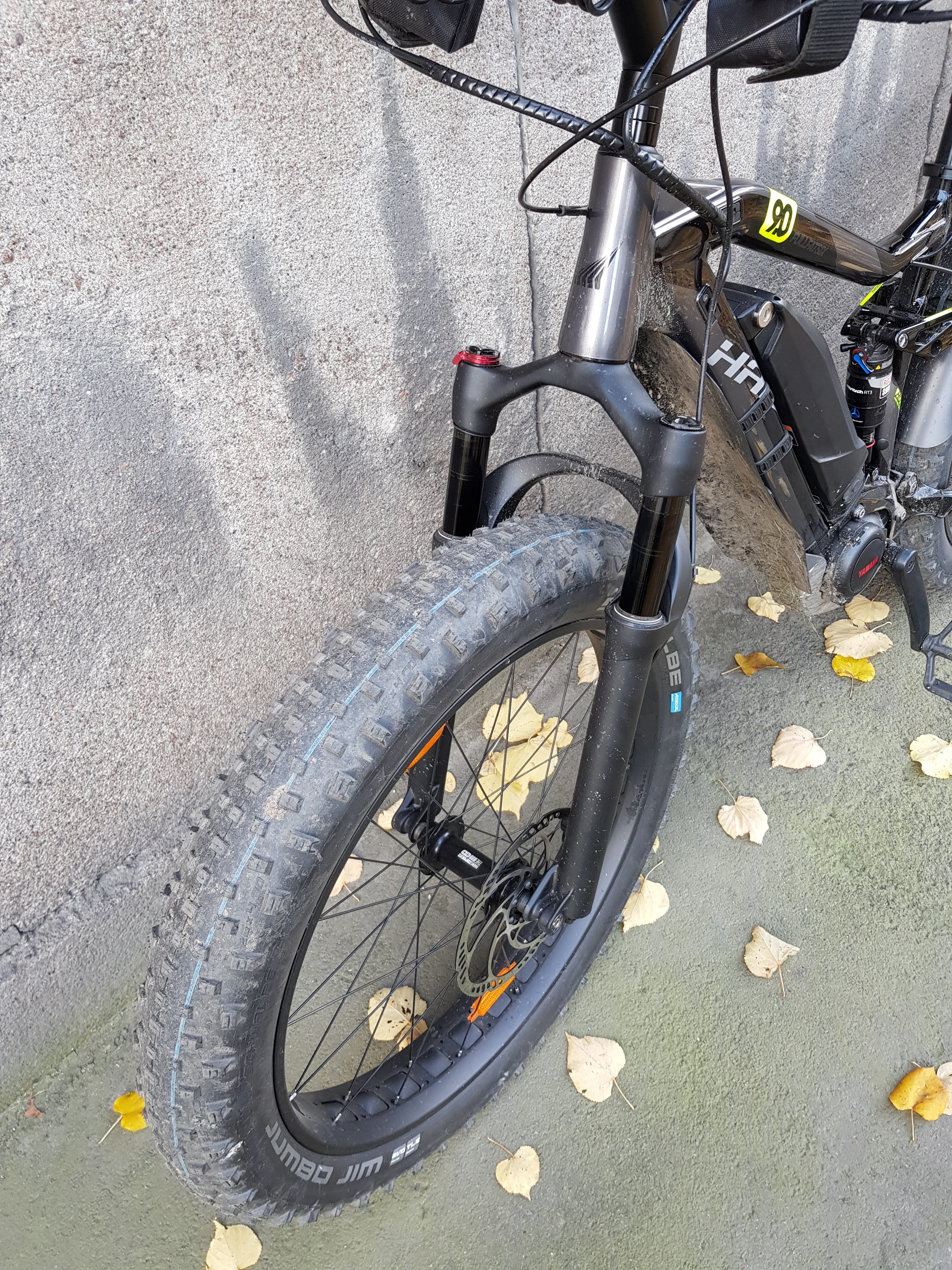

Here are some photos of the affected parts:

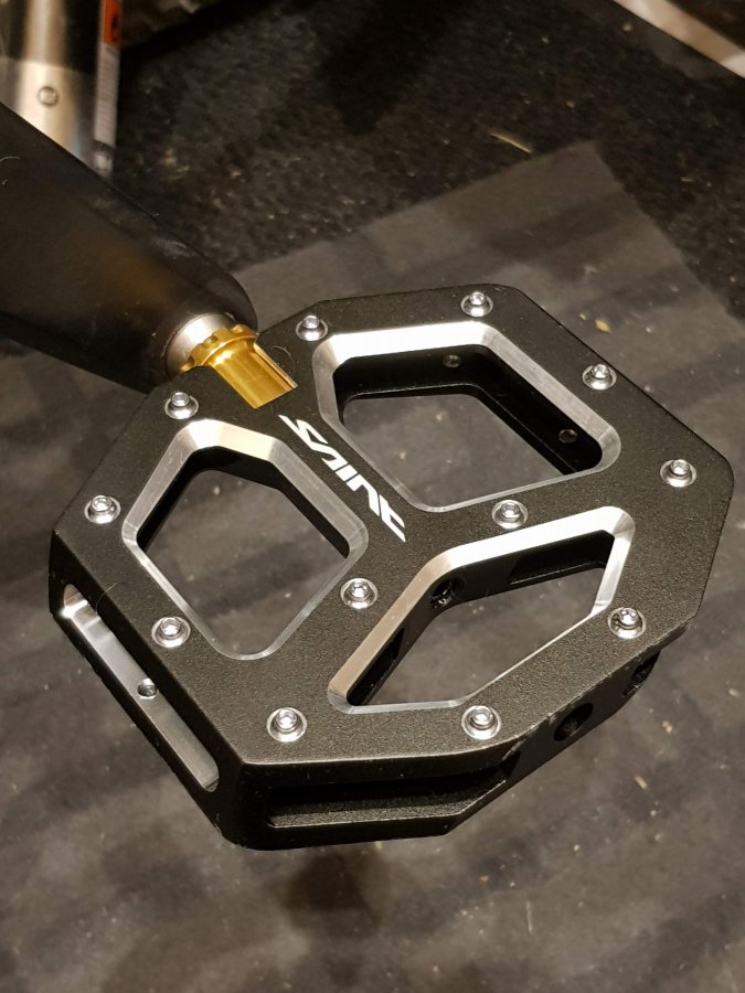

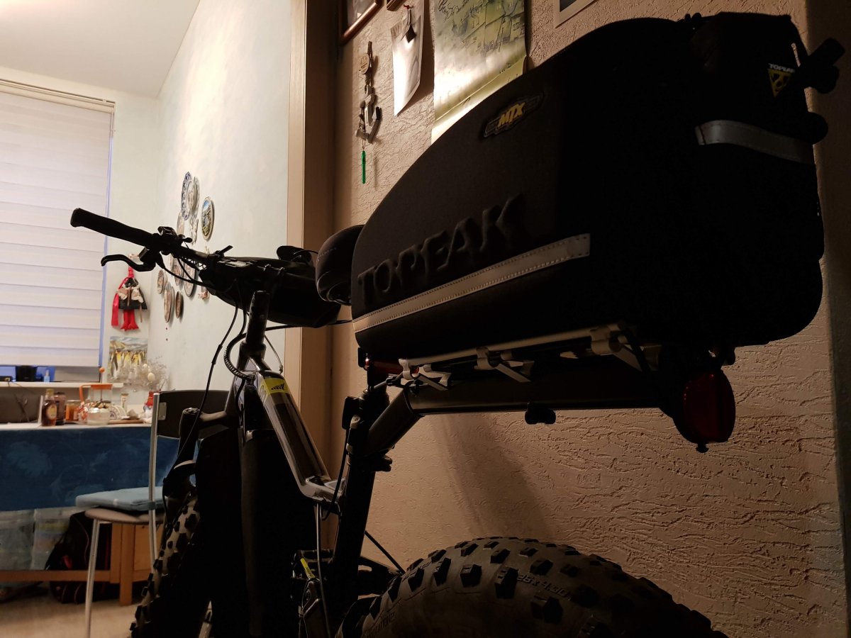

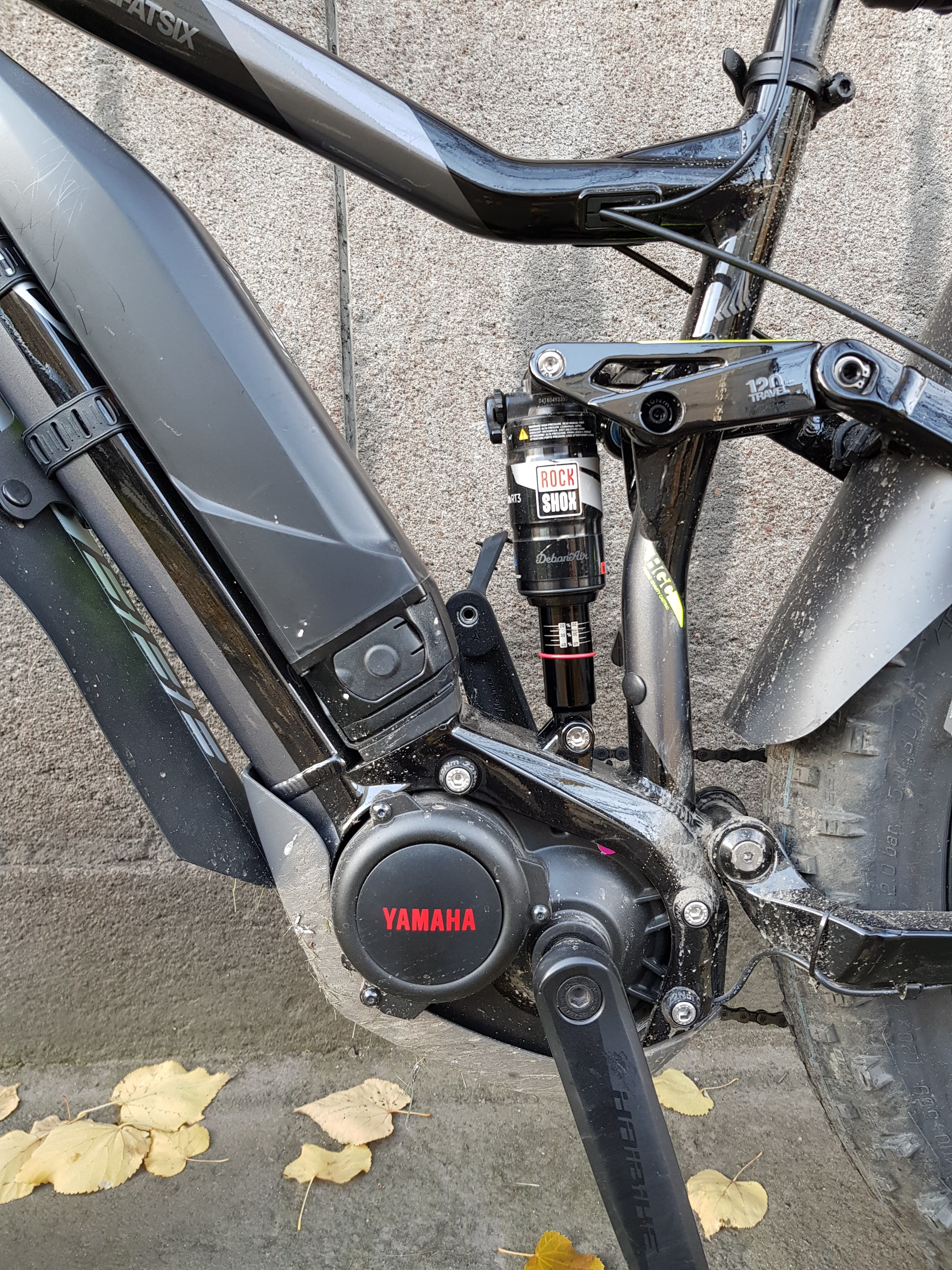

Okay, even more upgrades. It never ends, does it? Anyways, here goes:
  • Replaced the Kona Wah Wah pedals with Shimano Saint ones. Main motivation is to finally remove these huge plastic pedals with very long spikes (excellent for tearing shoes/jeans) with proper DH metal pedals.
  • Added a Topeak MTX rear rack and bag. Couldn't find any reasonable solutions for dual-sus so this is the best I can do. It's holding up so far but I've had to use a torque wrench to secure it, as fixing the quick release by hand is... not strong enough.
I'm going to be building a carbon dual-wall wheel with one of those huge (insanely huge) RaceFace Vault hubs, but that will come a little bit later.
Meanwhile, some photos:
View attachment 36068View attachment 36069
I use a lumbar pack, that might work for you.
