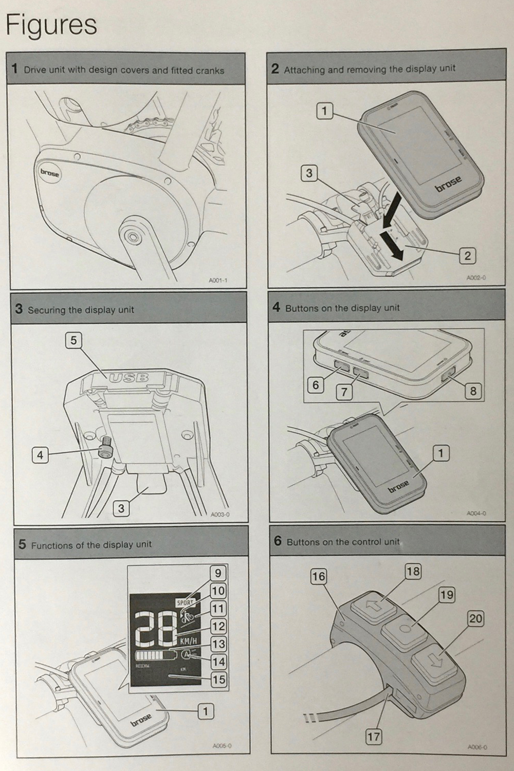

  • The buttons on the LCD include: Power, Lights, and Menu.
  • The buttons on the independent button pad include: Up, Menu, Down.
  • To reset trip distance, average speed, max speed, hold Menu and Lights on the display unit
  • To activate walk mode, arrow down to no assist (you may see a little triangle next to the speed readout), then hold the down arrow.

As mentioned in the video above, I have attached photographs of the official Brose instruction manual below (sorry about the limited quality, I took photos and then cropped them manually with a bit of contrast tweaks to be readable). The official Brose website seems to be short on information about this particular display and it seems like they may open design up to OEM manufacturers like Bulls, Specialized, and others to make custom displays. You can see this on the Specialized Turbo Vado (which has two display options, one is a touch screen) and the Turbo Levo (which just had three buttons and a Bluetooth smartphone app). This particular display panel is Brose branded and is their original layout (as far as I can tell).
