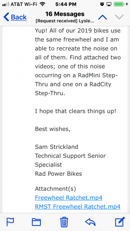

I have a 2019 Radcity with 200
Miles. What I notice is a “clunk” when starting to pedal after coasting. The factory response to my inquiry about this annoying noise is that this is common to all the 2019 Radpower bikes. They don’t offer any solution. I like everything else about this bike, but after owning several other Ebikes , I could not recommend Radpower.

Lysle
Velofix assembled the bike and did the first service as well. $200. The tech said he thought this normal.
The factory sent me a video of a Radcity and a Rad mini both making the same clunk and the Senior Customer Service person is the one who said they all make the noise.
AHicks
It would be interesting to hear/see the reaction of a 3rd person regarding this "clunk", to get an arms length opinion on the matter? Though the word "clunk" might be a bit subjective for all of us, it doesn't sound normal to me. I can assure you my City has no clunks, but in all honesty, my City isn't very stock either.
Could this noise be coming from the seat, possibly the handlebar area, or basically someplace not in the drive train, or do you actually feel it in your feet when you start to pedal?
Lysle
It’s definitely in the rear wheel because it can be duplicated with the wheel on the bench just by moving the sprocket back and forth. The noise is amplified by the large motor housing.

AHicks
Rad changed to a DNP 11:32 rear freewheel for '19 because the stock gear they used on the earlier bikes didn't allow an average person to peddle fast enough to even get to 20mph. A bunch of us made this move in '18. NOBODY complained about a "clunk" being part of normal operations. This move was so popular Rad put it into production for '19.
Since then, I've replaced my motor a 3rd time (another story) but to save time on that install, I installed another DNP 11:32 freewheel (just a couple of days ago). THAT freewheel operates clunk free as well.
Logic would tell us that if all the '19 RAD's operated with a "clunk", this would not be the first time I've heard or read anything about it.
My point is, there's an issue somewhere, or you're able to hear/feel something that nobody else is noticing.
I'd kinda like to see those attachments they sent if you could forward them?
