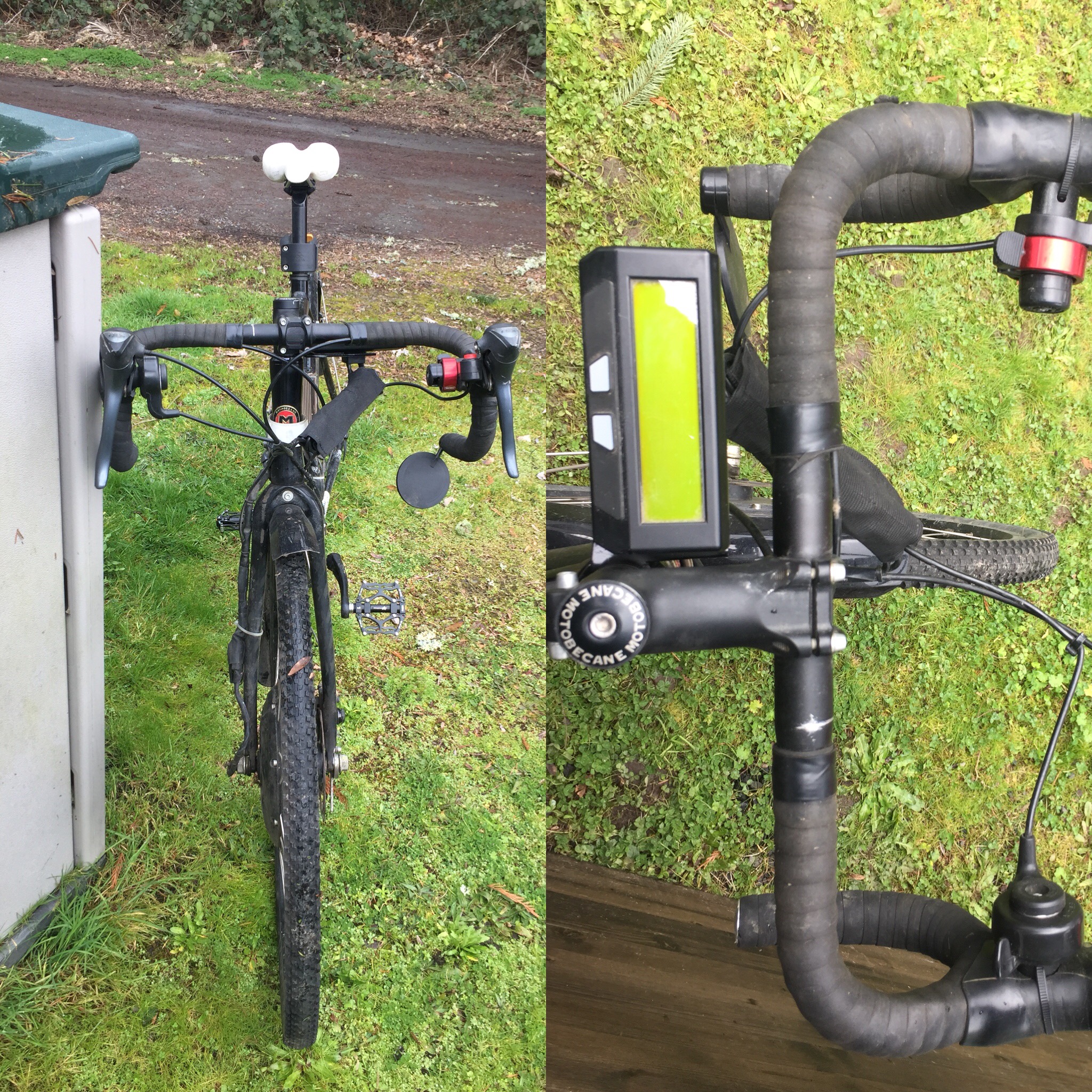

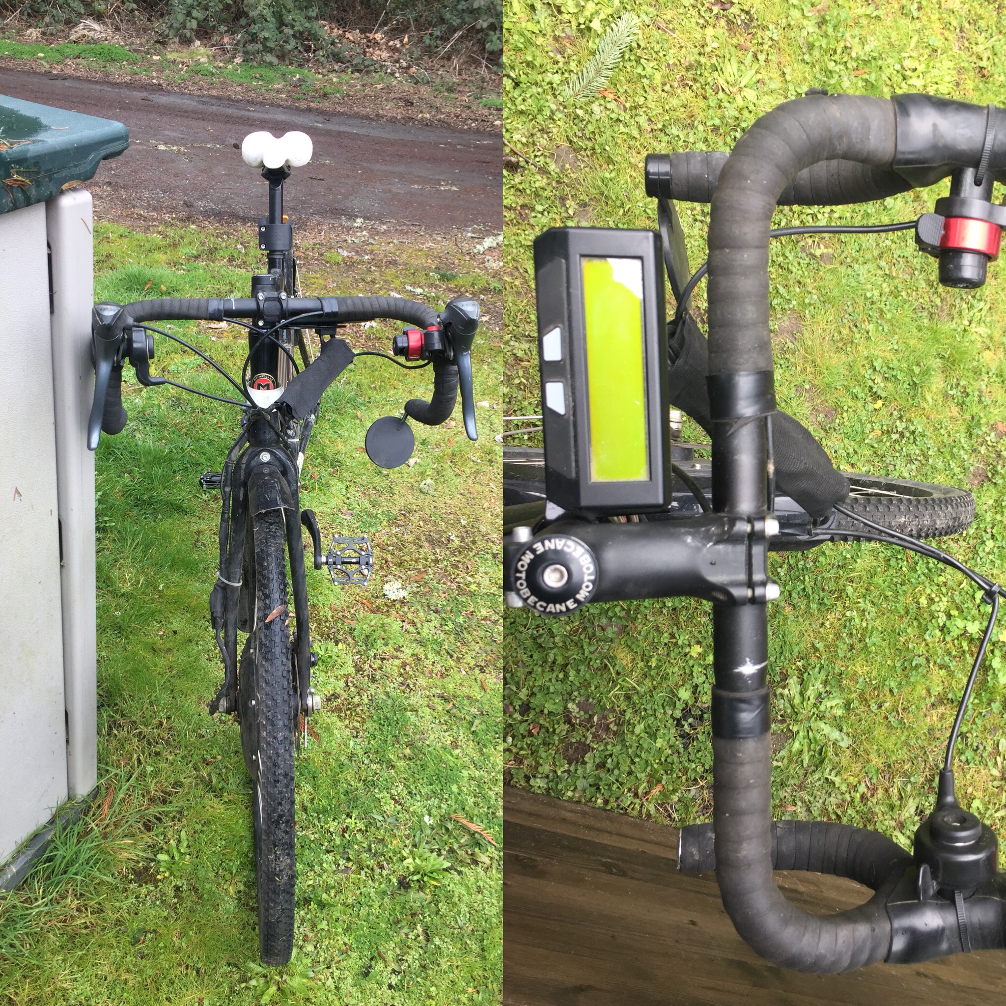

Hey @J Miller. I have to say that I am really glad I went with the CA. I really like the features, information and the controls it provides. I am running an old PC so when I tried to use the Windows interface my mouse goes all skippy and I really can’t use it at all. That aside, after working with the onboard buttons and such I was able to have good success and am really appreciating the functionality and accuracy of the device. I think that I was making myself crazy reading the unofficial official users guide for the device without actually having it working in front of me. I think it is better to just noodle around with it in reality and not read so much as someone had suggested to me .
AHicks
#12
I found the CA to be a bit more complex than I cared for and went the LCD3 route using a KT controller. This combo gives me all the features I was looking for, at a level of complexity I could deal with.
