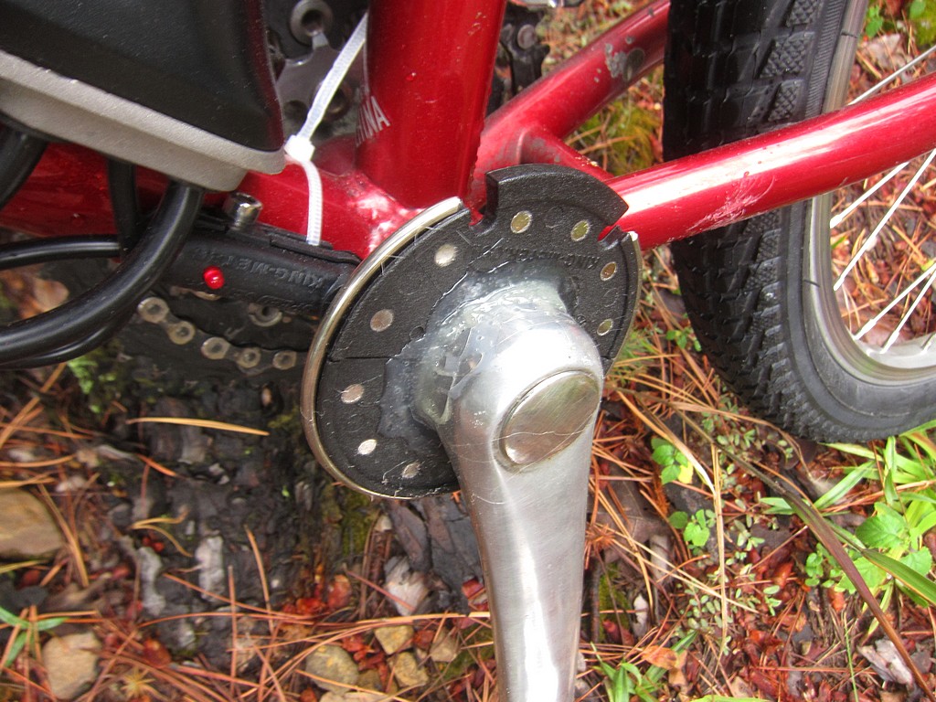

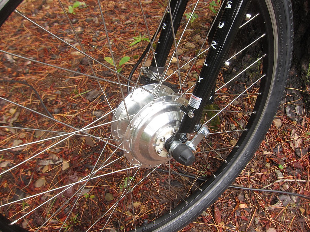

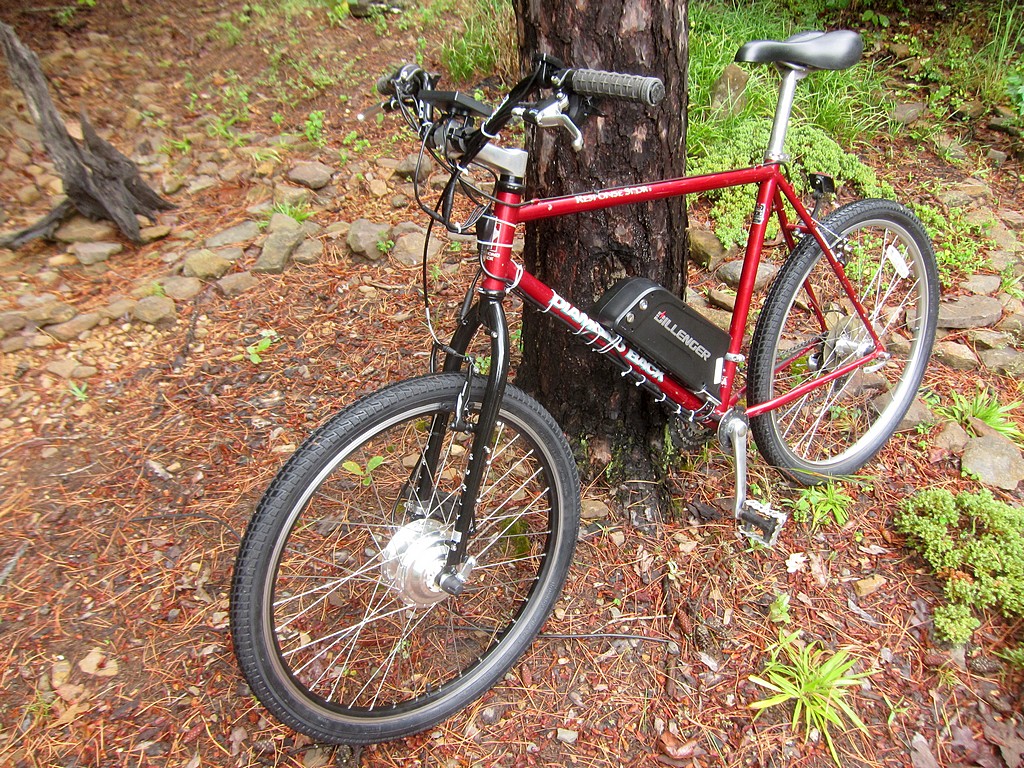

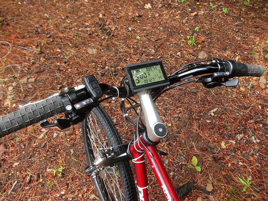

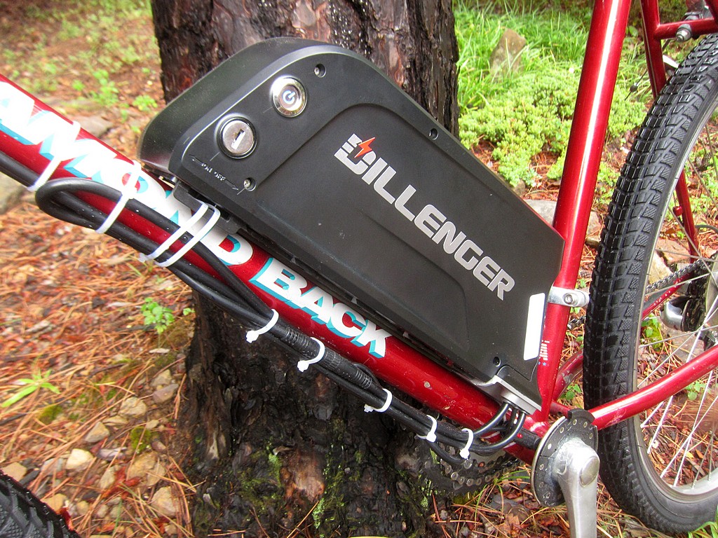

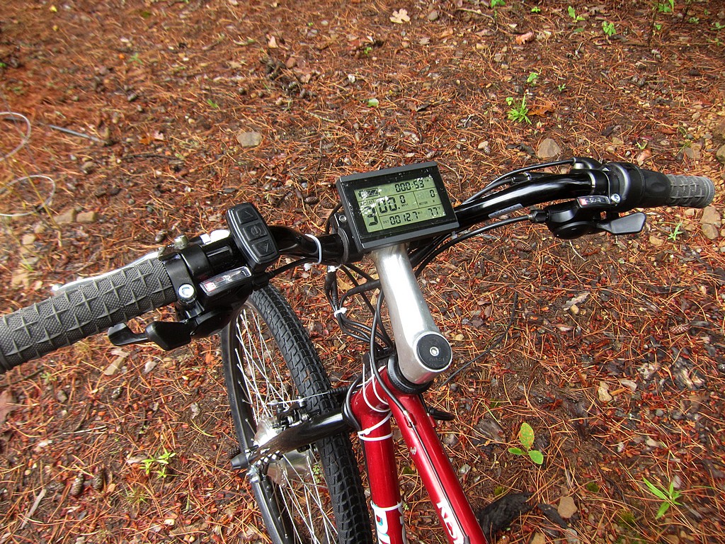

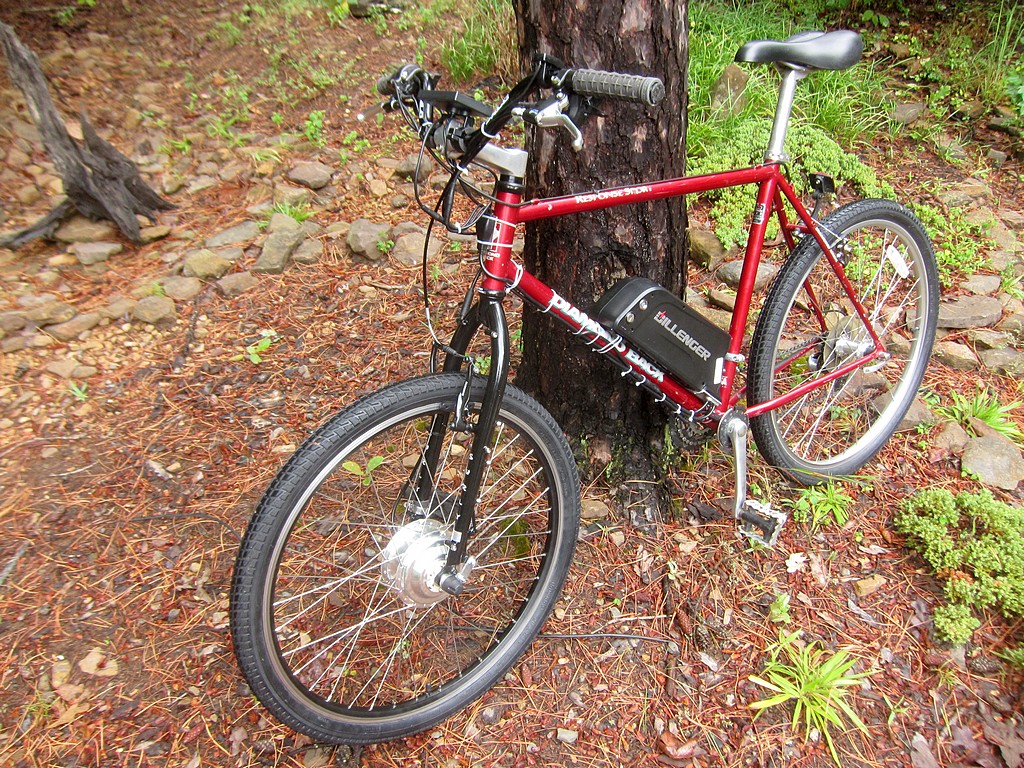

I completed my ebike conversion of a 30 year old Diamondback Response Sport mountain bike.
I went with the Dillenger 350w kit with the 26v 10ah battery kit after doing a review of available electric bike kits. I like the Dillenger kit because it had the frame mounted battery (No rear rack), plus it had 5 level pedal assist. I should have done a little more reading/research before installing the hub motor on the old bike. It had a RockShox aluminum fork and after about 15min of riding the fork failed (fortunately at a stop sign). I was naive and did not know that that was unsafe unless you have dual toque arms. Dillenger should really have a WARNING on the web site regarding the use of a front hub motor on an aluminum or allow fork and recommend torque arms if you want to do it.

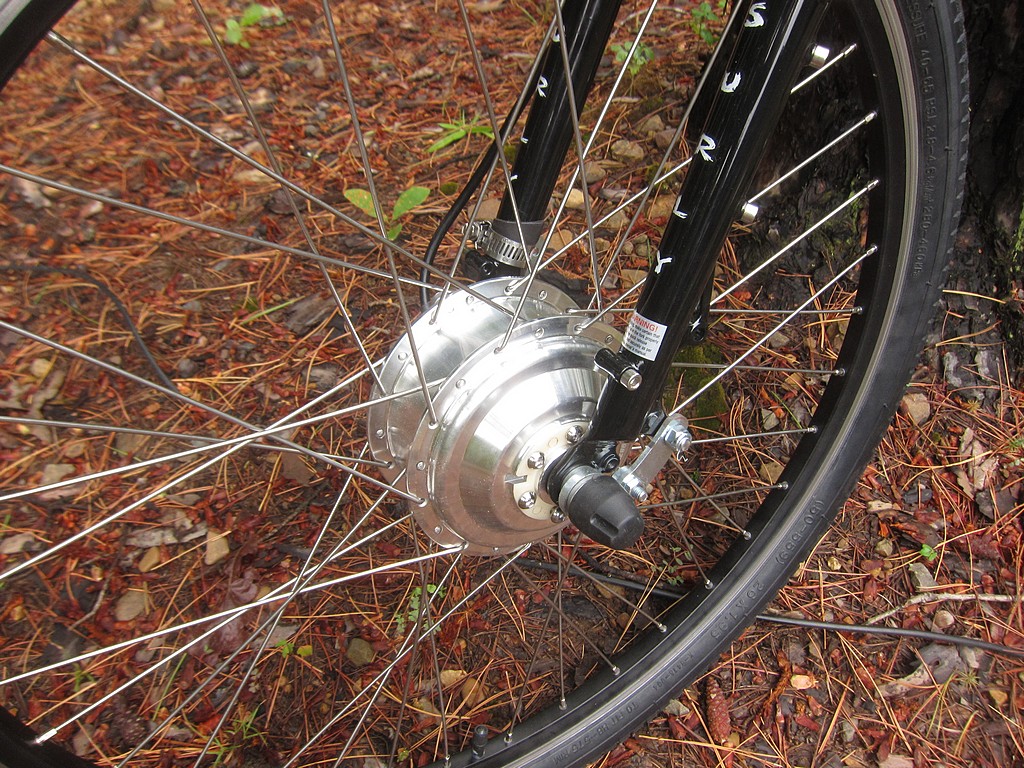

I ordered a Surly Troll steel fork and installed it along with two (2) torque arms (I know it's overkill but I don't have to think about a failure). Installing the Dillinger kit was fairly easy on this bike accept for the pedal assist ring. This bike had an aluminum pedal crank that was slightly larger than the the sensor ring. I solved the dilemma by filing down a flat spot/groove on the crank and removing all the "fins" on the
pedal assist ring. I also had to enlarge the diameter of the ring to fit over the crank groove. I then epoxied the ring to the crank and it lined up fine.
As part of the upgrade on this old bike I had to replace the old gear shift levers with new and installed a new Shimano Acera v-brake on the front fork. The Surly fork had about 1.8" longer dropout - crown distance compared to the old RockShox. I wanted the handlebars higher for a more comfortable ride
and replaced the old straight handlebars with a 4" rise set... all of which made the bike much better to ride.
I live in a hilly community in central Arkansas and the addition of electric power really makes bike riding more feasible now. I've gone on a couple 10-15 mile rides and the 350w motor + peddling gets me up, down and around with not much effort. Assist Level 3-4 will get me going as fast as I can peddle and seldom need more than 3-4 gears.
All in all I am very pleased with the Dillenger kit and have would recommend it to others.
The only exception being that they really do need a warning about using the front hub motors on aluminum or alloy forks without torque arms OR recommend installing on steel forks only.
myEbike4.jpg MyEbike7.jpg MyEbike6.jpg MyEbike1.jpg MyEbike3.jpg MyEbike1.jpg MyEbike3.jpg
View attachment 4364 View attachment 4363 View attachment 4362 View attachment 4360 View attachment 4361 View attachment 4360 View attachment 4361

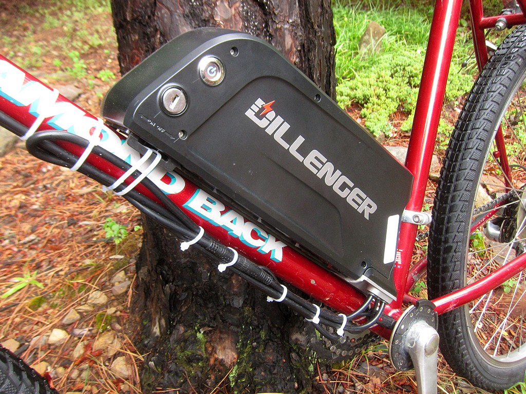

I have since put 55 mile on my kit with a Buddy Rider attached and my 11lb dog in seat, what a blast for both of us. With this kit I can climb a 7% grade with no problems and very little to moderate effort using peddle assist level 3, I 'm not going fast but it is truly no sweat climbing the hill. I can easily sustain 20mph on the flats using level 4 and I was capable of short spurt runs of 31mph with my moderately hard bike effort, but ran out of gear and was spinning. The miles I got on my first charge with one bar left on the indicator was 27 miles, not bad for a hilly area and my 11lb dog along for the ride, I think I could have gone another 5 miles easily.
One important thing to note is watch your spokes they will come loose and you need to re-tension them, mine were very loose after the first 10 miles and required tightening and minor truing. Also, watch for nuts and bolts becoming loose as well, the battery cradle has a few small screws and nuts holding together the metal base and plastic controller body, you will see what I'm taking about when you remove the battery from the cradle. Use lock-tite on your mounting screws those become loose too.
Overall this is a great affordable kit, well thought out with the controller integrated into the cradle/battery and a powerful enough system to handle the hills when called upon and just a no clutter system. I only use the PAS, I purchased the thumb throttle but I never use it, the PAS is awesome and BTW I did have the same issue as you did with the PAS but just drilled some holes in it and tie wrapped it to the crank arm. I never thought I'd own an E-bike as I am an avid road bike rider with two carbon Cervelo's one being a time trial bike. I just bought this kit on a whim to get more miles of riding with my dog after work and weekends and can now ride in the 100 temp days without overheating. But of course SAFTY first, will my forks fail too, I need to ride careful in the meantime would hate to crash with my dog onboard.
For those of you on the fence on a E-bike kit, this is a good one, practical and easier on the wallet. Good Luck to you all and Fun Riding!

My Response Sport had Rockshox aluminum forks. I installed the front hub motor and did an easy ride of about 10 miles.
This was all on smooth pavement. As I rolled up to a stop sign I was barely rolling and applied the front brake.
The bike fell forward and when I looked down I saw the back side of the dropout had snapped off. More than
likely, it had cracked during the last part of the ride and the small bit of force from the application of the brake broke it off.
I am VERY fortunate... I had been going as fast as 27 miles per hour just a few minute prior. If the fork would have snapped
at any other speed, rather than just barely rolling I would be in the hospital for sure with a smashed face, broken bones or worse.
After this happened, I contacted Dillinger support and they claimed they had never seen a failure with a 350w hub motor.
I then did some google searching for "broken suspension fork and front hub motor" and found several photos and links.
I went to endless-sphere.com and found many threads of others with broken front forks. They all said never put a front hub motor
on an aluminum or magnesium dropouts with out two (2) torque arms installed.
I needed to order a new fork and after much research I could not find a single suspension fork that didn't have magnesium lower dropouts.
Magnesium is weaker than aluminum. I looked on other ebike kit web sites and on several they had disclaimers that said do not install on anything
but steel forks.
I did not want to worry about magnesium forks so I bought a steel fork AND a couple torque arms.
Now I can ride with peace of mind and will still check the steel forks for fatigue cracks from time to time.

I've ridden about 75 miles now over the last week since finishing my build and have some further thoughts/info about the Dillinger kit.
I am quite impressed with the performance of the 350w front hub motor. So far I've been riding in assist level 3 or 4 but on occasion I've
clicked it up to level 5 to get up some steeper grades. I've posted a couple graphs of a 12 mile ride. You can see from the elevation plot that
I am riding on some fairly hilly up/down streets. At level 5, the digital readout indicates the motor in putting out a little over 500 watts when
working hard. On level 4 it shows and output of 300 watts. Regarding top speed, on a flat, I have a hard time getting faster that 28 mph.
I can't peddle faster than the motor is helping. (I have a 21 speed bike).
Below is the elevation profile of a 12 mile ride. Total climbing on this ride was 2307. Average speed over that distance/terrain was 14.4 mph. Max speed according to GPS was 37mph
Below is the speed graph over the same route.
Below is the route shown on a topo map.
After this ride which took a total of 48 minutes the battery voltage was showing two bars under load and three bars on cruising.
Most of the riding was in top gear 3 - 7, drop to 3-6 or 3-5 as needed. On the steepest grade I had to drop to 2-2 and assist level 5.
If I would have tried this same ride without an hub motor I would have had to really work hard and would have had to use "Granny gear" or
even walk the bike to make a couple hills. With the 350w hub motor I was able to do the entire route and get home without breaking a sweat.
I saw one biker on the same route really pumping hard. I thought about flagging him down and tell him about the virtues of an e-bike.
Maybe another day :)
