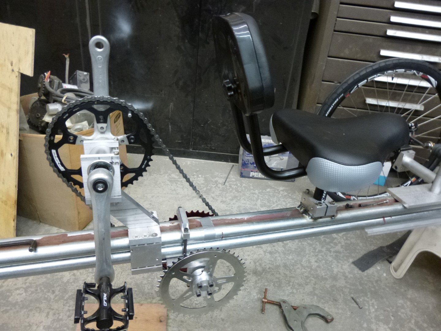

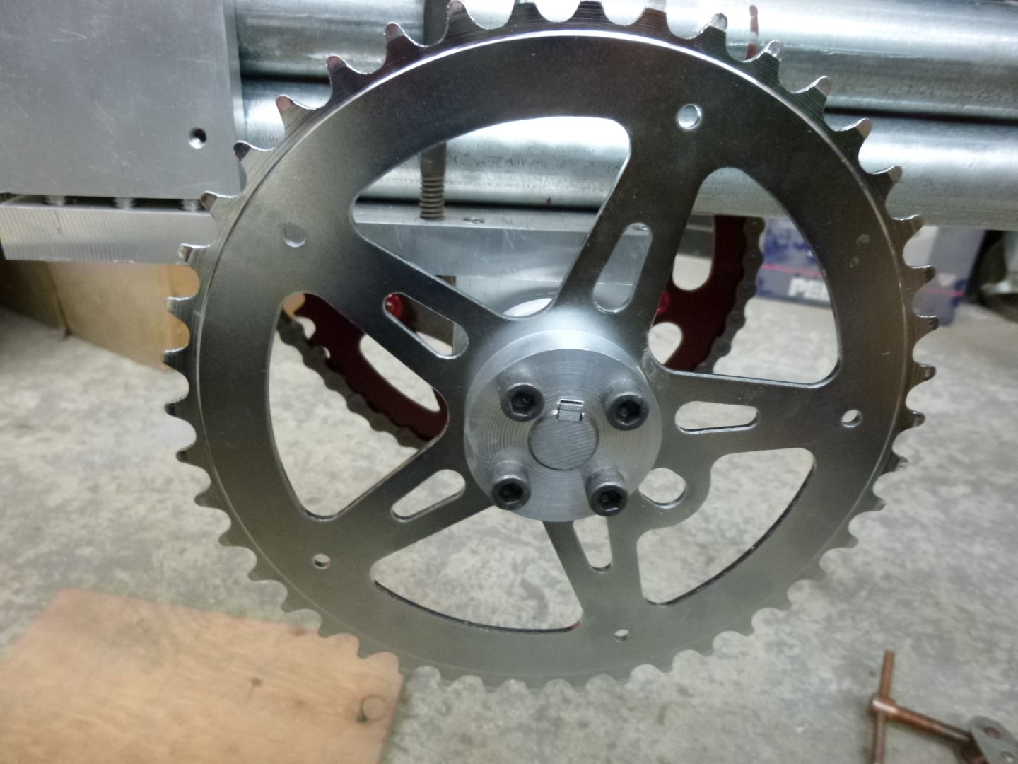

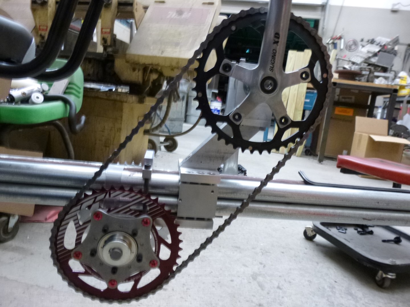

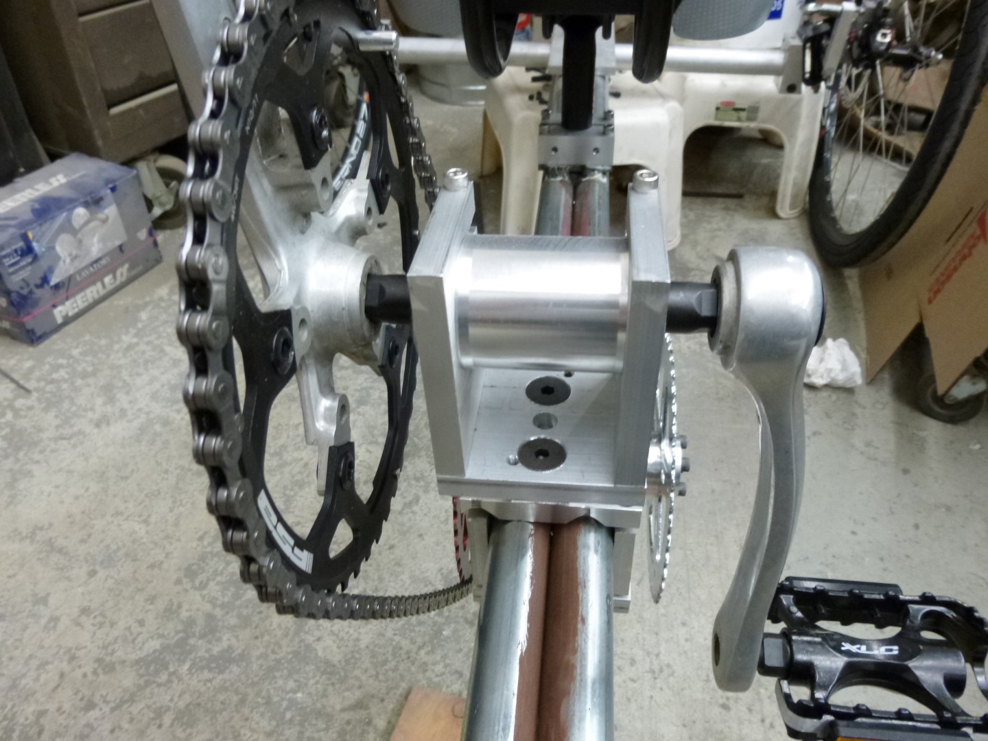

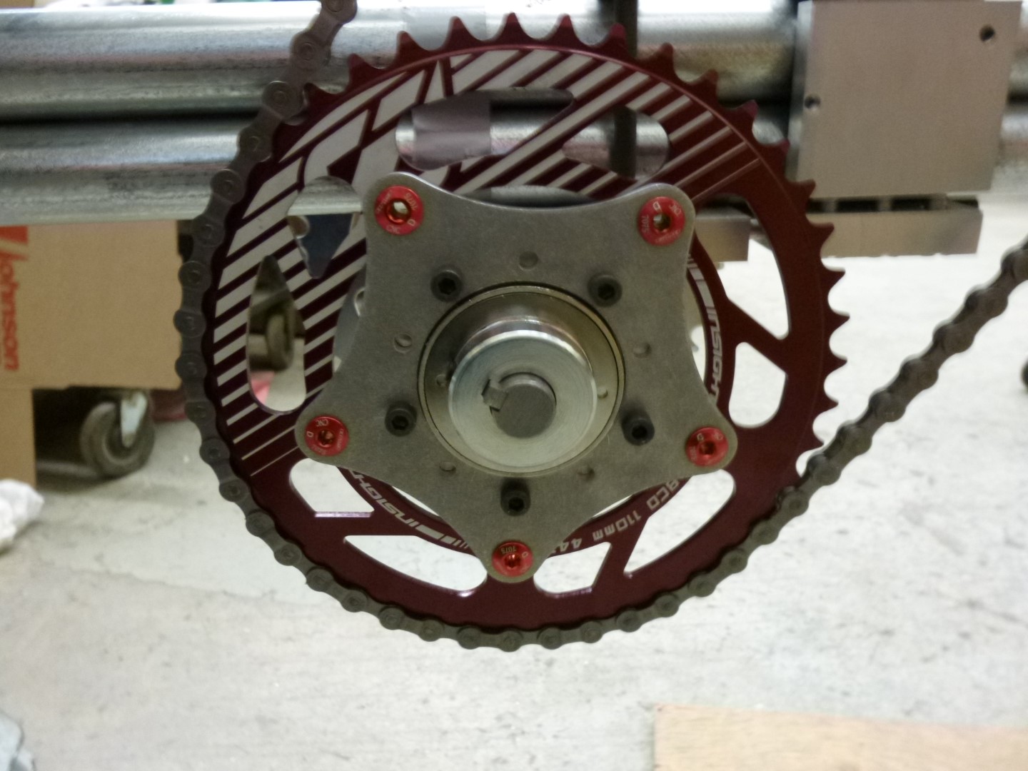

#6
I finished the Stoker's crank-set and mount which allowed me to locate the Captain's seat. As you can see from the pictures it's a very simple efficient design. The transfer gear (red) is mounted to a freewheel so the Stoker can pedal independent of the Captain and vice-versa. Now that I Have the Captain's seat mounted I can locate the Bafang Mid-drive and mount it.
View attachment 11327 View attachment 11330 View attachment 11333 View attachment 11336 View attachment 11339
Nice! I don't know enough to dream about doing that.
You said something about a problem with a battery pack? Seems like there are BMS issues out there. Hope you got it resolved. Given the shipping problems, not what I want to hear.
Hope you get this bike done for the that great New England Winter riding season. :D
Really, it's beautiful!
