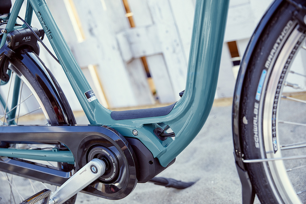

Monday, October 2, 2017 — SANTA CRUZ, CA - Gazelle - www.gazellebikes.com - Introduces the Gazelle Avenue, a secure and stable eBike equipped with Shimano STEPS intelligent drivetrain that is perfect for the urban commuter. The Avenue is ideal for everyday activities whether picking up dinner or commuting to work, the capable Avenue is the best choice for a reliable, safe and swift ride.
gazelle-avenue-electric-bicycle-stock-1.jpg gazelle-avenue-electric-bicycle-stock-2.jpg

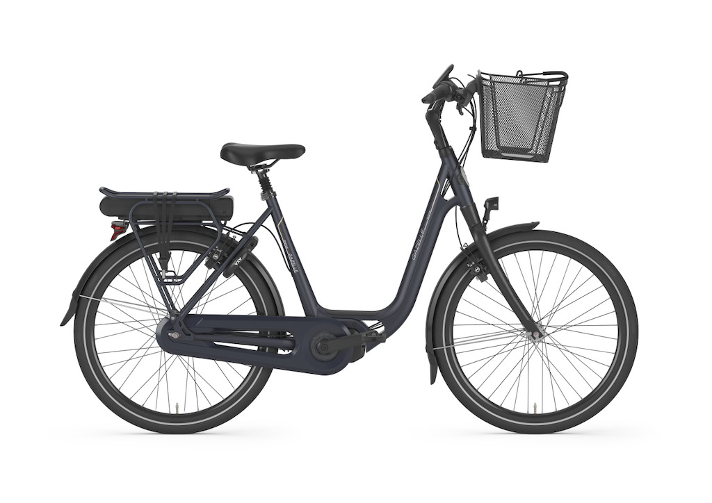

The Avenue features a lightweight aluminum frame that is balanced to perfection with a low-step design, single tube, and integrated cables. The geometry is based around 26” wheels and optimized for comfort with a 68-degree headtube angle and 70-degree seat tube angle that creates a relaxed and stable ride. The 250 watt Shimano STEPS has an average range of 50 miles and a max distance that can approach almost 80 miles. Magura brakes provide dependable, controlled safety with swift and smooth braking. Combining design and performance, the Avenue never disappoints. Enjoy the ride!

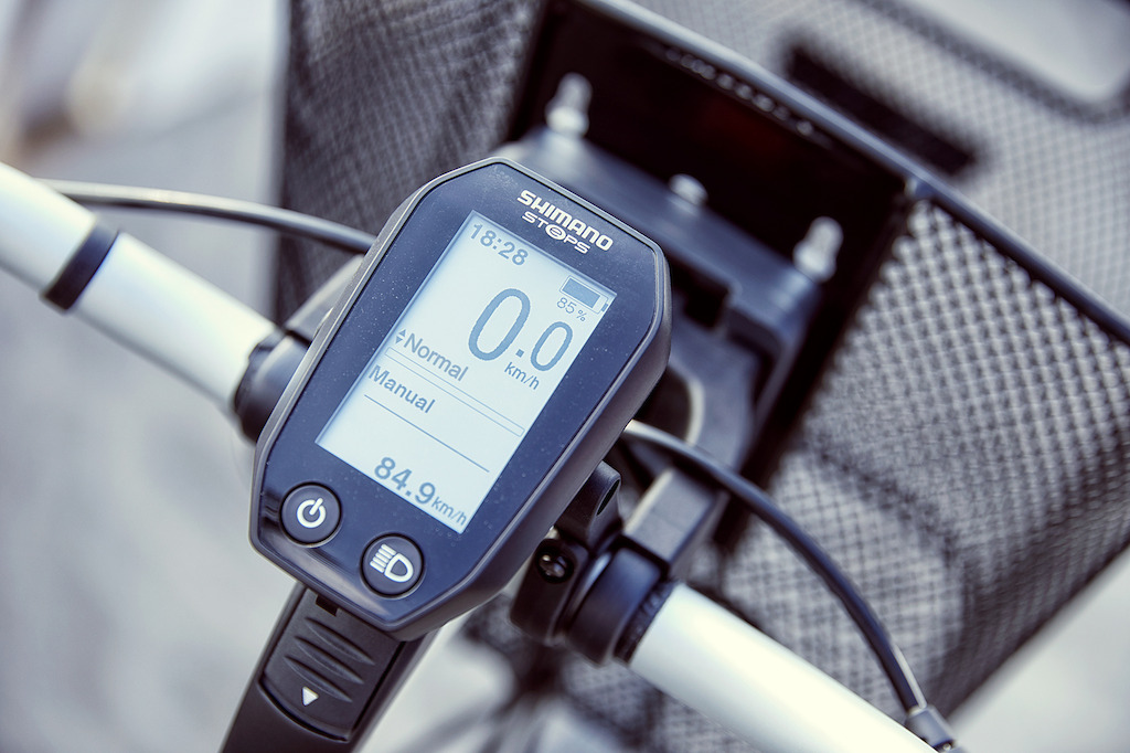

  • Shimano STEPS

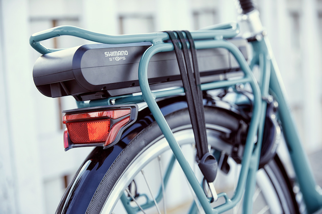

  • 36V / 504 watt battery

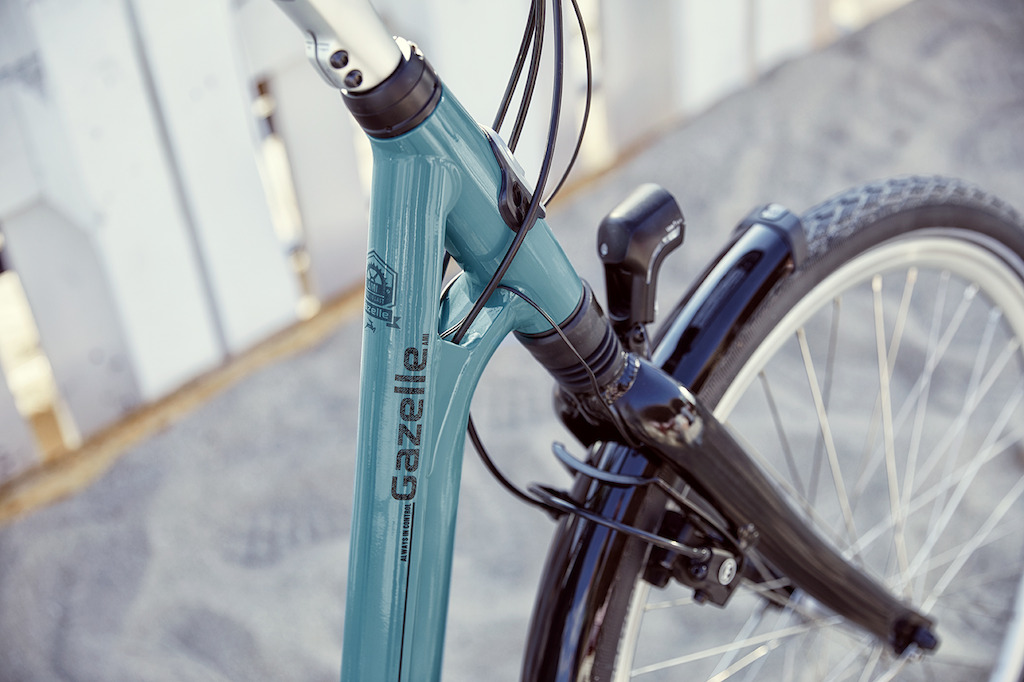

gazelle-avenue-electric-bike-shimano-steps-mid-motor.jpg gazelle-avenue-electric-bike-suspension-fork.jpg gazelle-avenue-electric-bike-battery-pack.jpg gazelle-avenue-electric-bike-shimano-steps-removable-display-panel.jpg gazelle-avenue-electric-bike-frame.jpg gazelle-avenue-electric-bicycle.jpg

Hi DJGuy, the Arroyo is a great ebike, I really enjoyed taking it for a test ride last year. Some time later this year I'm going to get to try out a Gazelle EasyFlow for a month and I'm looking forward to testing the Steps system. In preparation I took the time to compare the specs of the Arroyo and EasyFlow models and these appear to be the main differences:
  • Wheels: 26″ EasyFlow vs 28″ Arroyo.
  • Stand over height: 15.5″ EasyFlow vs 16.5″ Arroyo.
  • Weight: 52.5lb EasyFlow vs 58.7lb Arroyo.
  • Motor torque: 50nm (Steps E6000) EasyFlow vs 63nm (Bosch Performance Line) Arroyo.
  • Front light: B&M Upp-T 30 lux EasyFlow vs B&M IQ-TEC 60 lux Arroyo.
From the specs I'd say the EasyFlow is the better choice for shorter riders and for those who don't need the extra torque of the Arroyo's Bosch Performance Line motor. The Shimano Nexus 8-speed internal geared hub shifter they share in common means both models perform well in urban stop and go traffic. It is this advantage of being able to shift down when stationary, 307% wide range, and reported strength of the Nexus-8's 5th gear, that encouraged me to convert the gearing on my ebike from a 7-speed derailleur to the same Nexus 8 IGH as the Arroyo and EasyFlow, so I'm looking forward to seeing how it works with the Shimano Steps system compared with my Bafang BBS01 kit motor.
