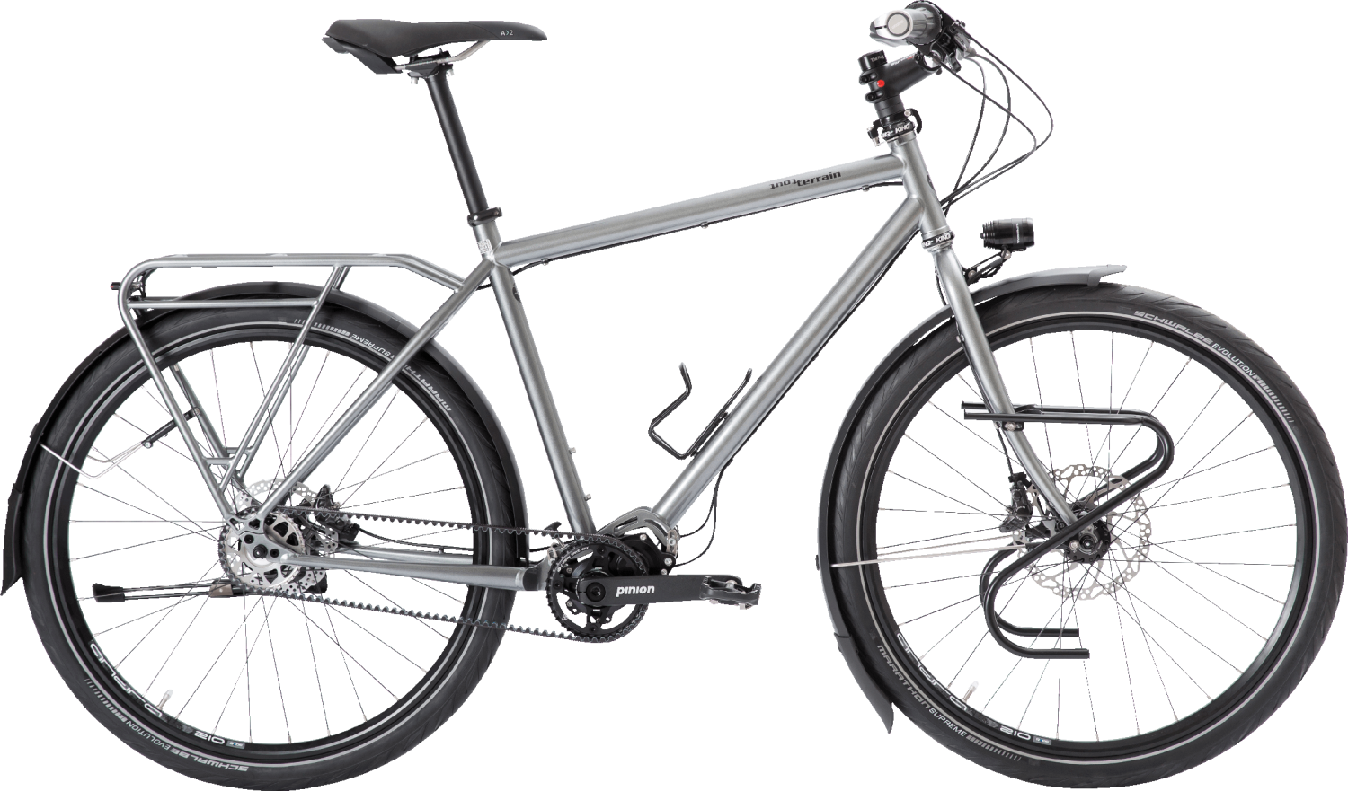

Thanks, I looked up the front rack but didn't see any place where I can purchase this in the US. I have another hardtail that I plan to convert for long distance riding and would be interested in installing it on that bike.
BBassett
The manufacturer only sells in Europe. If you go online there are companies that you can purchase from manufacturers like them and have items shipped directly to you.

Beautiful design... what is the price range?
It's not the price so much as the terrible customer service that is the problem. Quality costs and you expect to pay for it. You also expect the manufacturer to back their products 100% and Tout Terrain doesn't do that outside the Home Land very well... or at all. I bought their Panamericana (horrible time-consuming experience) full suspension Expedition tour bike and mounted a real mid-drive. Expensive, reasonably well made, innovative and one of kind features make it a one of kind ride, The silk road series are more suited to the decerning daily commuters.
