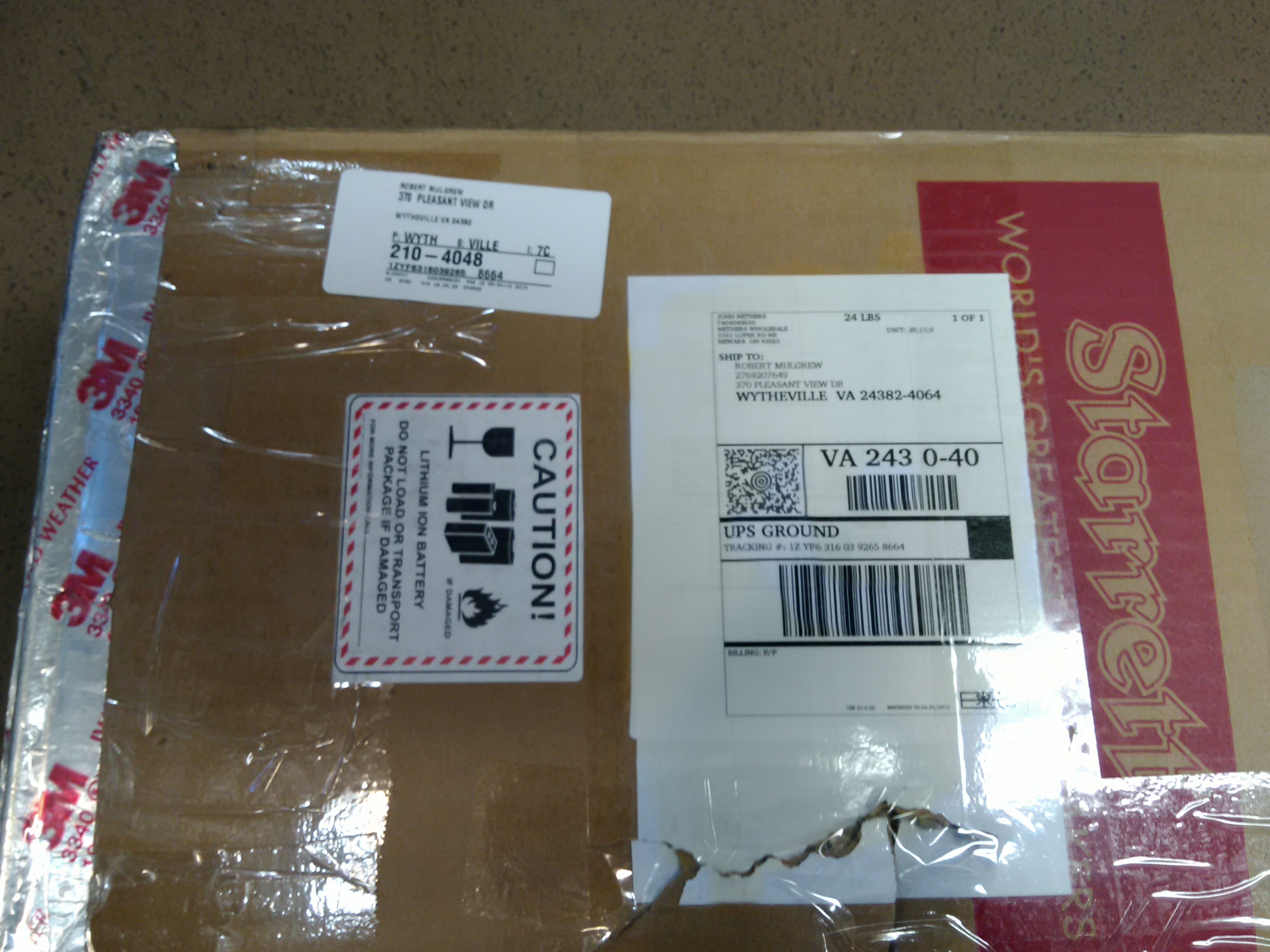

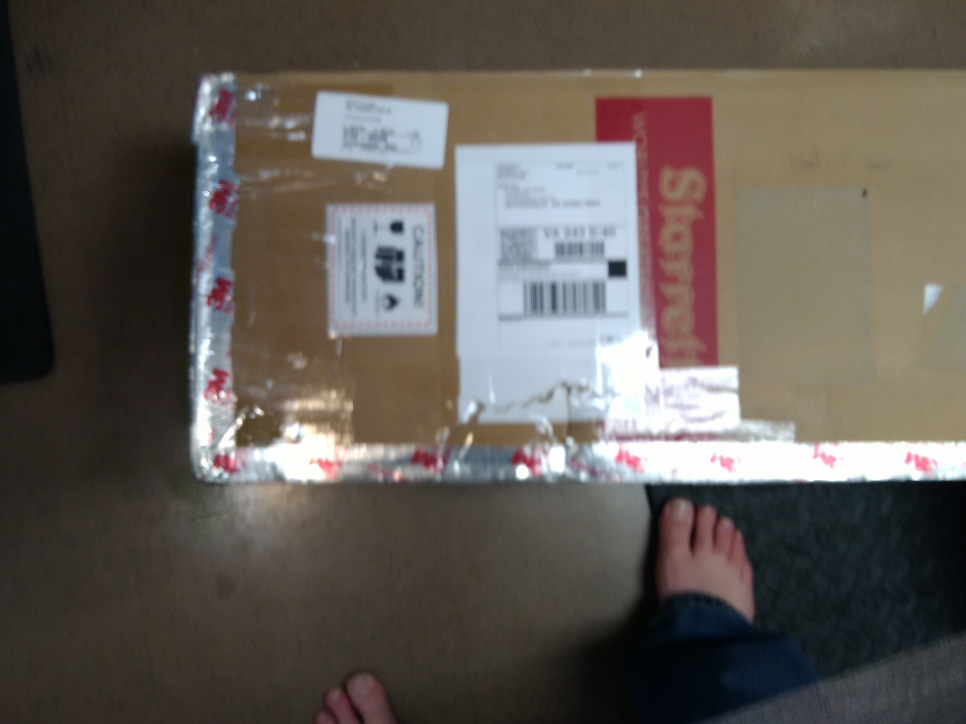

I recently mailed my 36v, 20ah, lithium battery from Wytheville VA to Ohio.
1)Needs to be "ground" shipment.
2) Local UPS store verified content, listed as "ebike lithium ion battery" on form and put a sticker on in signifying the Lithium battery and don't ship if container crushed.
(Box and battery weighed 23.3 lbs total)
No problems getting shipped back from vendor either. My battery rebuilder recommended UPS or FedEx ground.
Used UPS because of local shipping store.
Hope this helps.
FYI- battery rebuilt from 20ah to 35ah upgrade 😁
Any questions please ask.
Hope this helps.
RJM

Greetings Bob.
-I paid $20 for 23.3 lbs from Southwestern Virginia to Ohio(about 400 miles). Included label. Verify Lithium Ion battery and no issues. Ship GROUND! I used local UPS store.
- Packing. Most rebuilder's will WANT you to pack your charger as well so they can test charge after rebuild. The fact that battery is IN case helps- safer. Try to use battery life before shipping.
Use a thick walled box with plenty of padding. I work in a factory, calibrating inspection gages so I used a Starrett Height Vernier box. Just imagine people throwing the box around and asking: Will my battery survive?😀
My battery rebuilder actually received an empty box that had a Stromer battery. The person must not have packed it tightly and the battery beat itself out. $800 bucks gone!
- Purchase box. Do you have a cardboard recycling center near your home? Should be able to to find something to work. Again double walled or better yet pack a box in a box with packing between boxes.
Also, wouldn't hurt to take a picture of your battery to show to UPS Customer service representative so they understand what you are describing.
Anything else?
Hope this helps.
Robert.

Greetings Bob.
Anything else?
Hope this helps.
Robert.

Yes. Once I filled them in, he simply put a sticker on it. Looked like sticker on box when receiving a phone or tablet in the mail. Again specify Lithium Ion type.
