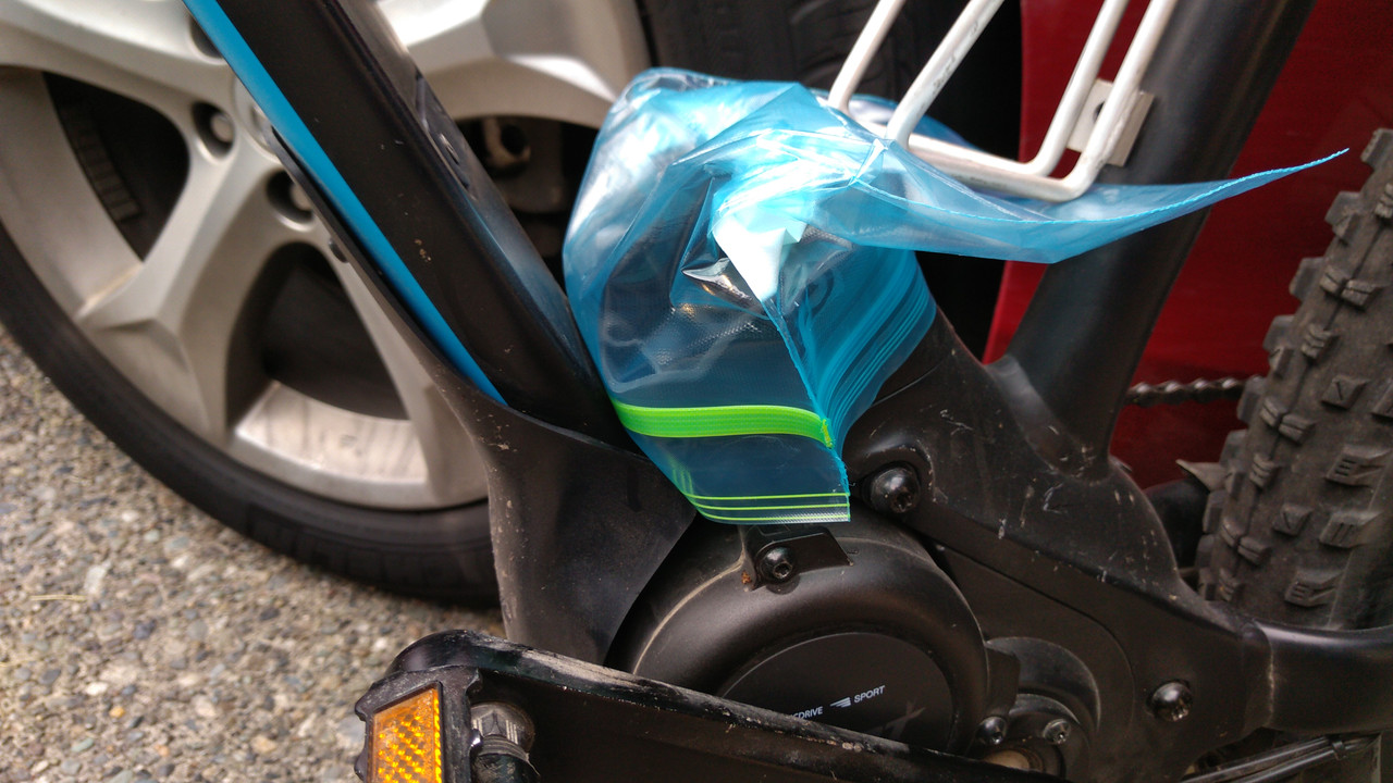

Thanks to a little accident yesterday morning giving me a cracked rib and very bruised shoulder and back, I needed to lift my e-bike onto the bike carrier on my car. Darned HEAVY!!! So I removed the battery first, making it somewhat easier to lift (but still painful with the rib). Anyway, that got me to thinking that if I wanted to drive somewhere with the bike on the rack (without the battery in place) all the battery connections on the bike would be exposed to the elements. Rain, dust, etc. probably wouldn't be good for that.
So, has anyone found a good way to cover those connections when the battery isn't in place?

DaveMatthews
Giant does have a snap on plastic cover for the battery connector area when the battery is off... while being transported on a car rack, in my case. My local shop had them for the side removal batteries in stock, and are ordering me one for my ToughRoad. About eleven bucks US.
Well that's a much better deal than my plastic bag and rubber band idea. :)
