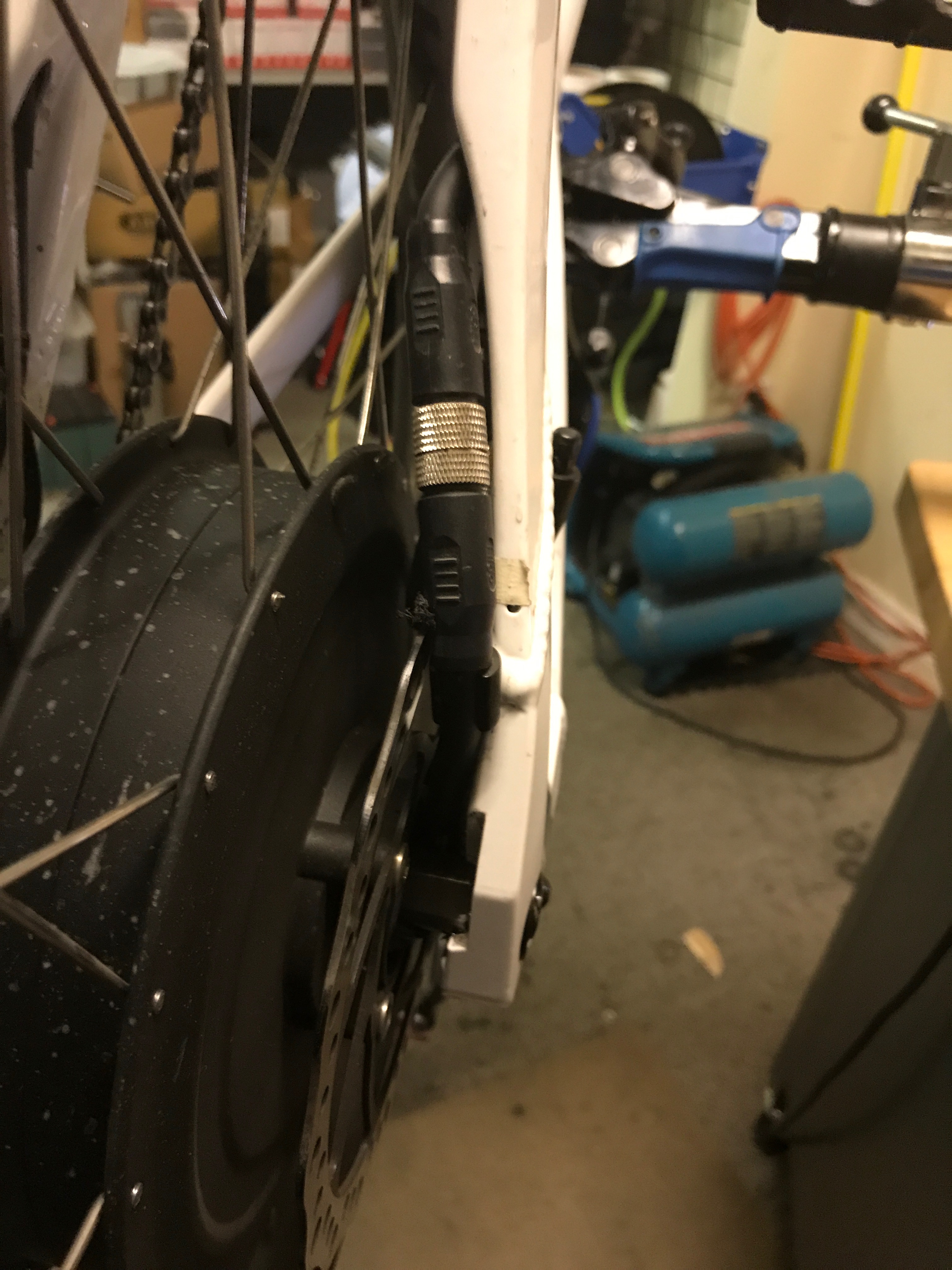

john peck
100 mi review, calibike whl. & motor as replacement for damaged CCS bafang: The main difference one has higher torque vs. less rpm as
opposed to more rpm, less torque. I'm very satisfied with it now, but only after a few changes. Initially it performed well above 16 mph,
but was sluggish at low speeds. I'm fond of dawdling along at 12, but not of pedaling a 66 pd. bike without much help.
Solution: I already had a 50/34 chainring on the bike so I put it on the 34. Thus I was providing more torque with less effort which was also
picked up by the torque sensor. That's all it took. I can ride in eco on the 11 tooth 70% of the time. It's a slight trade off; I use a little
higher cadence, but it's not as much work. All in all, not bad for inexpensive plug & play wheel. Not quite as good on longer steep hills, but
only by about 10 yards,
