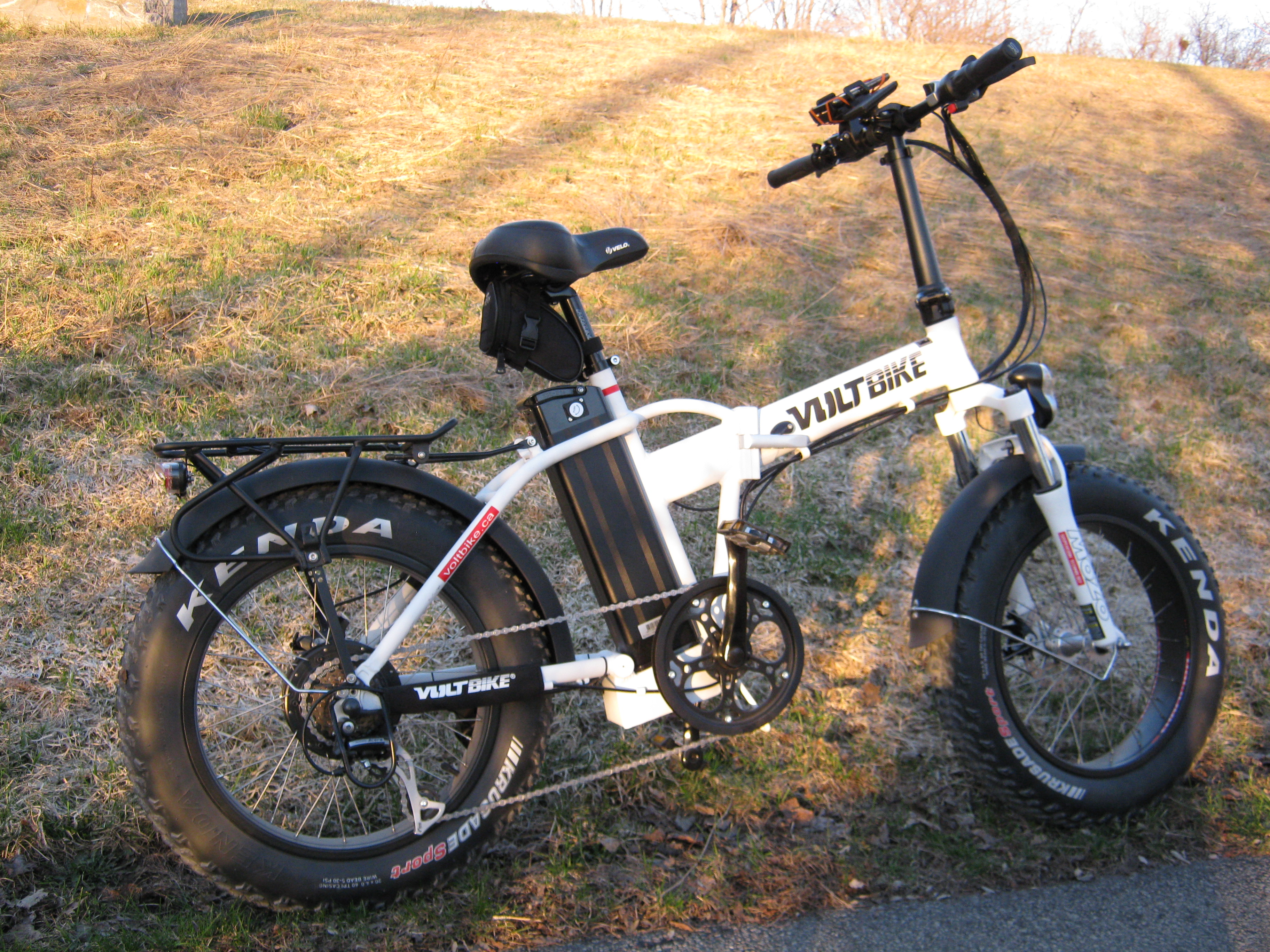

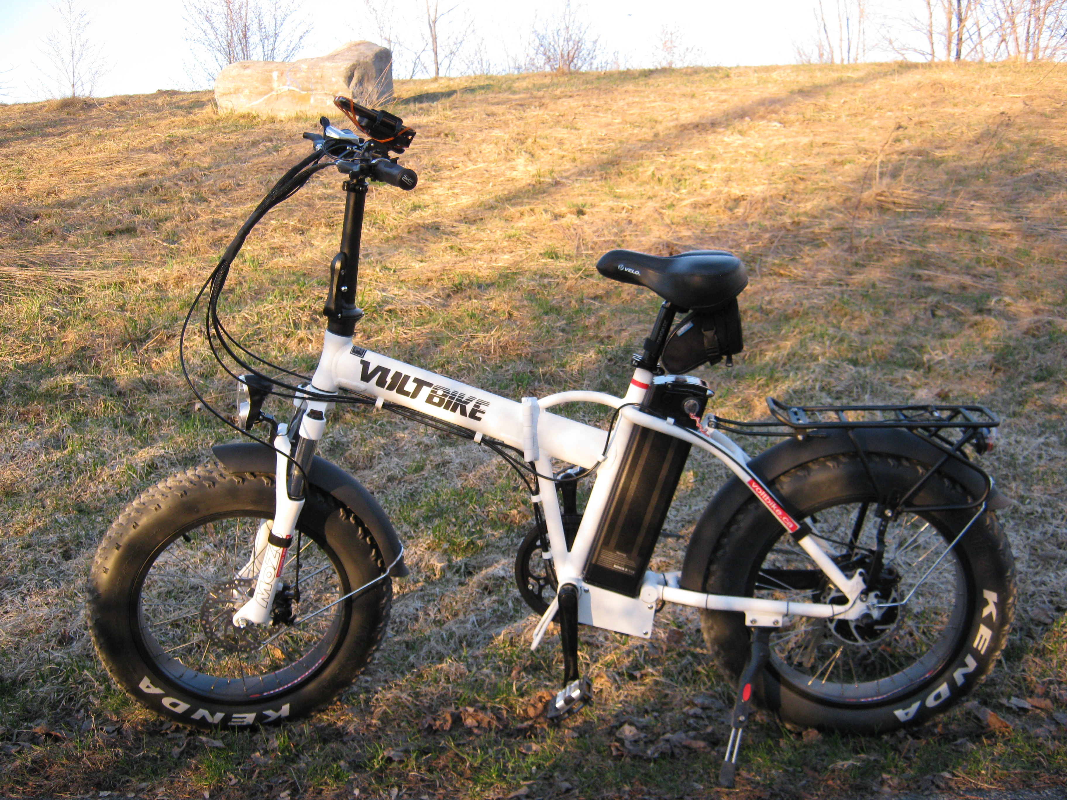

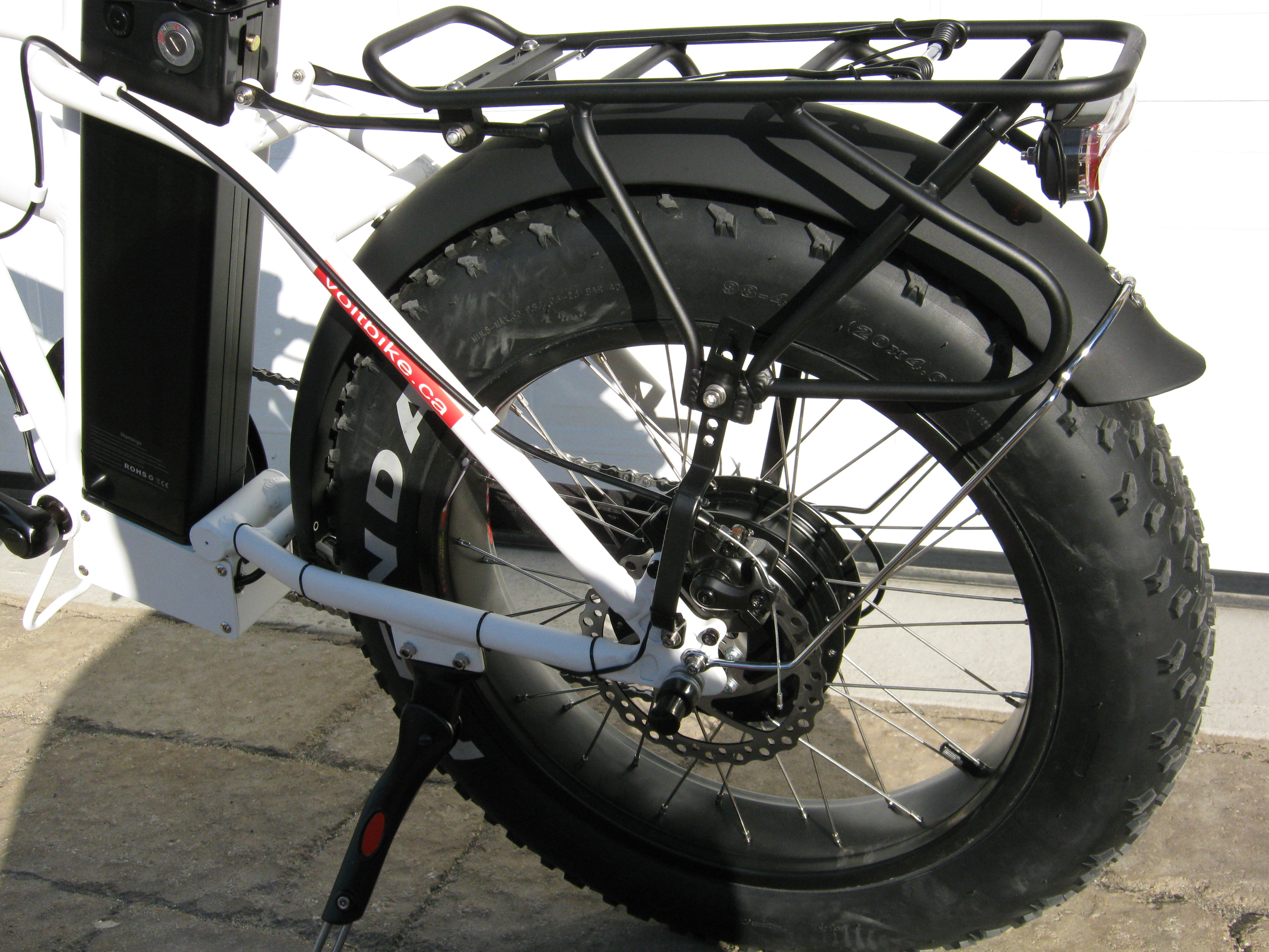

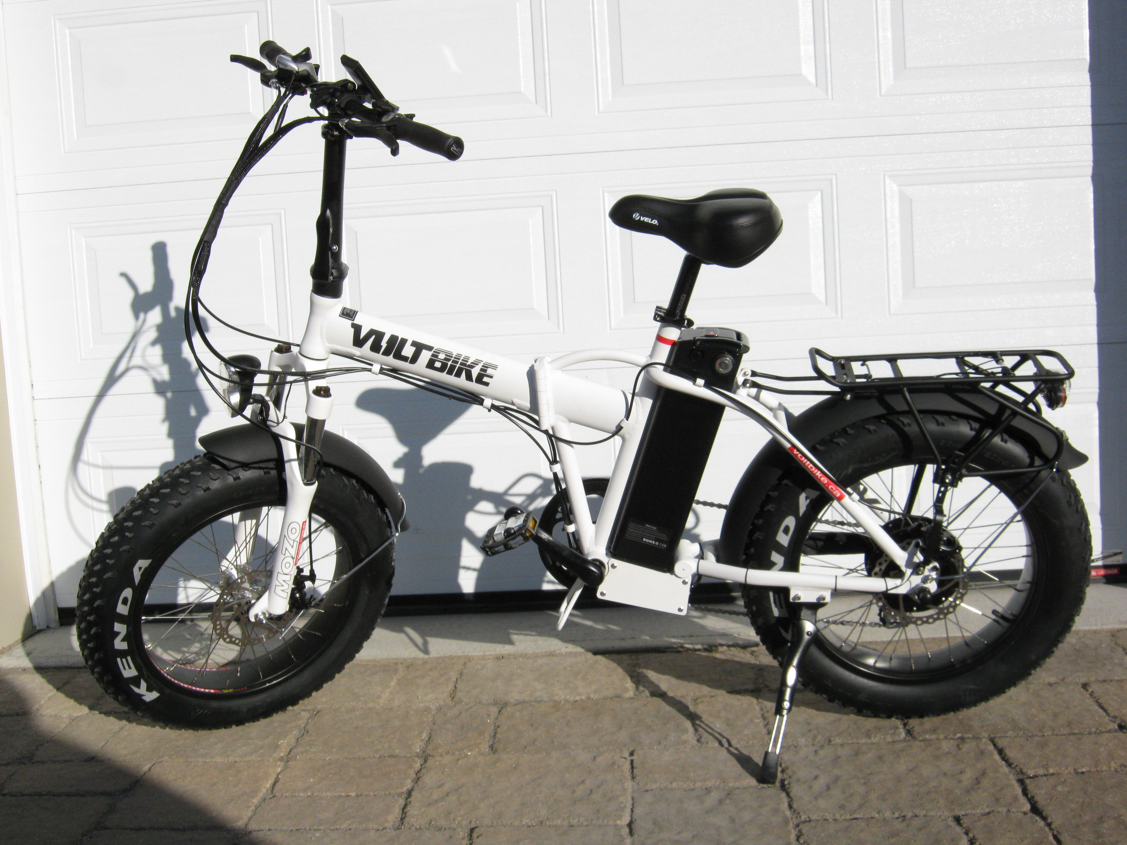

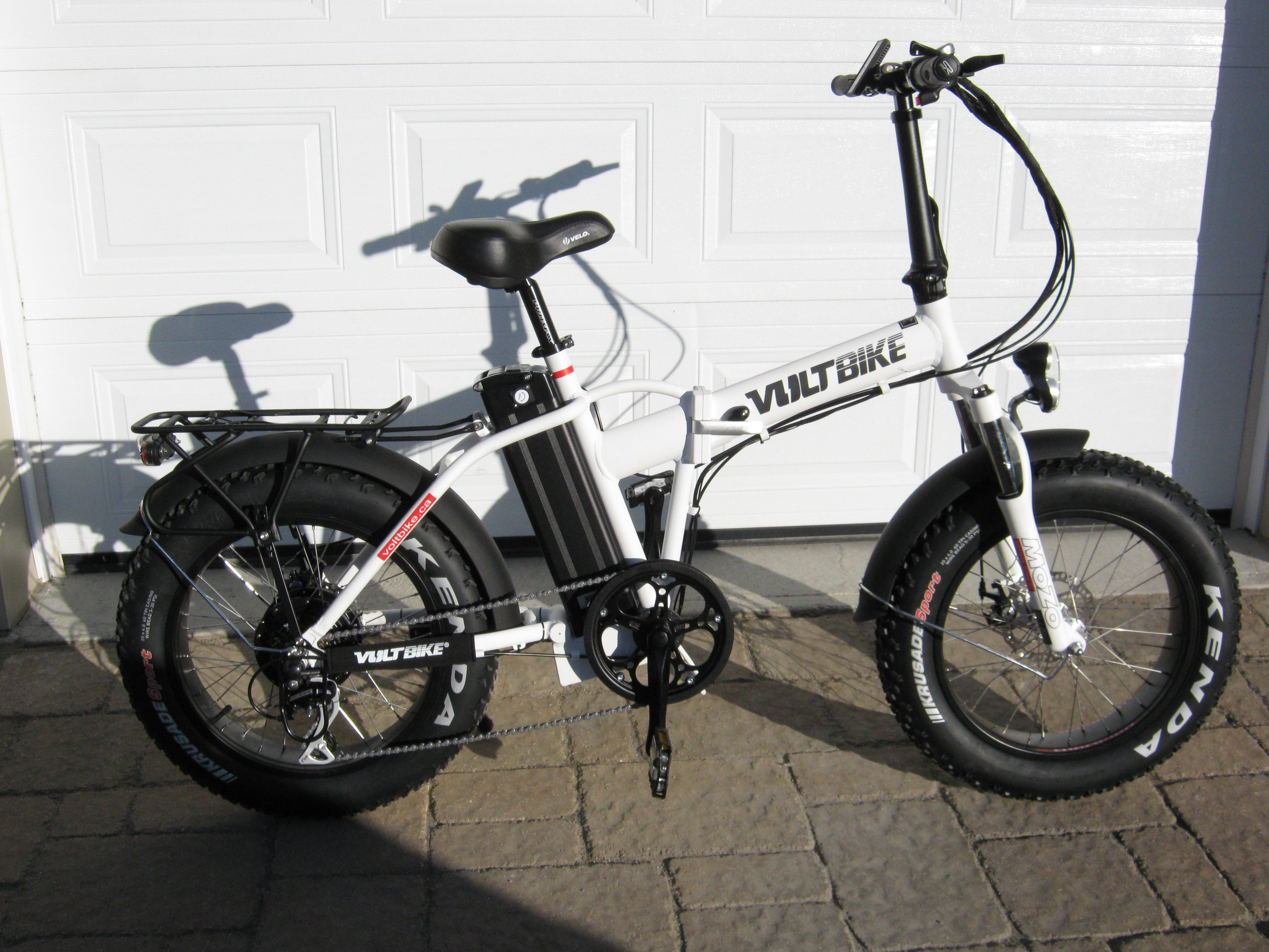

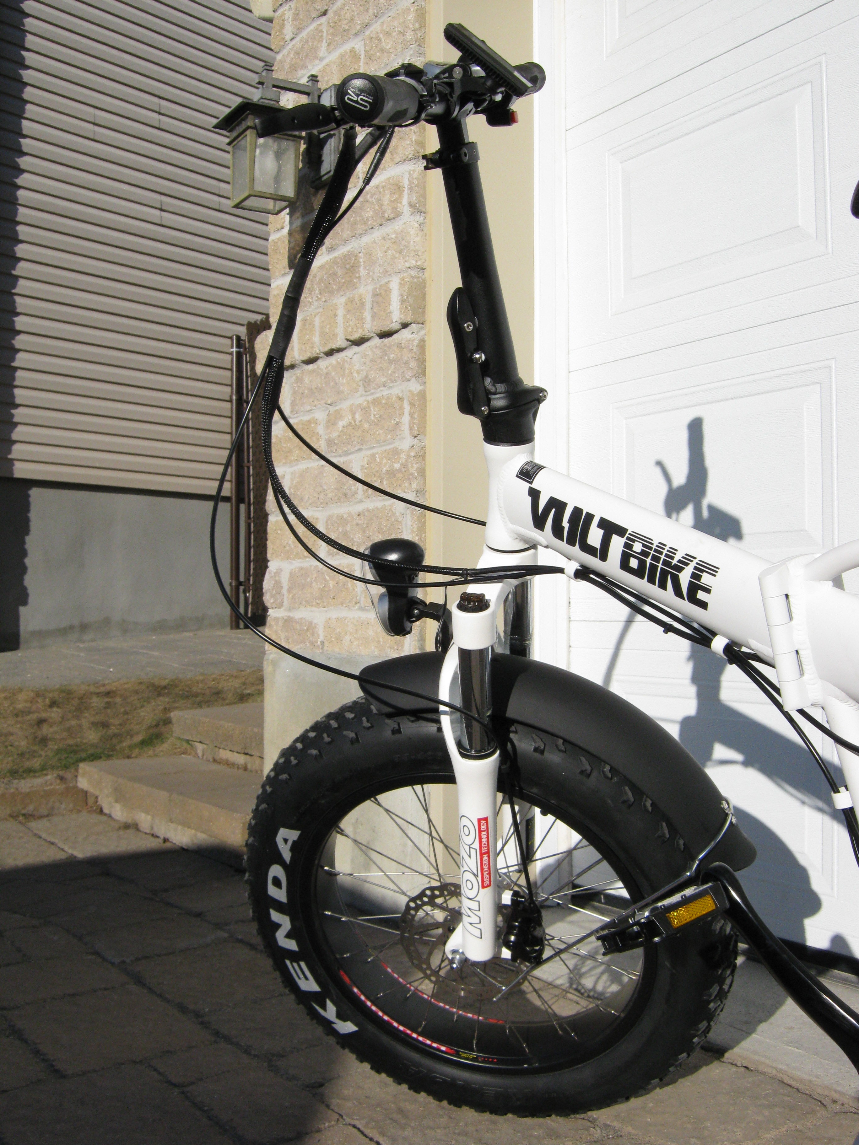

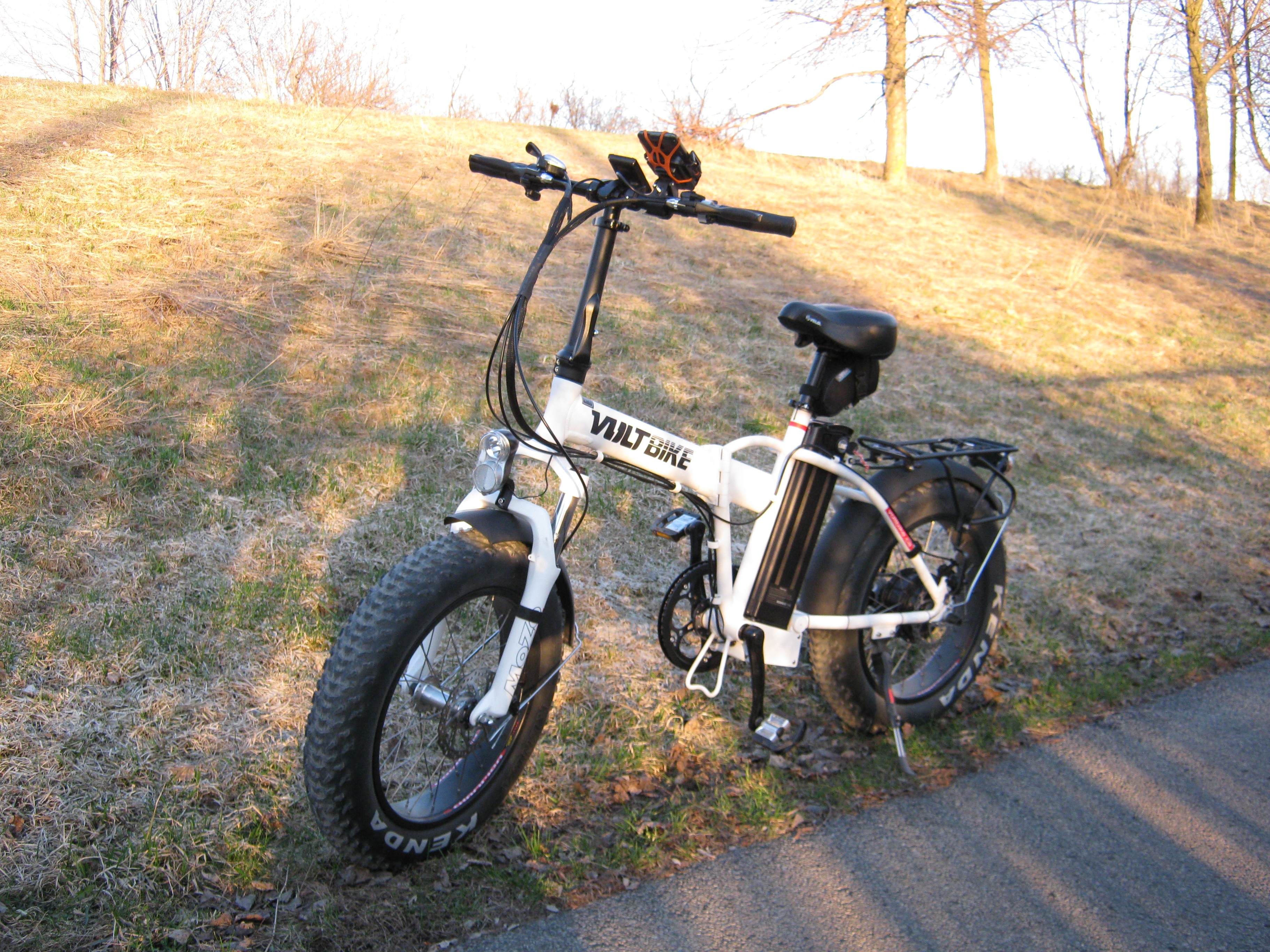

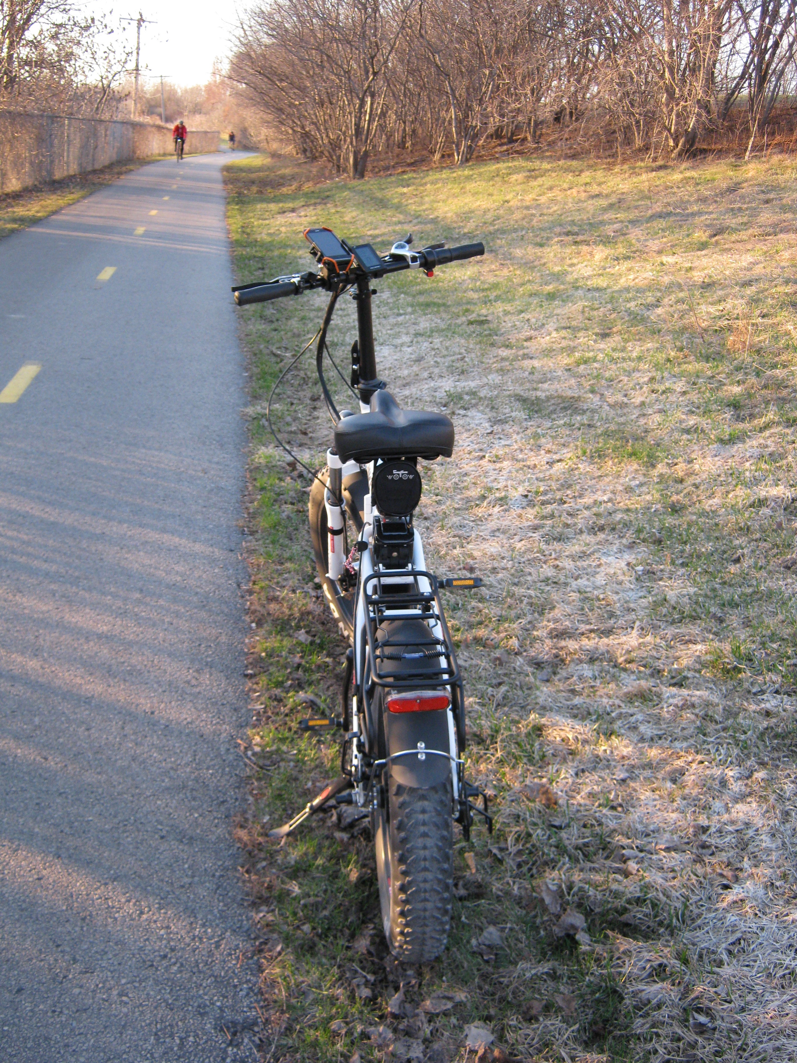

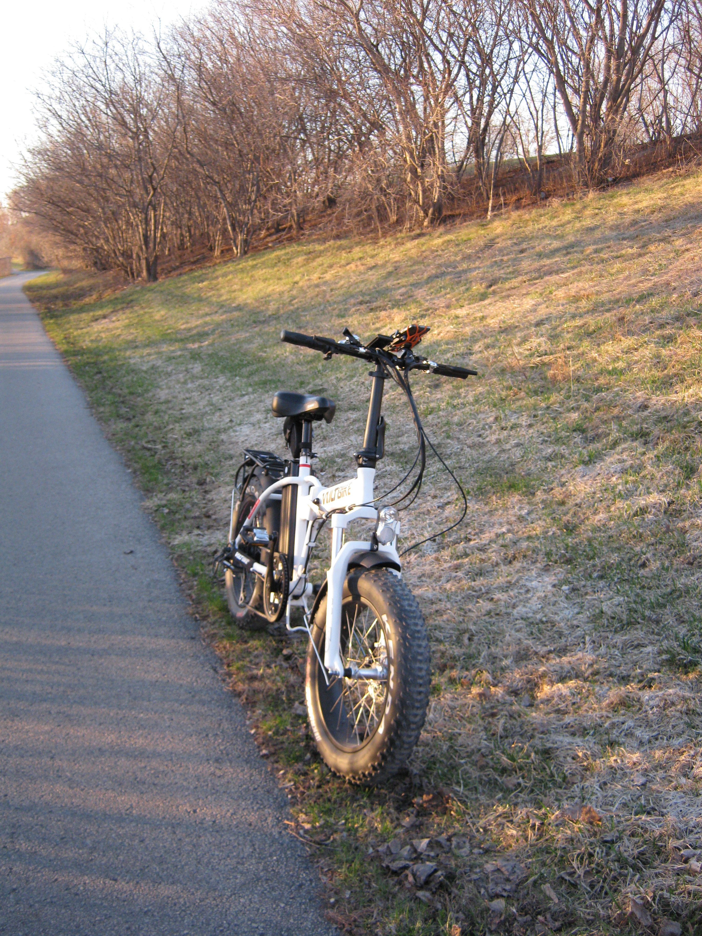

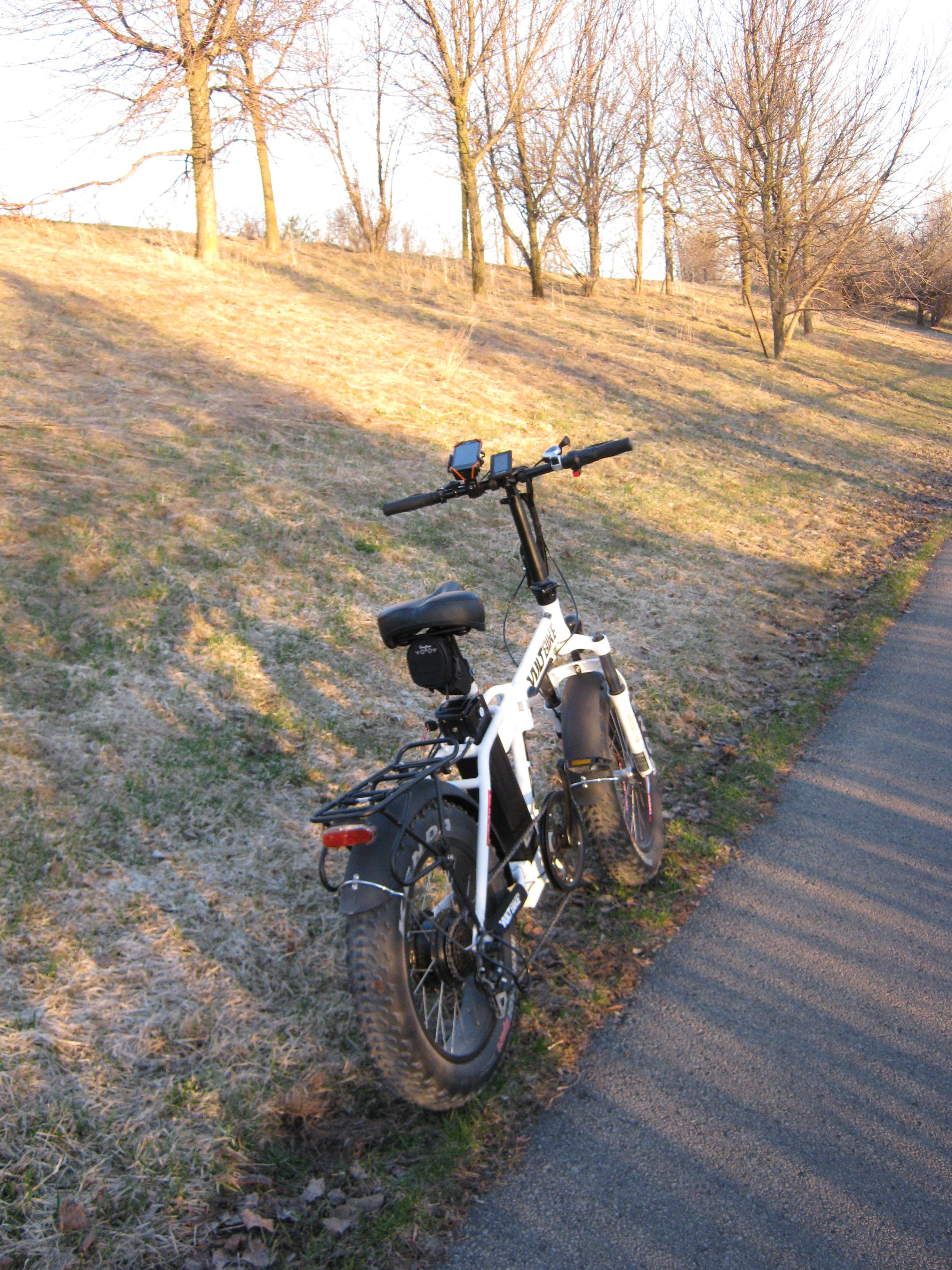

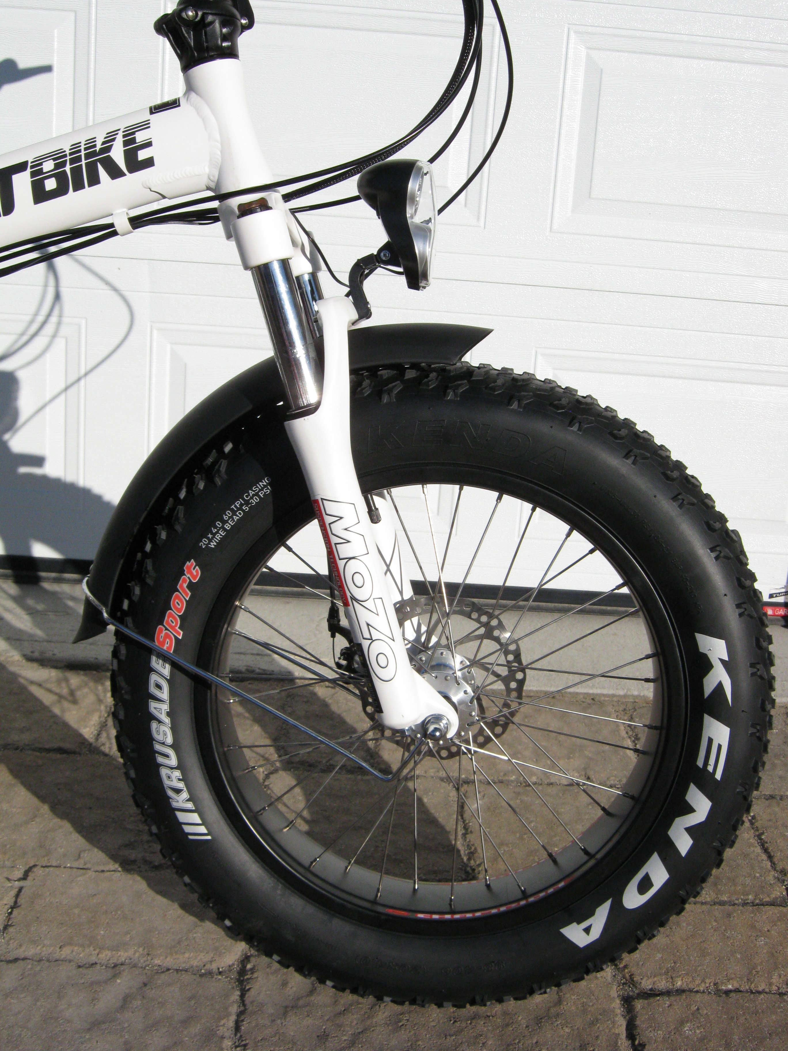

I have placed the order for a new 2018 black Marine on April 3rd and I have received it 14 days later, on April 16th! Today was the first day I could actually ride it (to work), so here are my impressions so far! :)

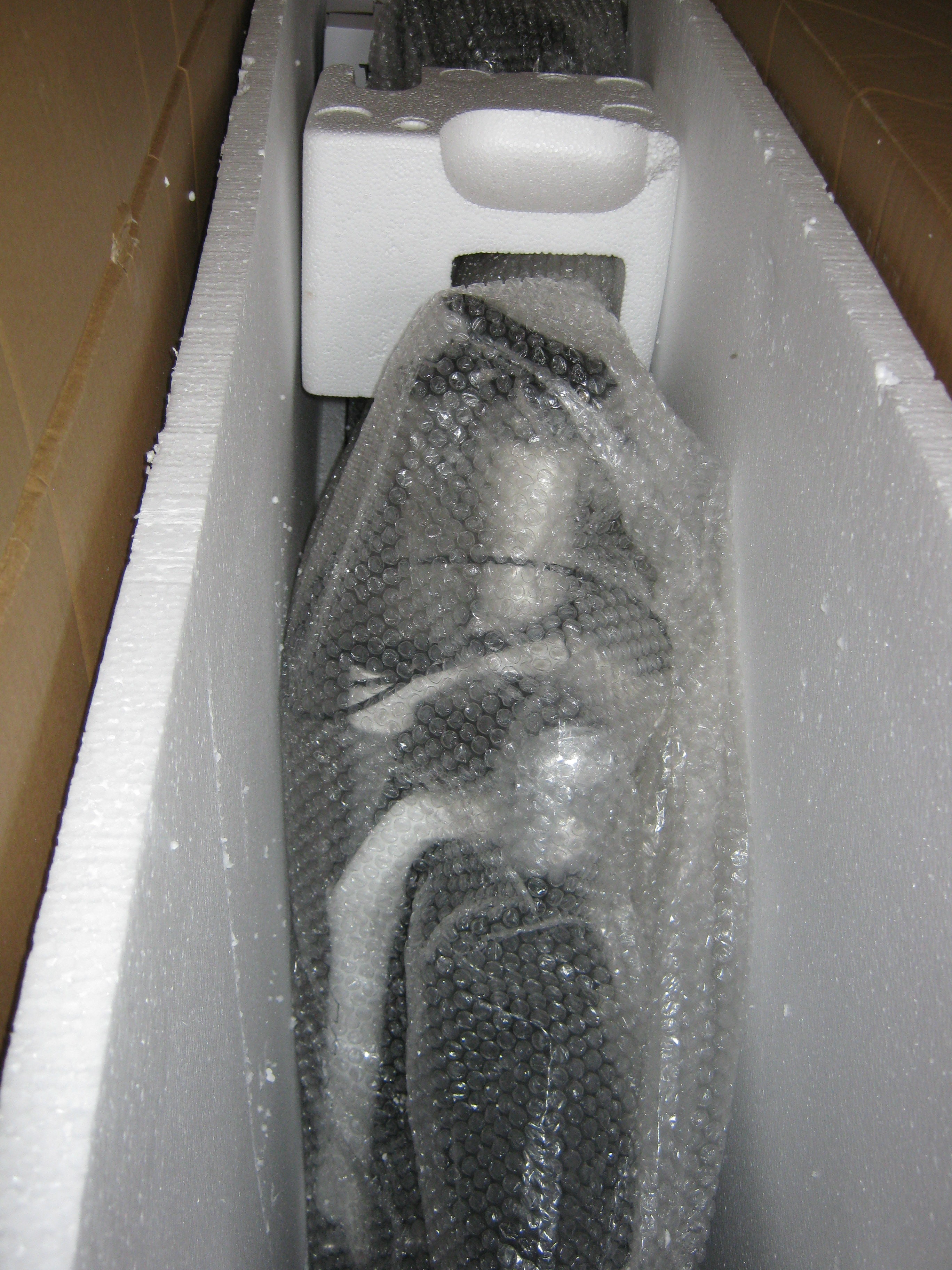

The delivery
The bike was delivered by Vitran Express. The initial delivery schedule was April 11th, but a couple of days later it changed for April 13th. Their tracking web page showed "Scheduled delivery: April 13th", but be careful, it should be read "Scheduled call for delivery appointment"! Vitran called me on April 13th to schedule the delivery on April 16th between 10AM and 4PM and I had the bike in my garage on 16th at noon!
The box was in good shape, but opening it I had a surprise: the black ordered bike was actually white! It wasn't so bad, so I decided to keep it. I guess a white bike should be more visible at night even though the old saying says that all cats are black at night! :)

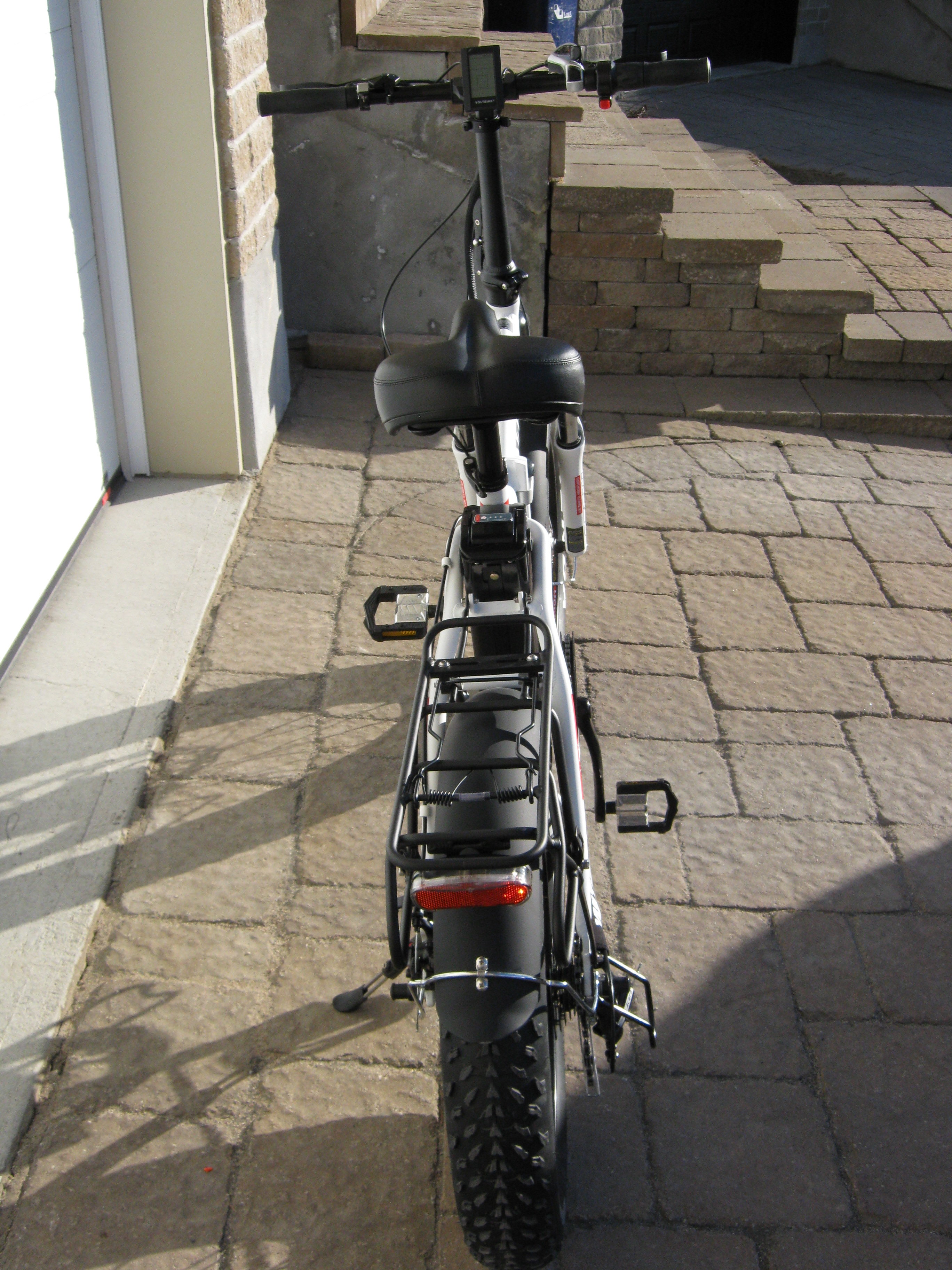

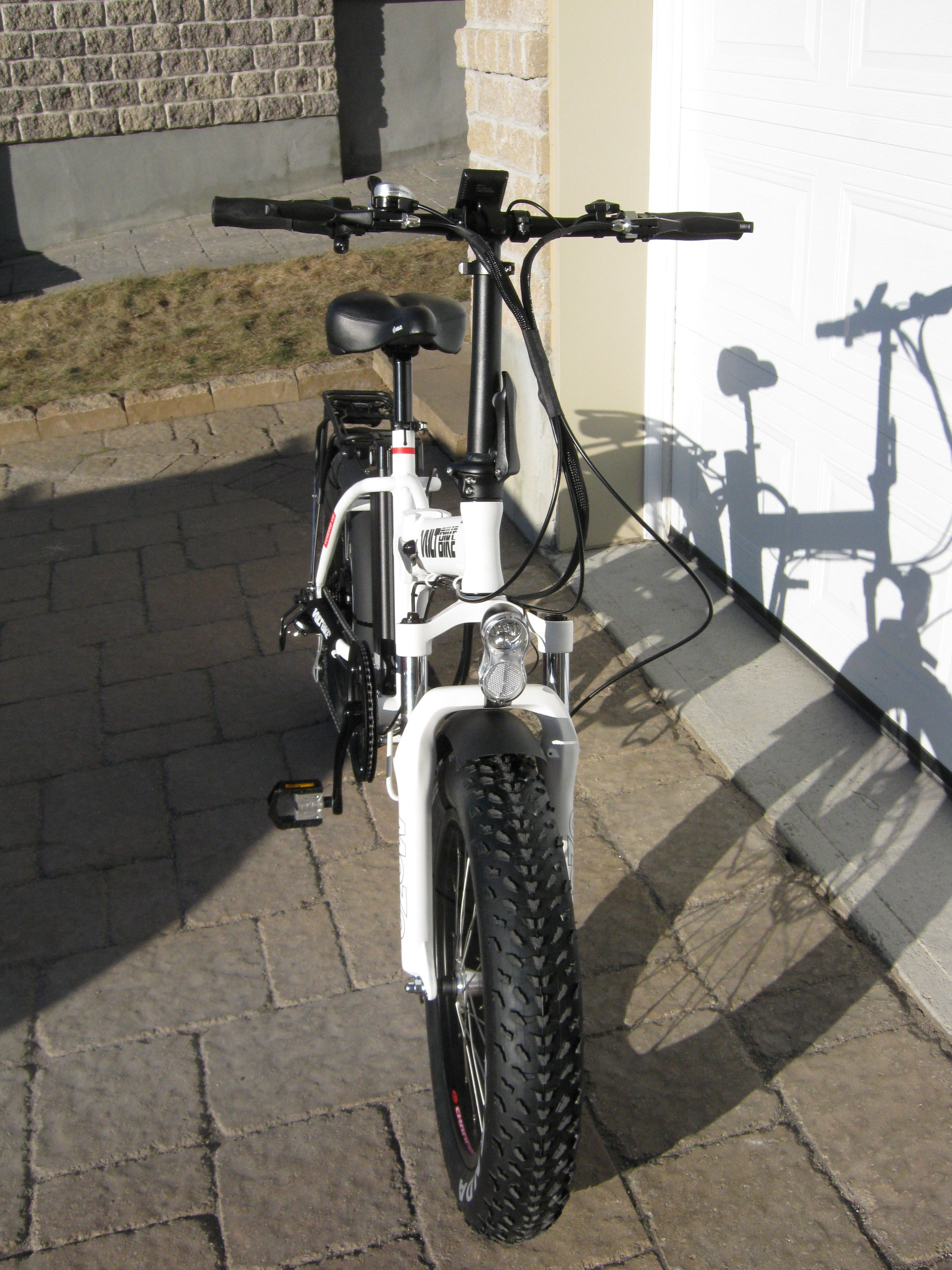

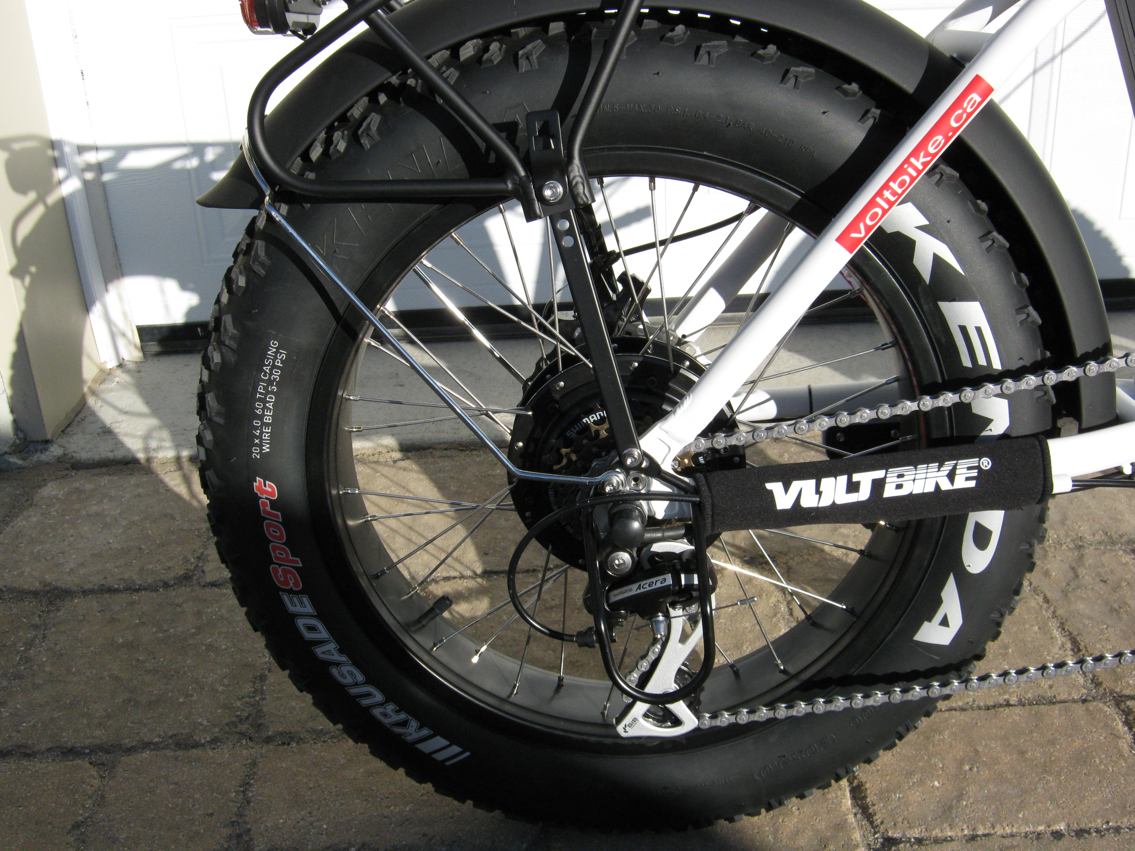

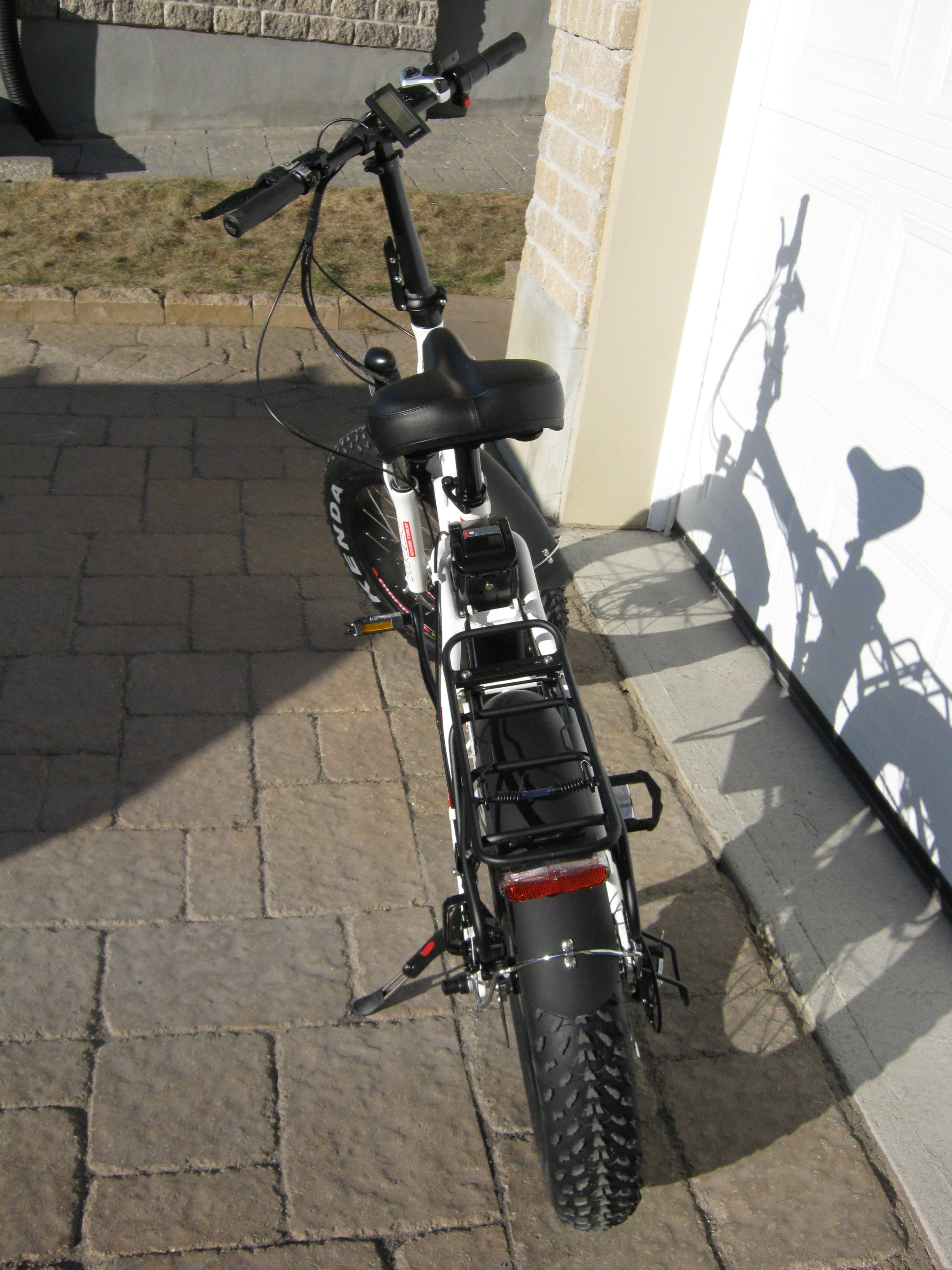

The bike

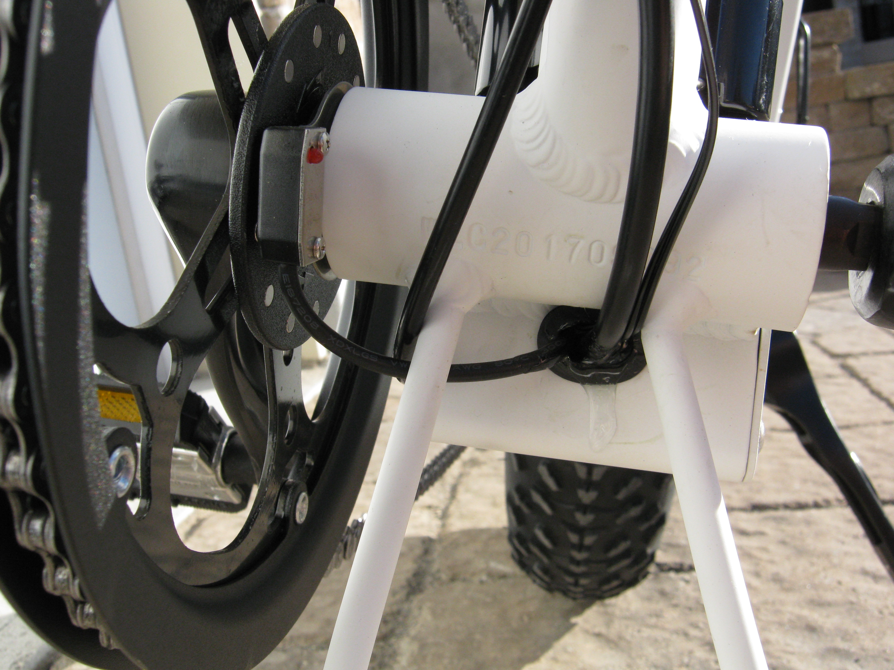

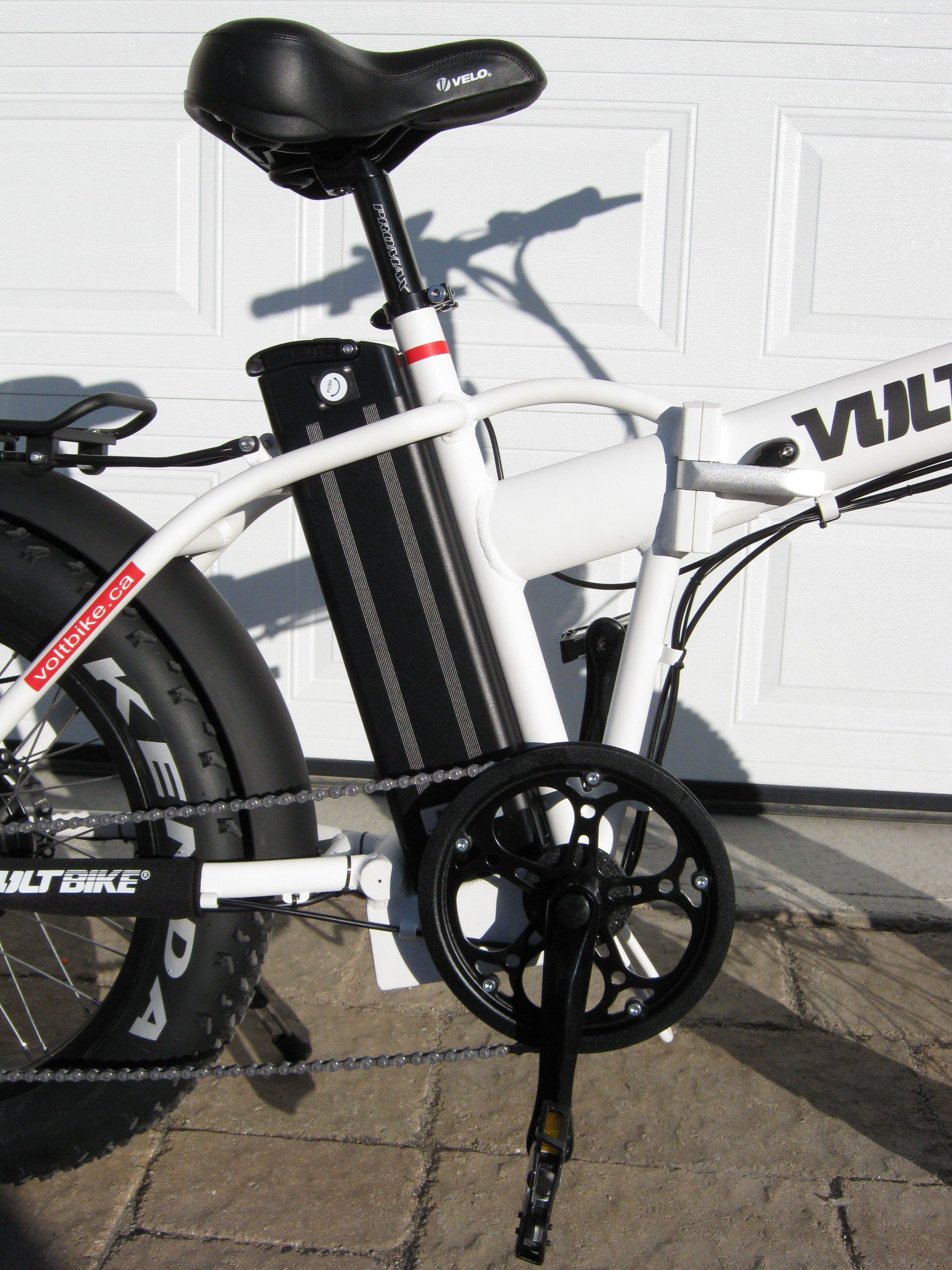

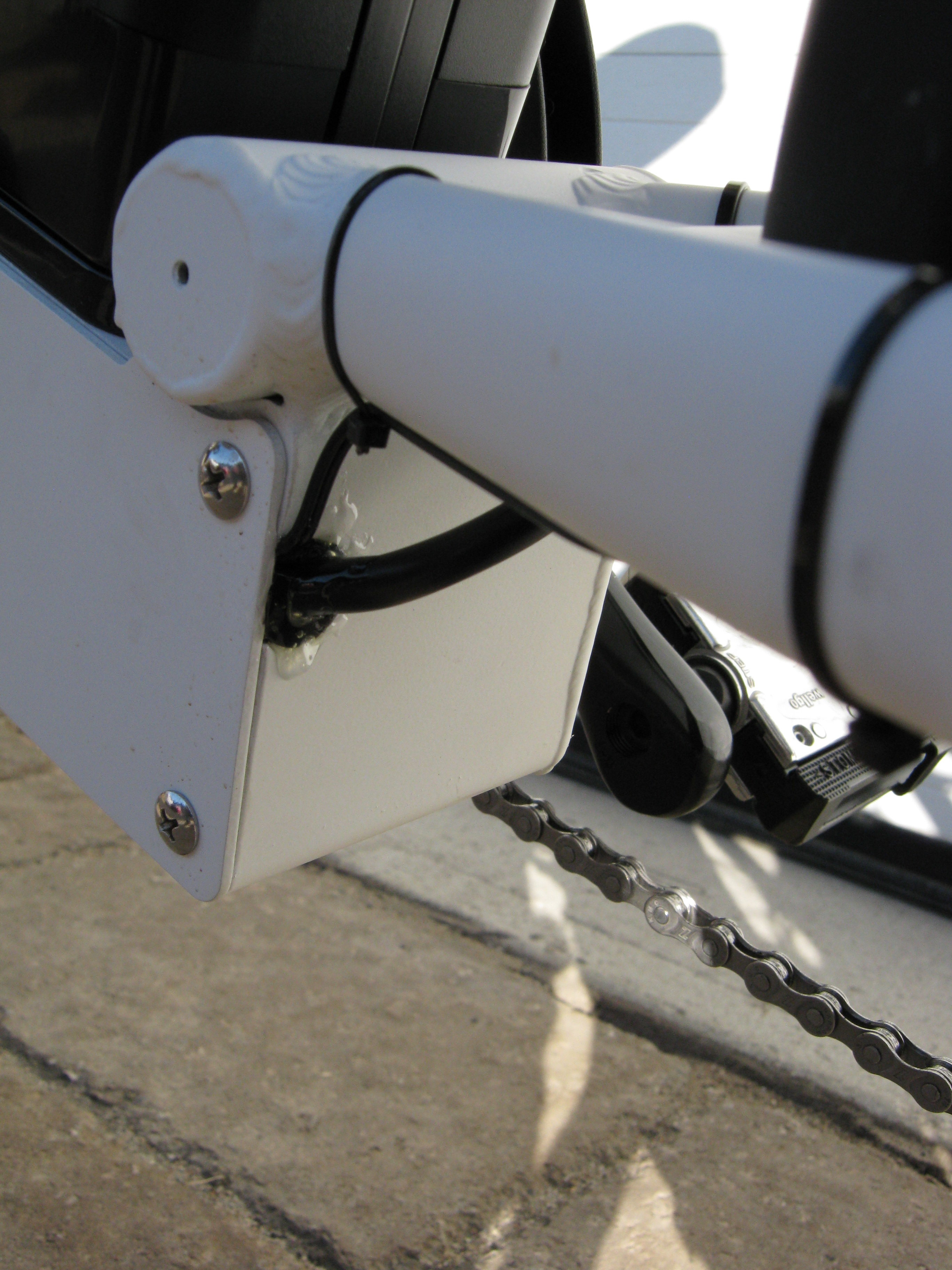

The bike is very sturdy and the solder points look well. The quality is there, no doubt about it and there are some improvements I could immediately see over the previous years (judging on the reviews I read here and watched online in the past year):
- the controller holes are now sealed with transparent silicone
- the chain has guards on both sides of the chainring
- there is a front suspension
As @Cnugget wrote in one of his posts, the best wheel size giving the most accurate speed reading is 22''. With this setting the motor tops out at 32km/h on flat terrain.
Today I had the chance to take the inaugural trip to work and the maximum speed I could achieve on PAS 9 and vigorous pedaling was 34km/h on flat terrain. I was able to sustain between 28 and 32 km/h the entire commute (around 22km one way) and when I arrived back home the battery still had 1 bar left. And this by pedaling the entire way and having the tires inflated at the maximum recommended 30 psi to reduce the drag. I followed all traffic signs as a model cyclist and I managed to get close to one hour for 22 km. Google maps estimated 1h17min for the same trip.
The bike is heavy and there is no way to ride it so fast without PAS. Being heavy it is also very stable. The disk brakes work well, the gear shifter is precise and smooth, the saddle is comfortable. It accelerates pretty quick. One of my coworkers rode it for a couple of minutes and was impressed by the quick acceleration. Being used to ride motorcycles I wasn't so impressed, but if you switch to PAS 0 and try to take off using muscle power and then you do the same thing using PAS 9 the difference is huge!
On the downside, the weight and size of the bike makes it hard to move around folded. My desk is at the second floor and it is not trivial to take the stairs with the Mariner in your arms. It is possible to roll it over using the handlebar when folded and this is very helpful.
Also, the front left fork knocks on the left chainstay when folder and I had to wrap something around it to prevent more scratches.
There is no suspension on the seat post and having the tires fully inflated to 30psi gives a bumpy ride.
This is it! So far I am happy with the bike! I have also ordered two spare tires and inner tubes for it since I expect to ride it around 300km per week and these are the things that will most likely be the first to wear out. They were out of stock when I ordered them with the bike, but I should receive them soon. I have also ordered a spare charger so I could charge the battery at work if the level drops too much.
Here are some pictures of my bike.
img_3233.jpgimg_3239.jpgimg_3241.jpgimg_3243.jpgimg_3246.jpgimg_3247.jpgimg_3248.jpgimg_3249.jpgimg_3245.jpgimg_3244.jpgimg_3242.jpgimg_3240.jpgimg_3238.jpgimg_3251.jpgimg_3256.jpgimg_3257.jpgimg_3255.jpgimg_3254.jpgimg_3250.jpg
I'll be back with comments / observations later as I put more kilometers on the bike.
Ride safe!
