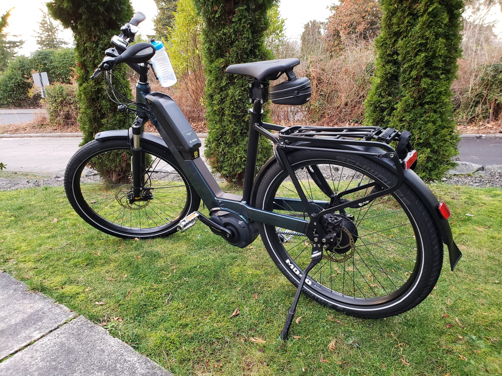

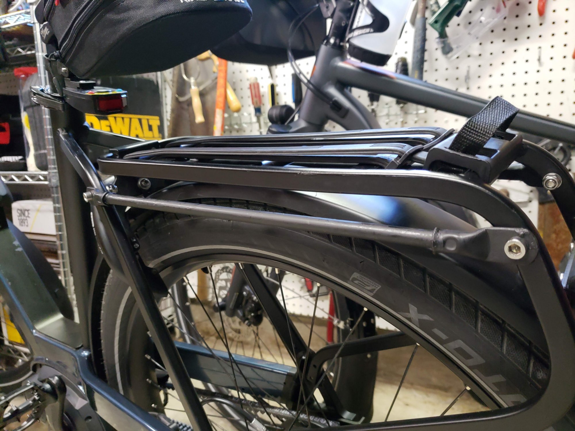

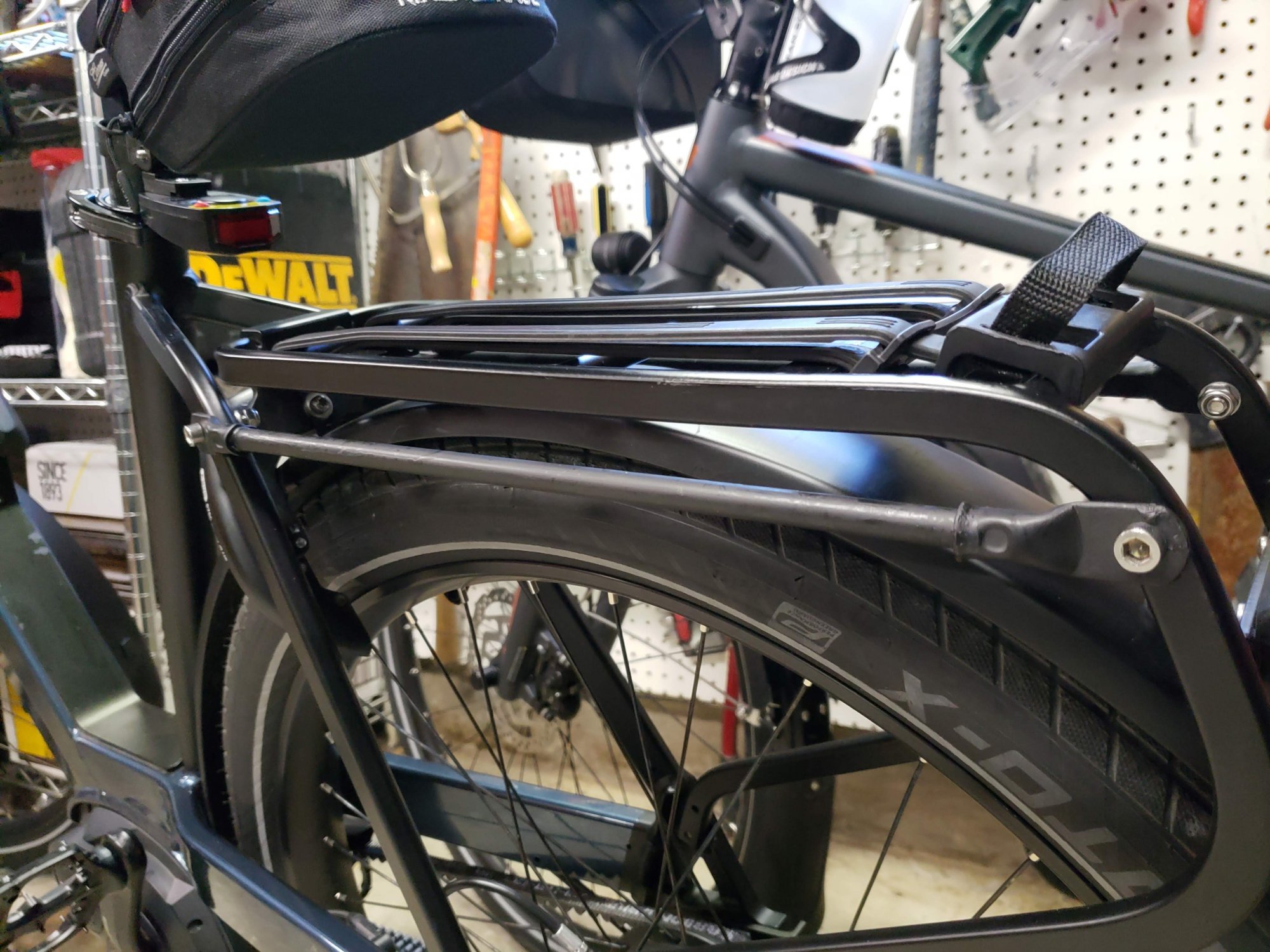

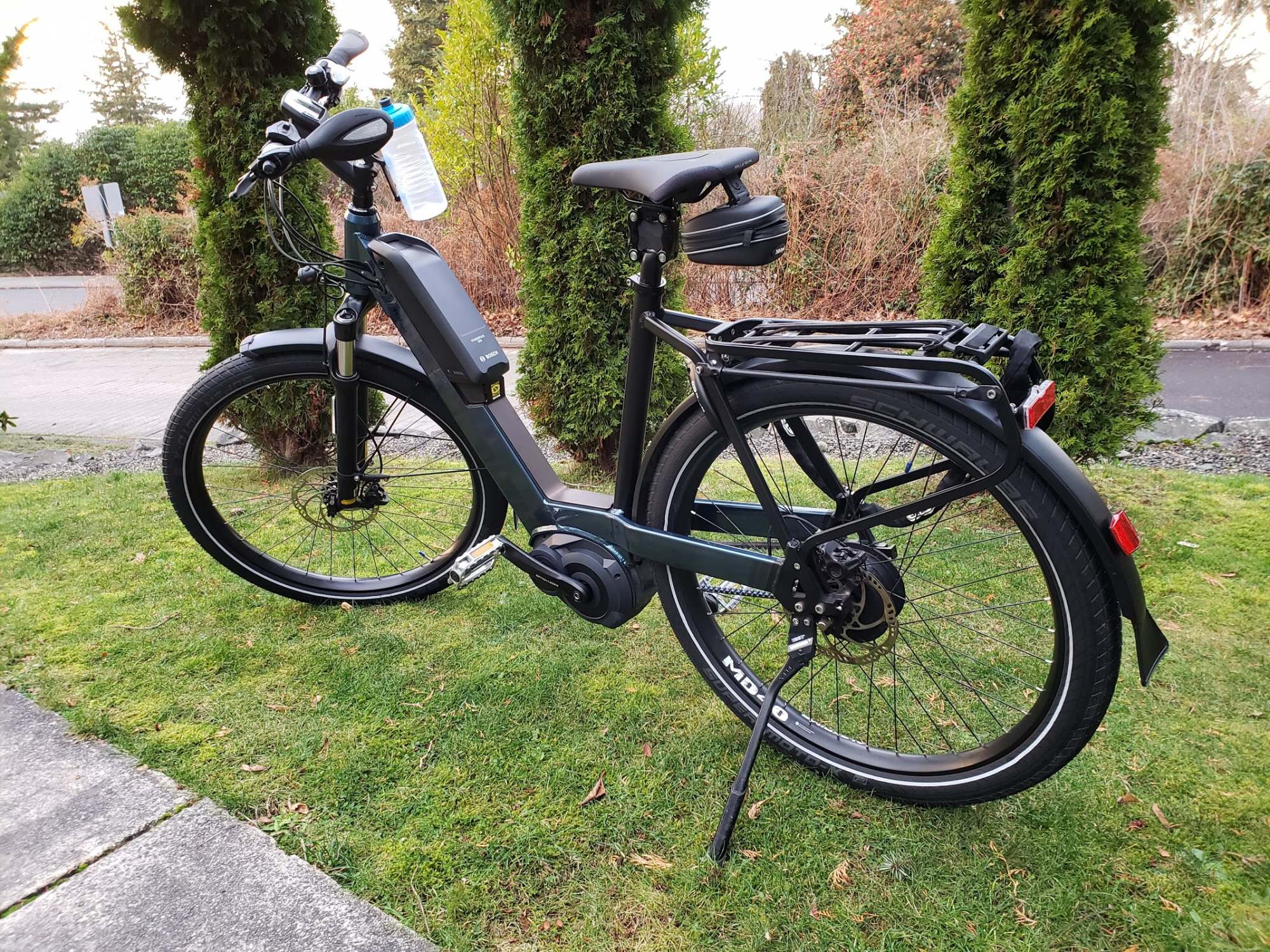

Alaskan
I modified the rear rack on a Nevo that I owned by adding a lower pannier rail on each side. Here are two photos showing that customization I did. Aluminum rods with battery terminal ends, crimped, epoxied and panted with matte black. I placed the rails low enough to allow for a trunk bag in the middle and an Ortlieb pannier on each side.
View attachment 40801 View attachment 40802
That's a sweet mod. I might have to replicate that.

Mapachin
Waoo ! This is a very simple and smart way to solve the issue of panniers versus rack bag incompatibility. is it holding good? Thanks for sharing.
