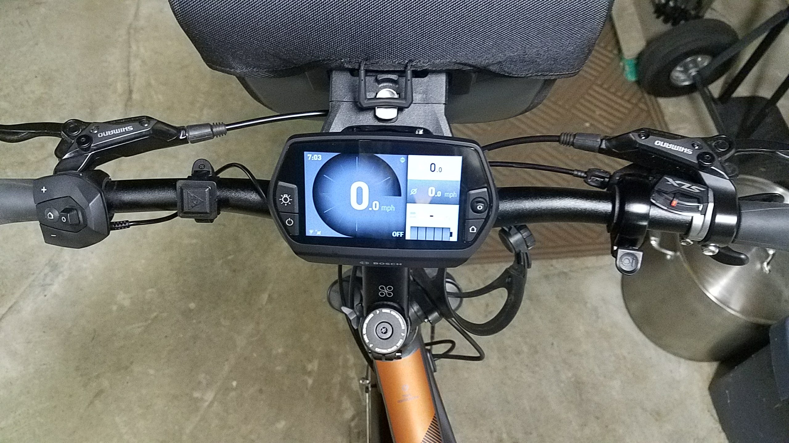

I got a new nyon off eBay and it arrived today. I have a 2018 Haibike, which came with the Intuvia. I charged the Nyon (it was dead) and connected to WiFi. It updated its software and then I downloaded the app from Apple for my iPhone. Everything went smooth. I put the unit on my bike and it just worked! Reading this forum, I thought I needed the special controller, but my Intuvia Controller works fine!
This is the 1GB version, but I can “stream maps” from my iPhone if I need more. But the entire 4 states around me only took up a few hundred MBs.

I found a used Bosch Nyon display on eBay from a California based seller for $100 - free shipping. He did have a bunch of them. The display arrived and appears to be in nearly new condition, no scratches or dings, with the "remove this" screen protection still adhered. There was also a German seller that had the left side thumb controller for $60 plus $18 shipping.
They arrived and I was able to snap the display on to the center handlebar mount for the Intuvia that came on my bike. With some searching I was able to find and download the correct app file for my Samsung Android phone which is not available in the USA through the play store. I then proceeded to set up a profile at the Bosch Ebike Connect site.
I replaced the Intuvia controller with the Nyon controller that has a duplicate joy stick, mounted the Nyon and got a 580 error message telling me to take it in to a dealer. Pushing beyond that screen allowed me to connect the display to my home wi-fi network. Once that was done the unit automatically updated, adding eMTB mode to the mix! Connection to my phone through the app was simple and straightforward. I downloaded the maps for my home state, set up custom screens for Riding and Fitness. I was able to purchase the custom riding modes at the play store, which registered with Bosch no problem.
For under $180, I now have a fully functional Nyon on my Cube Touring Hybrid Exc 500 with Bosch CX drive.
The Nyon is so much more than the Intuvia. It connects to a heart rate monitor, has a vast array of customizable information, built in GPS with mapping and trip planning and the Bosch Ebike Connect portal is easy to use, intuitive and very useful. The only downside is that, as a rather robust bike comuter, it takes about 15 seconds to boot up so you cannot just push a button and go when you get back to your bike. Just start it up while you are unlocking and it is all good.
The Nyon was the most useful, coolest add-on I have put on my bike.
