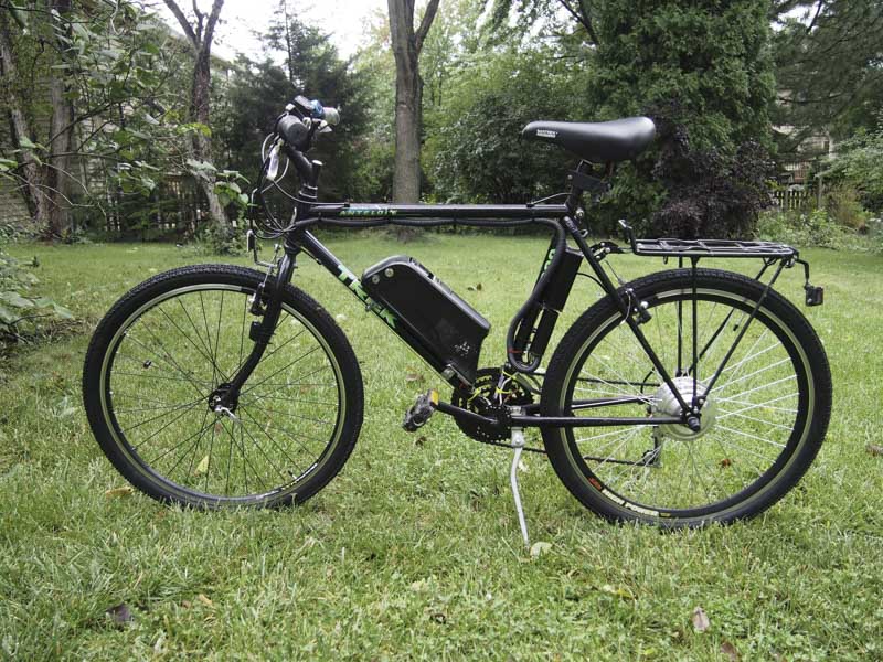

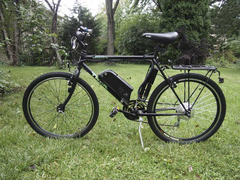

I enjoy putting motors on bikes almost as much as riding them.
My most recent ebike build. Still needs some cables shortened. Bike was set out in neighbor's trash. I didn't really want it, but my wife said take it before the scrap pickers come by. Added $160 ebikeling motor, but had to put in a $75 KT controller with LCD. It can run on anything, but I use a pair of $35 36V 4AH hoverboard batteries. So call it $325. It's getting a new derailleur this week. $15.

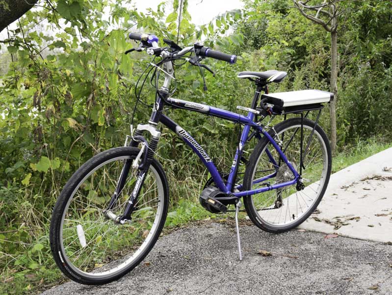

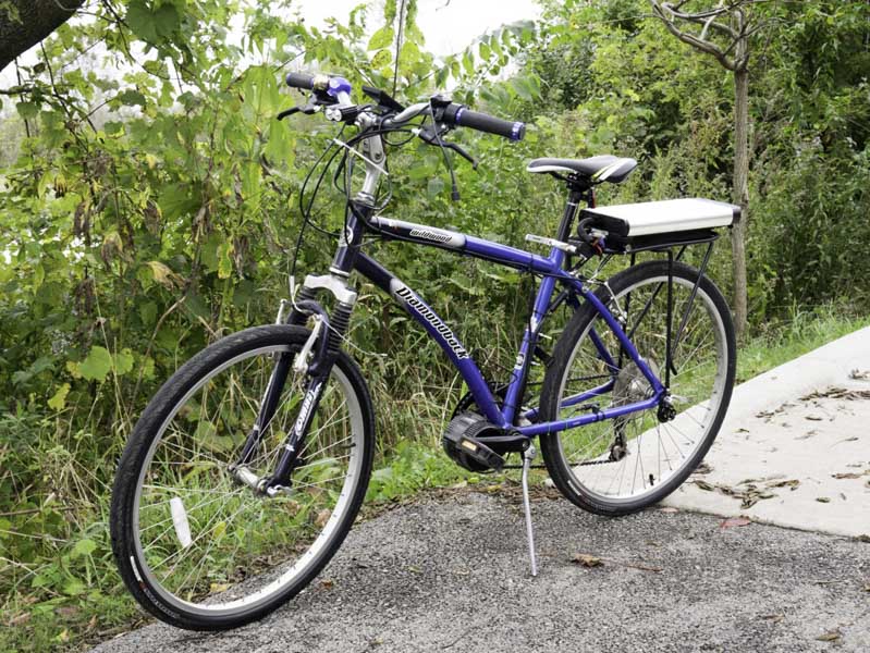

This blue bike cost me about $1000. Our old Diamondback Wildwood with BBS02 mid drive and 48V rack battery. Will do about 28 mph. Rarely go over 18 mph. Took it to Colorado and it climbed every paved bike path. I did put disk brakes on the front wheel. Another $100 for a new wheel and brake hardware.

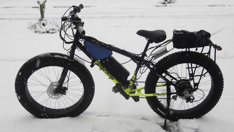

I only rode this twice in the snow. Two motors. Two batteries. The bike was only $79 from Walmart, but I spent a lot of money to upgrade the heavy steel components, buy decent tires, etc. It originally had decorative v-brakes. This thing eventually pushed past $1600, but it was spent over 13 months, so not so painful. Simce this pic, I've taken off the front motor, and will put that on another bike.

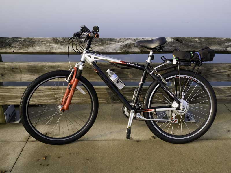

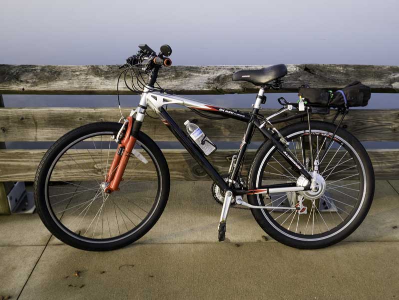

I have built more, but my first one was only $500 for motor and battery. For a lower profile, I'll take off the Dolphin and run a smaller battery in a bag on the rack. My Ryobi weedwhacker battery will give me a hour at 14 mph, while one of those hoverboard bombs will get me 90 minutes at same speed.
