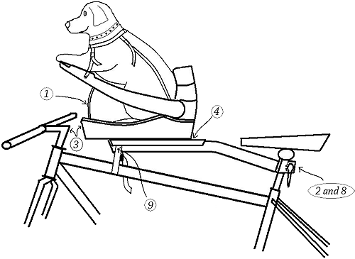

Hi Court, I already have a trailer to hitch on the back of the Toba, but I'd be more reassured that my < 10 Lbs merrier (Maltese X Terrier) is doing ok and enjoying the ride, if I can see her in front of me. She's the little one in my profile avatar. The one closest in the shot is Lotus, a slight bigger Beagle that would not fit in a basket. Those are the two most fit of the bunch. The 3rd one is a Lhasa Apso X Shih-Tzu, that runs out of breath quite easily on our walks, but is always willing to join us in all activities. They enjoy car rides, so hopefully, they'll get used to the bicycle trailer ride.
I just found out about the buddyrider and think it would balance the weight better and avoid interference with the steering of the bike. But I would still like a basket for my tablet and bottle, since I cannot install a bottle mount on the frame. My handlebar is getting crowded with Bion-x console, bell - people can't hear me coming behind them, just like a regular bike.
