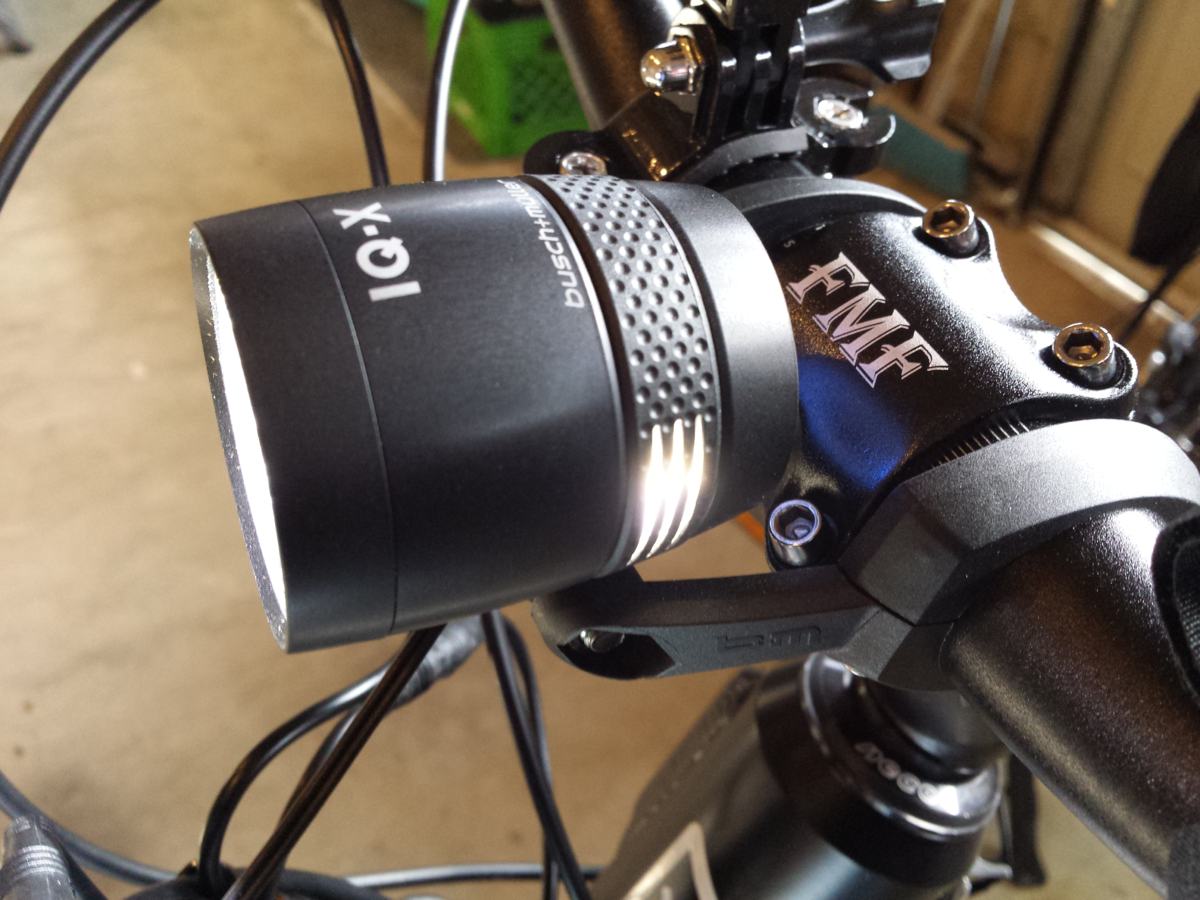

Sorry for the delay! I kept forgetting to take the photos. In the second photo you can see the back edge of the light has some vertical striping (for lack of a better description), this part lights up in 3 lines for side view illumination.

This photo is a good example of what I was trying to explain with the side lights in my above post. Not my photo or my mounting.
