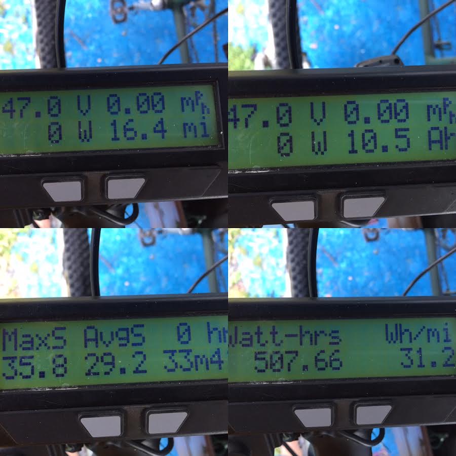

Once in awhile you have to blow out the cobwebs.
This was including pushing a 140" gear at about 80 rpm on level pavement. Hovering right around 900 + watts for the most part. Stiff cross wind for most of it with some tail wind which is where the MaxS came about I guess.

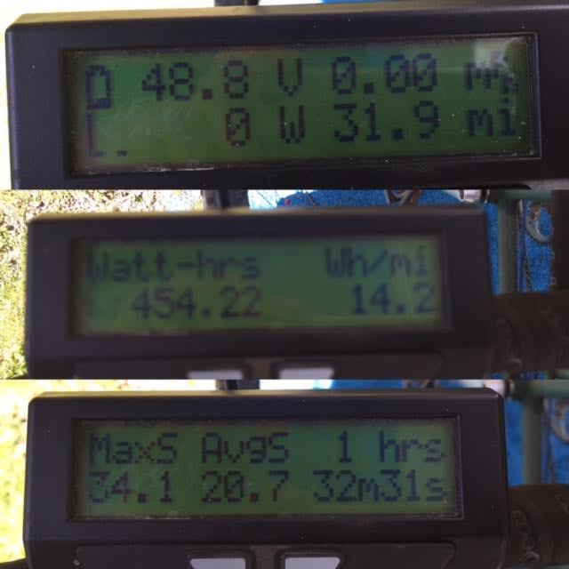

Usually my rides look more like this:
And that included a 4 mile hill climb and averaging more like 300w. Really shows how much it takes to push through the air trying to maintain Class III speed.

31.2wh/mile for a 29mph avg.speed for 33min. ?

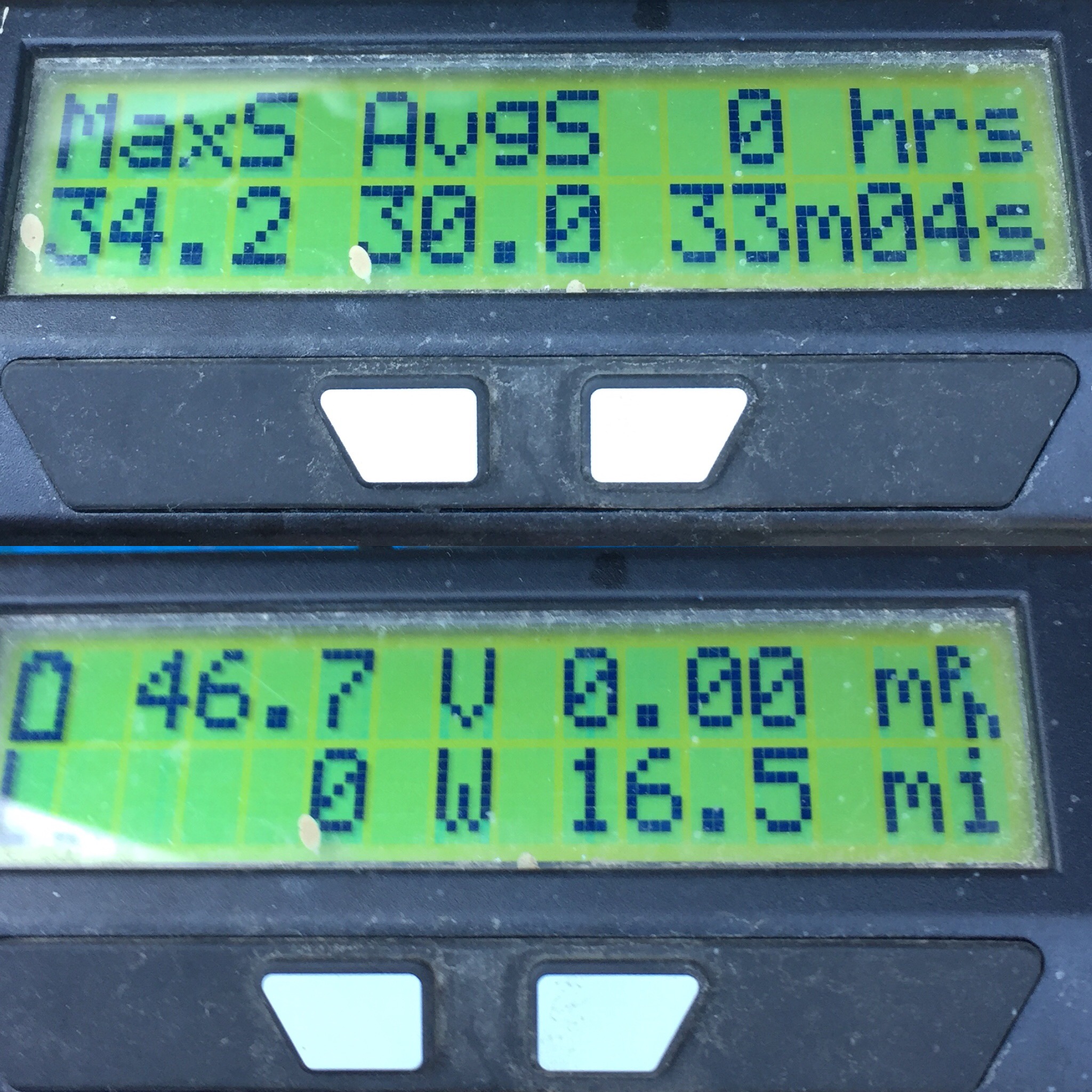

Actually that was not my best effort as I did another on the same route which was a round trip from my front door when I lived in PDX. It was a nice flat loop at a little over sea level with little traffic and I tried a few times to average 30mph and finally achieved it and used 30wh/mi.

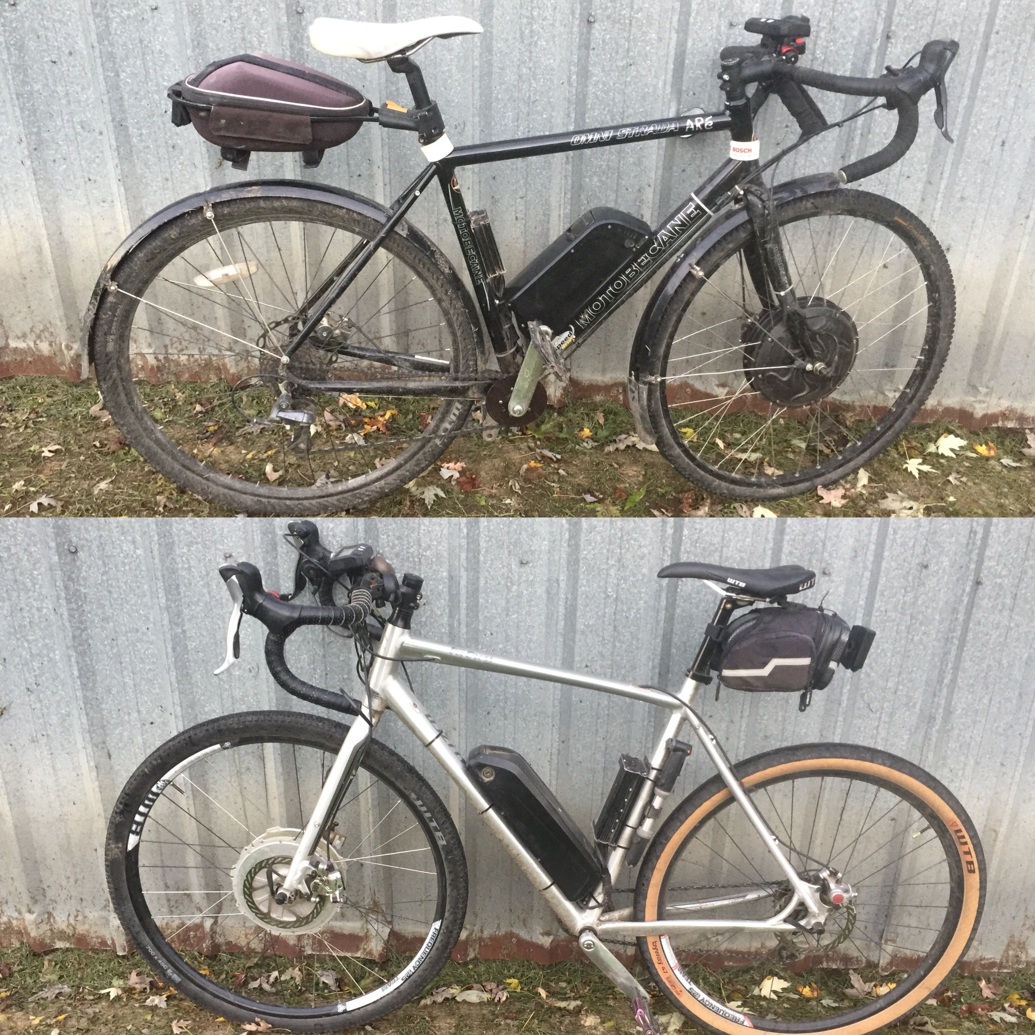

I have two drop bar bikes with 45c tires @ 35psi with front hub motors.
The black bike at that time of the previous post was set up 48v/25A and the silver bike 52v/20A so performance is pretty close, however I use Schlumpf drives on them and the black one has a Speed Drive which has an equivalent 44.5t/11 and that is the one I used for the stats in the first post. The second was done on the silver bike that has a High Speed Drive that has an equivalent 60t/11 and so better pedal input at speeds above 28mph which is where the first bike starts to hamster.
I weigh 195 and both batteries are about 520wh or close to it and it took all the battery to do the runs. I now use a 52v/780wh 21700 battery but haven't given that a speed test as I don't have a comparable track where I live now and quite frankly I haven't done one since the 30mph run and now go for range/speed which I average around 15wh/mi and am happy enough with and rarely average over 20 due to elevation gain and stop and goes and riding alot on sand/gravel and pavé surfaces.
I don't use PAS but have a quality cruise control feature as well as the ability to set my watt limit at 250/500/750/1000w with the push of a button and pedal in whatever gear I deem appropriate. The Cycle Analyst is a great unit in that it has many ways to configure your system and as you suggest gives you all the relevant info you need and with a little simple math going in your head to pass the time you can be very exact as to your distance traveled rather than having a computer do the job for you and it helps to pass the time as well. I find myself for my style of riding to use mainly the 500w selection and rarely if ever use the 1000w mode.

Really nice and quality builds. Is there a previous posts where you went in details about how either bike was set up ? ( not sure how the front hub fitted in the fork with the disc breaks).
I would like to do a build like that on my carbon road bike. The prices that they charge on an e road bike are kind of high and performance is not that great(except the Trek domane e + but that one is 6K and still it has a small battery-500wh).
JRA
#8
Although I could describe in detail how I set up those bike 2 years ago and maybe have on here in the distant past I think it would be more relevant if I detailed what I would do today knowing what I have learned from them and the current state of tech.
First of all I wouldn't change using a front hub motor. They get a really bad rap due to past issues in regards to how they were installed, mostly due to the fact that they were set up without proper torque arm(s) and were overpowered which I would consider anything beyond 1000w to be. My experience using that size motor in both aluminum and carbon fiber forks properly installed and monitored have provided thousands of miles of riding.
My first hub motor experience was in 2001 and I was attracted to the concept for the front wheel drive potential as well as the ability to swap back into regular mode easily just switching back to the stock wheel and leaving the battery off if I wanted to not have the assist function. Admittedly I have only done this twice over the years but it may be more useful to others and options are always good. The front wheel drive in congress with human pedal input however is a feature I use all the time to my advantage. It really works in soft ground situations as well as climbing the steep gravel logging roads in encounter. I also feel that weight distribution is optimal with the front weighted by the hub, the center weighted by the battery and my weight biased towards the rear when necessary but able to move around and be the pendulum to maintain optimum traction and handling.
That said my build today would use:
Bafang G311: https://www.ebikes.ca/shop/electric-bicycle-kits/bafang-g310-311/front-g311-kit-basic-throttle.html
A weight savings of around 3 3/4lbs over my lighter DD AnyAxle motor and getting the 500w power I find most useful makes me want to go with this. Geared hub motors don't have regen and as much as I use it on my bikes that is mostly because it is there to use and would be the only thing that would change. I would spec the CA3 and thumb throttle as well as the baserunner controller out of the kit format.
The one issue that gripes me about the Bafang and one of the reasons I went with the AnyAxle is that they only come in 36h drilling. This severely limits the rim selection if you want to run tubeless especially. However Velocity does make rims that will work. Also the AnyAxle as it suggests will fit any axle standard from 10QR to 20mm Thruaxle and has a built in torque arm. But the Bafang might be a moot case to someone that wants a higher speed config and the AnyAxle the best option?
Battery: https://ebikemarketplace.com/collec...-sea-viper-21700-cells?variant=16054715908167
This is the battery I am now using mainly because I feel the 2170 cells are worth the extra little investment in that they are able to charge and discharge at a higher rate which means to me that at my usual medium rate will make them more efficient adding wh/mi and also the option of a faster charge and more power on tap via less voltage drop. The standard type case is easy to mount and remove and I know that integrated is the most popular option for "looks and stealth" personally I am more interested in performance and forward ability to upgrade components via open source.
A bit about the cruise control function I prefer. The reason why I choose to not use PAS on my road bikes, although I do prefer TA on my MTB, is that I find having the ability to separate the motor assist from my pedal input to be more natural feeling at the higher cadence I use riding the road and how I like to varying it by gear selection over assist selection. I use a throttle to set my wattage/desired speed and to start off and vary assist output while under way but mostly I run in the set mode whenever possible and concentrate on my desired cadence/physical input. I realize this is counter to what has become the accepted norm but whatever, it works for me.
If someone has to have PAS the above system is able to use a torque sensing bb, as I said options are good.

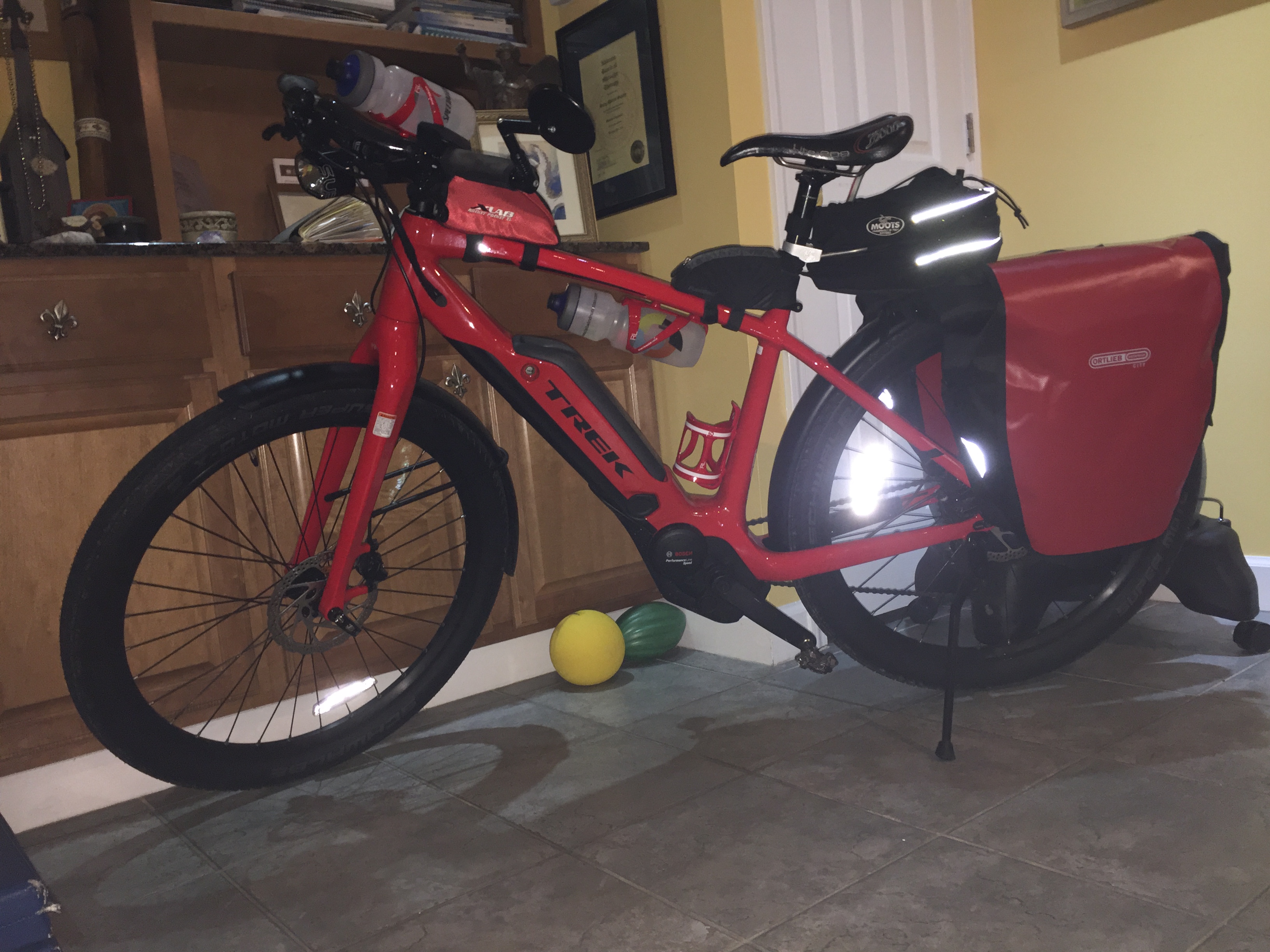

Thank goodness someone extols the virtues of front hubs. I have the range of Bafang mid drives and find myself getting on my Trek Pure flat foot with a 1000W front DD Mxus. Reliable, quick if I want to be and such an easy conversion.
My only concern with the Bafang gear drives is parts access. Bafang is a nightmare for parts access. BUT buying from Grin, ebikes.ca solves that issue. AND Grin's custom touches and controllers with a CA2.4 or CA3 just can't be beaten. Often criticized for not having a pretty color display. I find no advantages to any of my color displays and they have none of the features of the Cycle Analysts.
