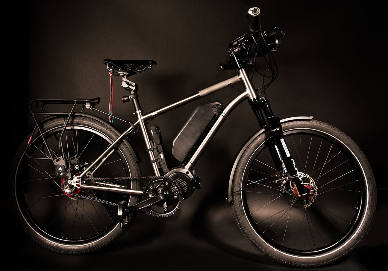

https://wattwagons.com/products/ultimate_commuter_pro
And then my world was turned upside down!
Pros: that 750 watt motor, that can be jail broken of course. I suspect this bike hauls ass.
Belt drive - thats cool
ti frame - should make for a smooth ride
cool brake light
Cons: If the trek is sleek and streamlined then this is the opposite. It's Christmas treed.
External battery
Cables and wires everywhere
Fenders do not look like they will protect from spray like the trek
Questionable range, certainly less than the trek, right...?
6 output for light means that only low power lights will work
I got on the phone with the owner of Watt Wagon today and he was extremely helpful. I asked him about making some mods to the bike, which he was very much obliging.

First of all, the Bafang Ultra on Watt Wagon is likely "de-tuned"
(stock spec on Ultra is 1000W, 160Nm of torque) but people set up their Ultra however they want.
The Ultra is beast. It is physically BIG, so if you want high performance, Watt Wagon.
If you want the clean look, Trek.
Article on Bafang Ultra.
Here are some examples of Bafang Ultra with different settings.
Ravi Kempaiah
Until this morning I had my pre-order in at the Trek store and have been patiently awaiting the arrival of my Allant, but then I found this.
You may want to read these two threads and you may gain some useful information.
Coming back,
Here is some info from someone who was deeply involved in the design process of Wattwagon Ultimate Commuter Pro.
Trek:
Allant-9S is a fantastic bike. Light, sleek and solid componentry and backed by a wonderful company. the fact that you can add an extra 500whr makes it even more appealing. Cool features like the smartphone hub, Kiox display are awesome. Overall, it is fine commuting machine.
Wattwagon
This bike was not built to look cool or sleek. It was designed as a pure performance machine.
For someone in Colorado, this will also be a very low maintenance bike with the gates drive.
There are some factual errors in your analysis:
The light is not run at 6V, rather it is one of the most powerful lights for E-bikes. 1800 lumens output.
Check this out: https://www.lightandmotion.com/shop/bike-lights/lights-for-e-bikes/seda-1800-e-bike
On par with M99 Pro (not the M99 mini pro).
as @PDoz mentioned, Rohloff hub itself costs over $1500 and is extremely durable in all conditions. It may outlast many other components on the bike.
It comes standard with Brooks Imperial saddle, which is the gold standard for long distance trekking or Touring.
The battery is 880 whrs, almost 260whr more than the Trek. Even with the power hungry Bafang ultra motor, you can expect 60 miles of range at 20mph avg speed.
Trek's Bosch is lot more conservative in terms of power output but it is smoother than the Ultra.
Bafang ultra can easily maintain 25+mph top speed all day long. When we attempted the record for 24 hours, I was pushing the bike at 25+ mph for almost 16 hours continuously and it DID NOT heatup whatsoever and that says something.
Finally, it comes with the most advanced charger. Vastly more advanced than the Bosch charger.
Charger itself goes for $300 and will charge the battery to 80% in 2 hours flat. This will also prolong the life of the battery.

Thank you for your input. I agree with everything you’ve listed but you are the one mistaken with regards to lighting as the Bafang In fact has a 6V lighting output as per the lengthy discussion I had with Pushkar regarding this issue. This greatly limits the lights that can be used. One thing that I would like on an ebike would be a high quality German made light such as a Supernova or a Lupine. I have experience with Seca and their quality is not in the same league as the German made lights. Also he is no longer using the Seca for quality reasons. No surprise as a 125$ light that puts out 1800 lumens seems a little too good to be true.

I'm left wondering one thing. With your skill set, why don't you build your own? Spec everything out exactly as you want it, then build it with the kind of workmanship only somebody that enjoys such things is able to muster up....
Cables could be tidied up on the front of the Wattwagon in just a few minutes....
Personally, I think a CF frame could be more trouble than it's worth.

On paper commuter pro is twice the bicycle allant+ is (ti frame, rohloff with carbon belt, high end fork (it may be suntour but it is one of their high end ones), higher capacity battery, powerful motor, brooks saddle , $250 seatpost suspension etc.).
My only concern would be durability of Bafang Ultra but Ravi stated that it is durable. In terms of integration it could have been better but it is not that bad. Also Allant9+ seems too heavy for a carbon frame , a misprint maybe ?
Ravi Kempaiah
You are right, Bafang only has 6V output and hence @pushkar purchased a step-down converter from Grin and wired the SECA 1800 directly to the battery.
Moving forward, if he is not using that light, it is a shame. A powerful light is a must-have for E-bike commute.
Not because of quality reasons but the issue of extra wiring that goes into converting the 52V battery voltage to 12V to the SECA.
Actually, I was the one who insisted on using this light and that is how it got spec'ed in the first place.
This adds extra labor and material cost.
The light is fantastic. To be honest, I am a big fan of Supernova lights but a decent light that doesn't have batteries should not $500.

front wheel
front wheel
We can't give you a warm blanket on a cold night, but we can give you a touring rim that won't leave you stranded. The front wheel has a tubeless ready Velocity Cliffhanger rim. A generous internal rim width allows more tire contact with the road which supports you and your gear more safely and comfortably than conventional narrow rims. We have paired this with an excellent Hope Pro 4 hub. The Hope Pro is a beautifully crafted CNC'd 32H boost hub, with increased flange diameter to give you better wheel stiffness. This combination makes for a very strong touring-rated wheel, significantly increasing the life of the wheel, and reducing wheel maintenance.
rear wheel
rear wheel
The rear wheel features the a 36H variant of the same rim paired with the gold standard of internal gear hubs- the gorgeous Rohloff Speedhub.
Gear shifting is completed via an easy-to-use twist shifter. As the chain does not have to move between sprockets, shifting works out to be quicker and more consistent than a regular drivetrain. Rohloff hubs have a bigger shell, resulting in shorter spokes and therefore a stronger wheel for any given wheel size. The rear wheel is designed to carry the bulk of the rider and pannier weight without any issues!
drive train
drive train
The beautiful Carbon Gates Drive completes the drive train. We have a 55T front chainring, and an expedition rated 19T rear cog. Belts require little to no drivetrain maintenance and don’t need to be lubricated. The belt drive is essentially impervious to road grime and weather, and will not rust if you leave them in the rain. The Carbon Gates Drive gives us a smooth, near silent, maintenance free ride. You can expect the belts to last 5000+ miles between replacements.
motor
motor
The Bafang Ultra is an awesome torque sensing motor powering the Ultimate Commuter Pro. It has been factory tuned to 750W, providing upto 160Nm of torque and the most powerful bike path legal ebike in the US. We have worked with Bafang to tweak the motor and performance, making it a really fun ebike to ride.
battery
battery
We have an amazing 52V / 880Wh battery from EM3EV powering the Ultimate Commuter Pro. EM3EV is known for providing excellent quality batteries that will last you for thousands of charging cycles with proper battery care. They use top quality cells, and the battery pack is extremely weather-proof. The pack also comes with a lock/key to secure your battery both on and off the frame. You can do over 70 miles of riding on at level 1 pedal assist, and 45-50 miles with a level 3 pedal assist.
supercharger
supercharger
The grin satiator is a supercharger you want to use for your ebikes. This programmable charger can fill up the 880Wh battery in 2 hours flat! The charger comes with 3 built in profiles and a programming cable. You never have to wait to have fun.
pedals
pedals
Crank Brothers Stamp 2 pedals are built for commuters.
Whether you use sneakers, vans, boot, or oxfords, you will always feel confident about the grip and support. No more scuffing or slipping.
handlebar
handlebar
We chose a gentle sloping loop bar in the Origin8 Strongbow.
The strongbow provides ample real-estate for all your peripherals, while providing a great riding position. An excellent handlebar for commuters.
brakes
brakes
Maximum braking performance for any road conditions. The MT5e has an integrated switch for motor and brake light.
The high braking force of 4 pistons and its fine modulation make the MT5e a sure-footed companion. We have paired these with the 180mm rotors both front and back.
grips
grips
Ergon GP1 has set the standard for commuting grips.
Excellent all weather performance, excellent palm support, and an even better vibration protection. This is a dream grip for commuters.
lights
lights
The Light and Motion Seca 1800 with 1800 lumens is the most powerful ebike light available today. The Seca works as a DRL - daytime running light - controlled and connected directly from the battery. It is always on when you are riding, ensuring you are always visible to oncoming traffic. You can select from 3 light modes - flashing, low beam, and a high beam. Light and Motion Tuck is the rear light on the bike. It works not only as a traditional tail light, but is also wired to work with the brakes!
Over50
