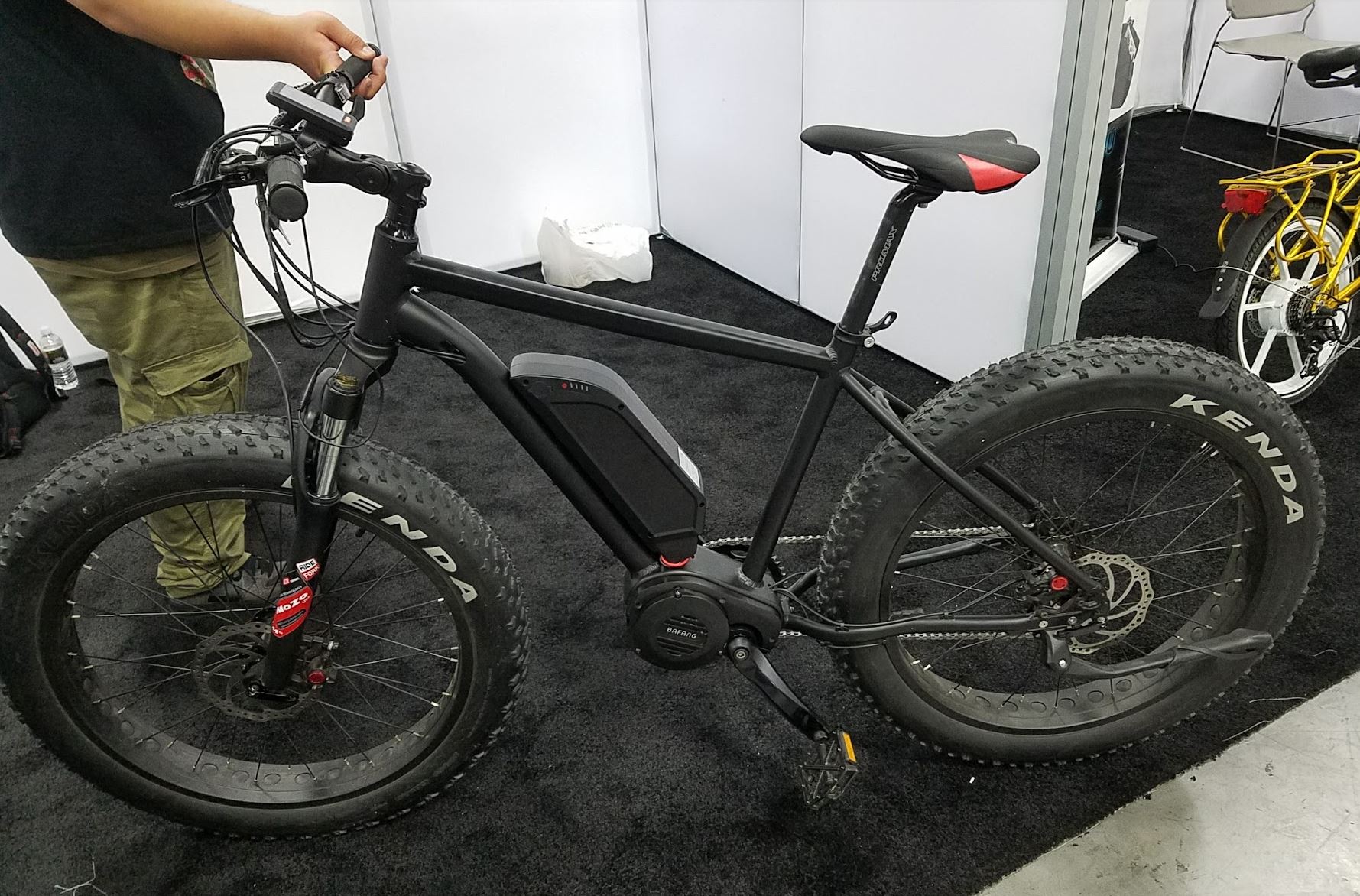

I got to ride the bike and snapped a chain.
Too powerful at 1000W. The programming wasn't set right and it was very torquey off the line.

Yes, it can be dialed down to 750W.
I felt the drive wasn't as smooth Bosch or Brose. Although the torque kicked in better than the BBS-HD, it did not cutoff exactly when I stopped pedaling and it was a little harsh on the cassettes.
I could tell you that it was quite powerful and with a bit more tuning at the firmware level, it could be made into a powerhouse of an E-bike engine.
The first iteration is always going to be quite buggy. I hope by mid-2017, all the kinks would be ironed out.

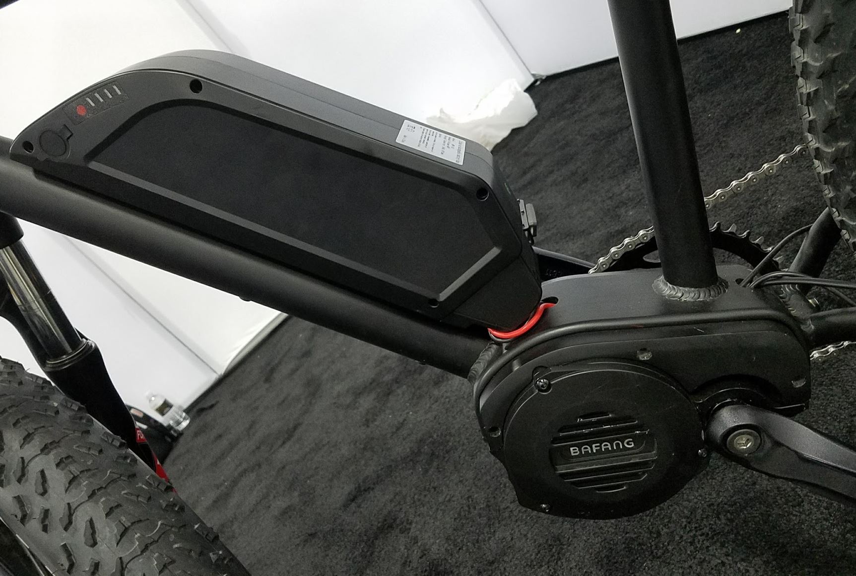

Curious, I don't see anything in that link that indicates that this is the torque sensing motor; does look like a geared motor which would be different. Did see a torque sensing motor design by Bafang for e-RAD at Interbike and this will be available in 2017 as a kit.
Ravi Kempaiah

To answer your question, I tested the Torque sensing Bafang motor and it had a lot of power to it but it lacked the finesse.
I will update this thread once the prototype is complete.
