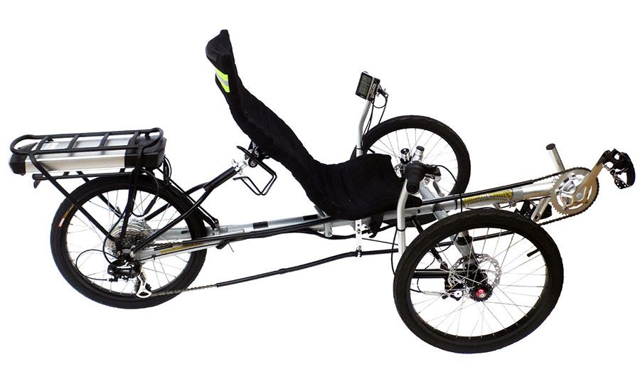

May be we can share this here. Izip USA (Accell) is coming up with mid-drive Trike!
A lot of the existing trikes have front wheel drive and makes it difficult to get traction. A mid-drive on a trike would be ideal to make use of the gearing and all three wheels.
