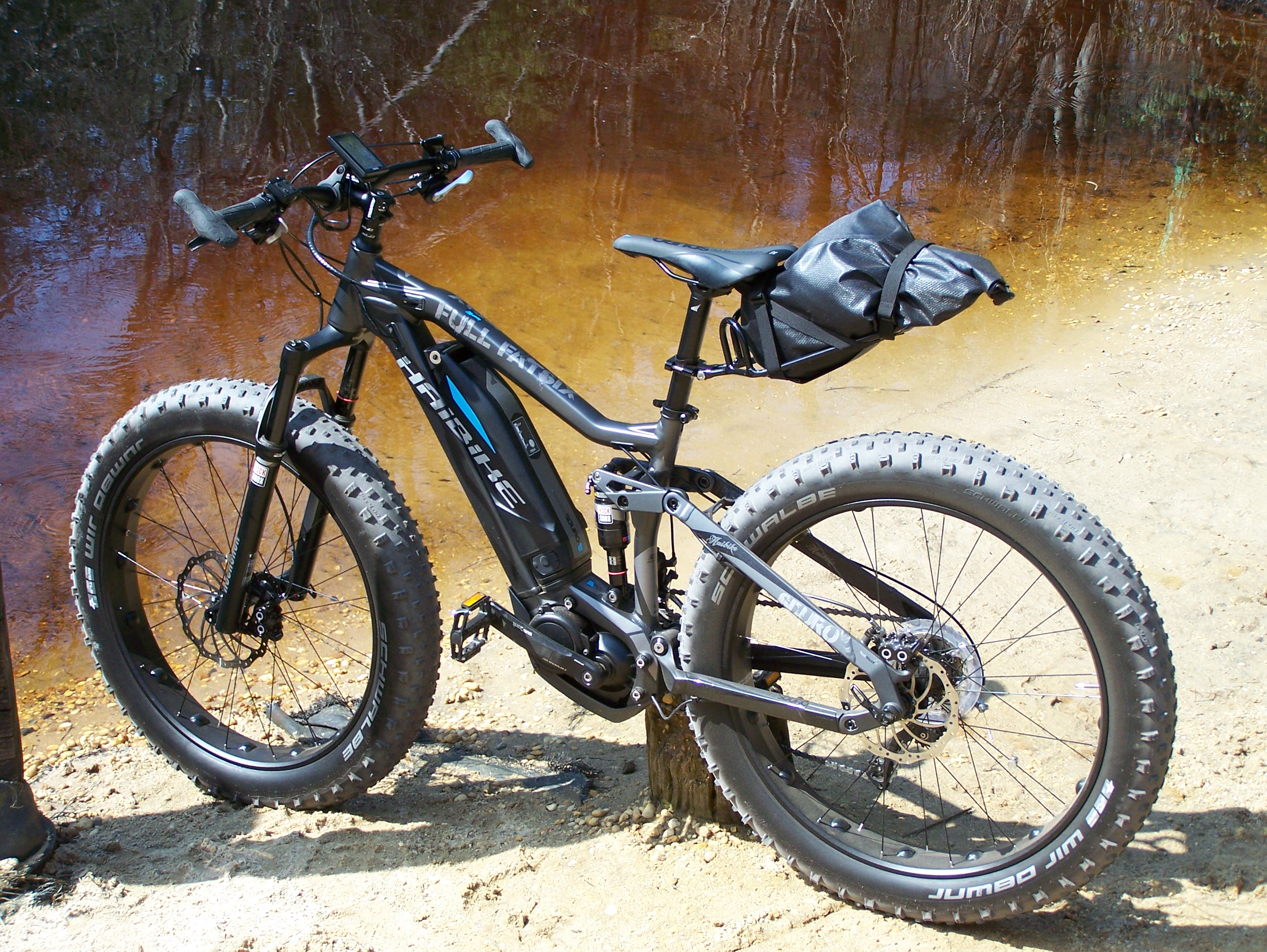

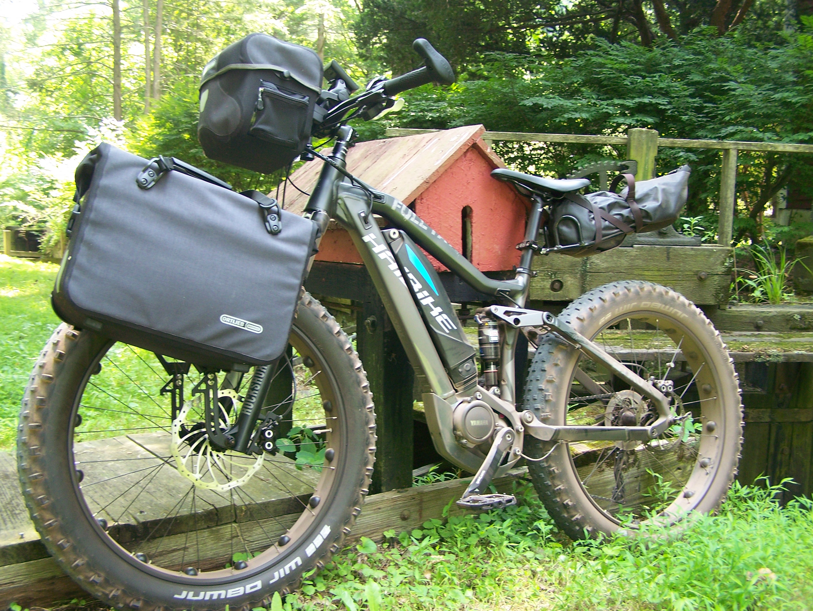

Haibike Full FatSix owner here; coming up on 6 thousand miles on the odometer of the Full FatSix. Absolutely no issues with anything on the Yamaha PW drive system. Ever. 12 months of the year riding, save for when the road salt gets put down on the roads that lead up to my trails.

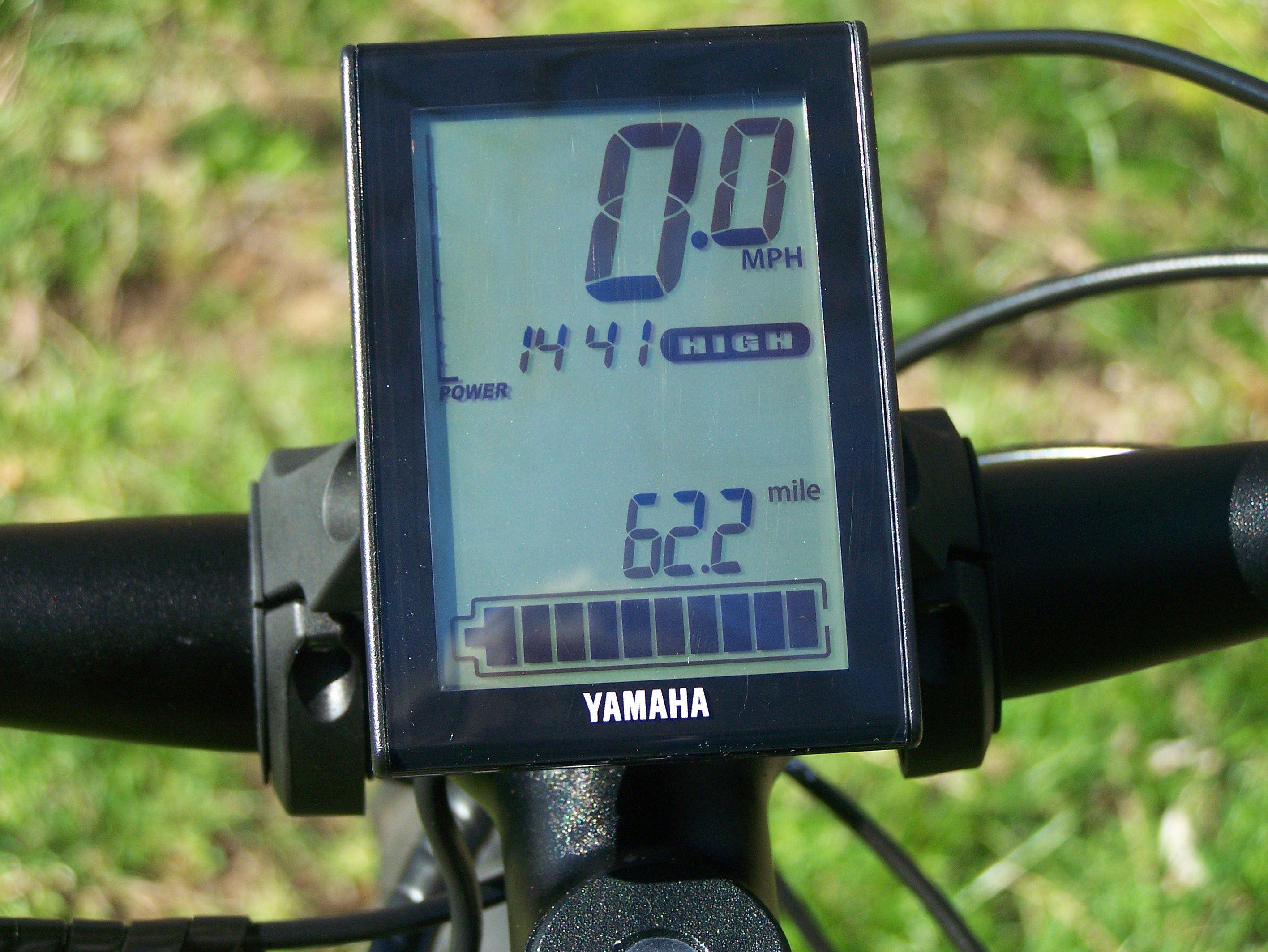

I'm not bashful about using High power either, and I found that Yamaha's predictor of getting 43 miles out of a full battery charge on High power is spot on using water level riding and minimal elevation gain. The same for the other predicted mileages in the Standard, Eco and +Eco settings, too. Consistent mileage predictors, bullet proof drive and battery.
I began riding the Full FatSix exclusively in March, 2017. My usual ride is a twenty miler, in High power. In early summer, 2018, I did a 95 mile run on this bike, using a combination of all power settings, but mainly in the ECO and +ECO settings to get me out and back home. Rolling up into the driveway, using these power settings, I still had 18% power remaining in the battery.
Speaking of the battery, after my 20 mile run using HIGH power, I will have about 50 percent battery power remaining, again, this is consistent with the predictors Yamaha built into this drive system, that being 43 miles running on high power or 53 miles on Standard power. Think about it this way: with another battery, here we have a fat tired, dual suspension fat bike capable of doing a century on Standard power.
I believe the Haibike Yamaha displays are the same as what Yamaha uses on their line of ebikes. Giant may be a different story though.
I simply lucked out in buying this bike; that and using Court's great video on the Full FatSix as well as the Bosch powered FatSix as well as his take on the Felt Outfitter, powered by Bosch. I did not have at my disposal a means to test other ebikes out. Other than the Full FatSix, the only other ebike I tried was a skinnier tired Specialized Turbo; offered up by a fellow towpath traveler as he saw my fat tired Specialized Fatboy off trail, resting up on afternoon. It was that "tailwind to the back" feel that got me thinking of an off road fat bike.
Bosch is making some nice drives and their PR is great. Other brands are touting high speeds, high battery watt hours. Meanwhile, Yamaha is plugging along, slow and steady and consistently. Sooner or later, word is gonna get around about their bullet proof drive systems and unparalleled battery mileage.
I'm looking forward to Court reviewing the 2019 Full FatSix 10.0, with the more powerful PW-X drive; when he gets that chance!
