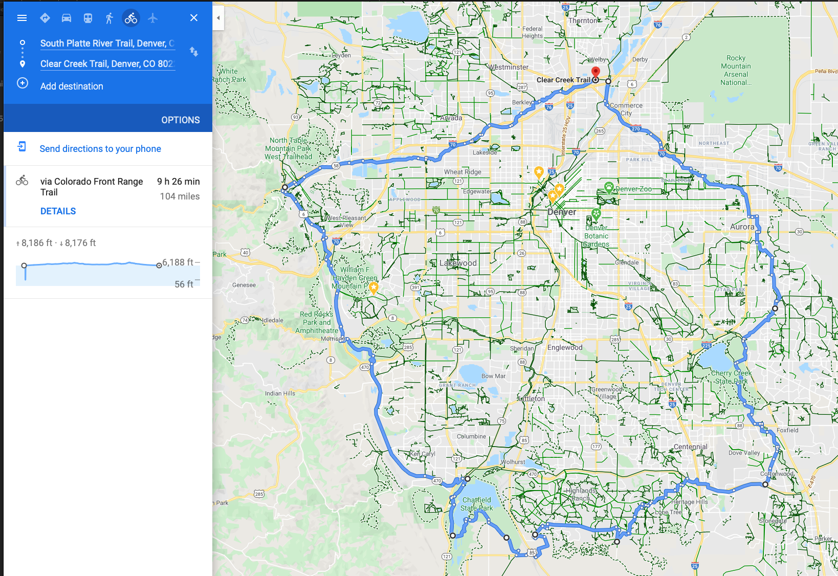

Here's an example 100 mile route around Denver:
