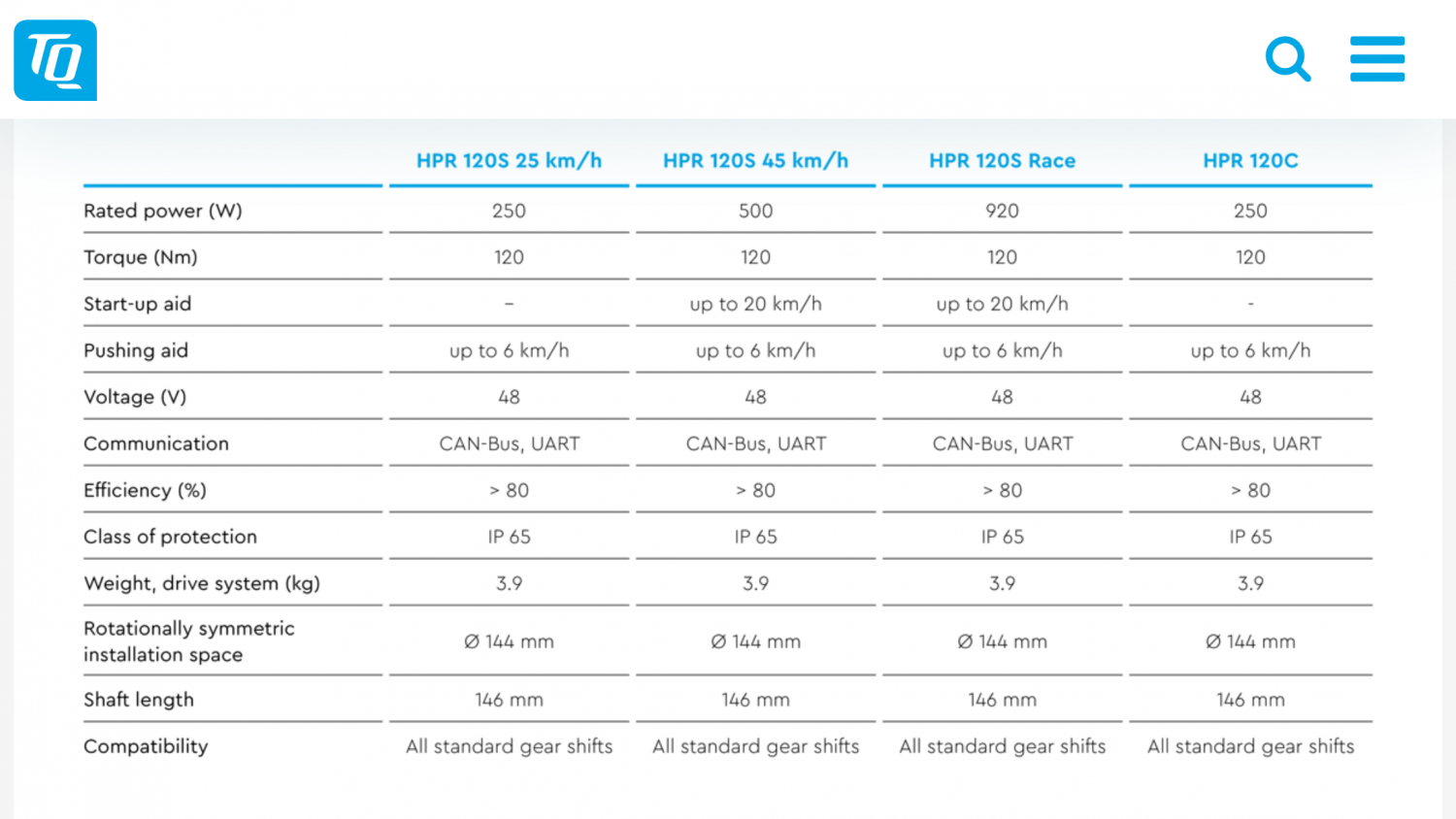

But really at 3.9kg TQ is the clear winner. TQ race version has 920watts.38125
And then Sachs Rs is very close 2nd, is between those 2. But if ebike manufacturers don’t install them then it’s a market manipulation on behalf of Bosch/Brose/Yamaha.

1- Bafang Ultra
2-Tq
3-Sachs
All others are disqualified for not providing enough torque😉
But really at 3.9kg TQ is the clear winner. TQ race version has 920watts.View attachment 38125
