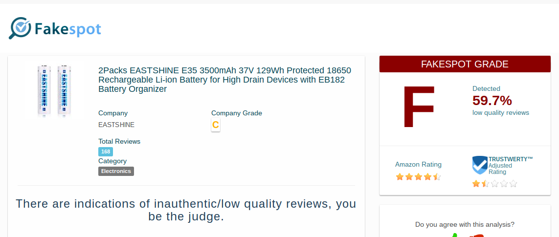

I noticed that among the Deals of the Day on Amazon is a lightning deal for the standard ebike cells (found in packs), the 18650.
The price is not that great. The brand is unknown to me. Buried in the copy they mention SANYO NCR18650GA, but they don't say these are that battery, exactly. They claim both a very high capacity and a very high discharge rate. If they are selling into the Vape market, these things matter.
You can get top quality and brand name cells for much less, but you need to buy 50.
These are fairly dangerous things to keep around. The ad makes it seem like this is the logical choice for your flashlight. These specific batteries have protection circuits designed for consumer users. I don't know if it is a mainstream product, but this is what the vapers are using, along with tactical flashlight owners.
Curiously, there is a website that is devoted to analyzing the quality of reviews on Amazon. I assume they look for patterns. The analysis takes about a minute. A lot of the reviews on Amazon are troubling, with people getting a free sample to review.
Fakespot gives them an "F" for this product, but the company has dozens of products on Amazon.

Well they're calling them "protected" so they aren't GA. I'm really getting close to a 12GA fire cabinet. $350. After seeing the Ebike with the steel vented battery shell it's obvious a fire cabinet would at least save the structure from burning down. LOTS os smoke and fumes, but no raging fire. I'm sure we'll see more events from the vape market.
