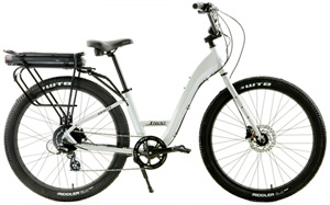

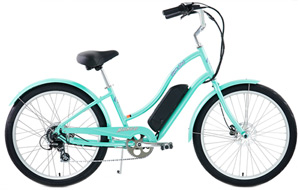

Looking for some help, please confirm if I am headed in the right direction or if I am making any mistakes with my plan to build a custom eBike for my wife.
The desired result is to make something that looks as close to this "Hybrid Cruiser" from SixThreeZero as possible:
2 Major problems with this design is that it's not waterproof and it costs $2K which is nearly double my budget!
So then I noticed that they sell a regular version of this bike but it's not clear if the disc brake mounts are on this version... I sent a message to the manufacturer but they are not taking any calls nor will be answering any email questions for at least another 4-6 weeks... My assumption is that disc brakes are a requirement for a eBike to ride safely on hills which we plan to ride on several hilly hike/bike trail systems in our area which also have low water crossings (paved) which is why we need the bike to be waterproof.
$329 - SixThreeZero EVRY Journey
1st Question... I know there are conversion kits to add disc brakes, but I wan't this to look professional, will I need to weld + paint match or is there a kit that anyone knows that can do this reasonably?
I am also open to the idea of buying a stand alone frame and building the bike from scratch, but I am having a difficult time finding a "Cross Through" frame with integrated disc brake mounts :(
As far as power goes, I plan to re-purpose my EGO 56V battery in similar fashion to what this guy is doing:
Main reason I want to run the EGO battery is because it's essentially waterproof, and I already own this battery for my trimmer/blower ;)
I've read all kinds of reviews on conversion kits and it seems that the most common recommendation is the BaFang BBS02B 48V - 750W where any of the lower power motors tend to burn up if you push more than 48V into them, but the 750W motor can handle the 56V battery that I plan to use.
So this is where I am at, please help me decide if it's worth the hassle adding disc brakes to the EVRY Journey or please help me find something comparable, even if I have to buy all the parts separately.

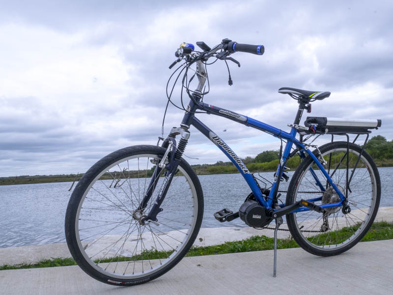

The bigger EGO is a 7.5AH, 14S battery, and would be considered a 52V battery in the ebike world. It peaks at 58.8V at full charge but not for long. It's soon down to 52V, which is half charged. The 7.5AH times 50V puts it around 350 WH nominal. I'd say 300WH real world. At 15 WH/mile, that's around 20 miles.
I've played around with the 40V Ryobi, really a 10S 36V pack on my bikes. One is 80WH and the other is 150WH. Really too small. Works for a 10 mile jaunt,
For discrete controllers used on hubmotor bikes, most every 48V controller will safely run on 52V. I've run one such bike on 52V for several years. My old mid drive Bafang BBSO2 runs fine on 52V packs, but I've read that later refinements have made the latest models problematic. Check what the new ones can handle.
I routinely do 20-40 yards of flooded path, say 4" deep on hubmotors or my BBS02. Never had a motor wash out, but last year I had discrete controllers stop working. Water splashed up into the wiring on two occasions, and seeped inside a a controller on a third. I've gotten more careful about that. Installed fenders, protected the wiring, etc.
How fast are you going to ride a cruiser? This one can barely do 20 mph on 36V with its 250W motor. The fastest it's gone is 26 mph downhill in Colorado, with my wife lightly riding the rim brakes because 26 mph was the speed limit. It was a rail trail, so the uphill was made for trains, 4% grade? The motor did well, plus I had it on 48V anyway, Disk brakes are better, but unless your frame has the lugs, the best you can do is buy a front fork. A good rim brake is fine for recreational bike riding. For dicing it out in traffic, you want disks.

There could be a problem with the Ego on the newer BBS02 motors. I have one from 2016 before the engineers started tweaking it, That's something you'll have to ask the vendor, about the highest voltage allowed.
They may have lowered the operating voltage to manage the warranty claims. You can smoke a mid drive trying to climb a hill in the wrong gear and lugging it at 10 mph. I used to run mine on 52V, but I'm kind to my vehicles. I rarely ran it w/o pedaling aside from a few top speed runs..

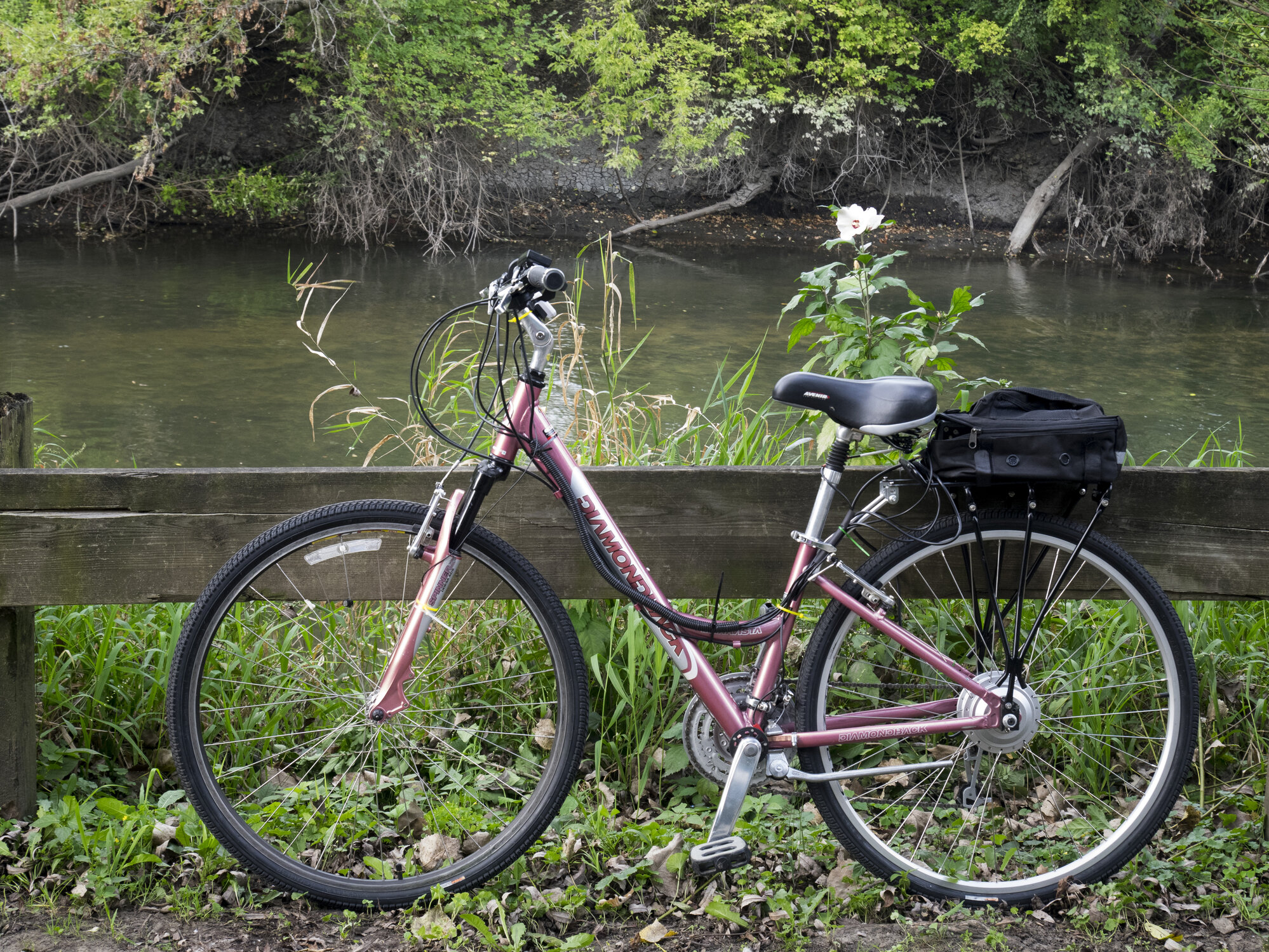

Here are the specs for my Wife's Bike:
1998 Raleigh SC-30
I'm a little concerned that the smallest crank that BaFang offers is 44T and the largest crank on my wife's bike is a 42T, she really only needs the motor so she can keep up with me on the hills where I typically average 10-15mph on the hill climbs, but I rarely use the 42T crank myself, I almost always keep it in the 34T crank which has me thinking that I might need to mill a custom crank so we don't overwork the motor. Here is a typical elevation of the most common 20 mile round trip (out and back) that we would make on the trail system near our house to get a better idea of the demand we will be putting on the motor, hence why I have chosen the mid motor BaFang instead of a rear drive system:

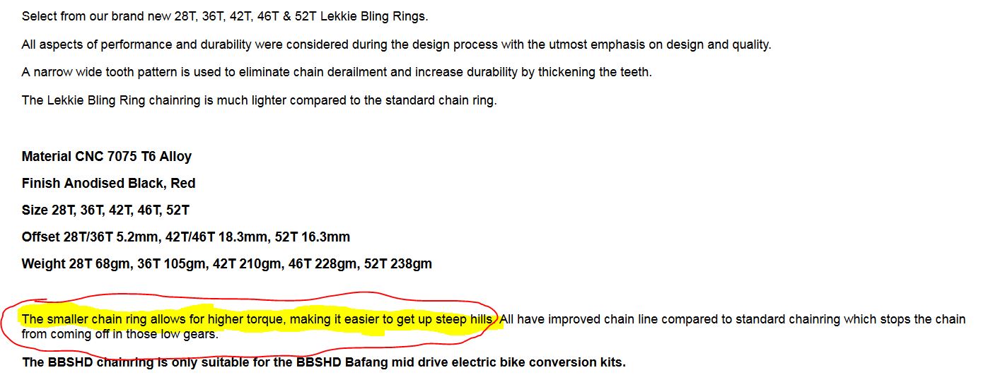

I have found a "Lekkie Bling Ring" which will save me the hassle of having to mill a custom crank, they offer 28T, 36T and 42T where I believe the 36T should be the sweet spot for the hills in my area. Does anyone have any experience with these Lekkie's?
Does it make sense for me to try and match up with the same tooth count that we use the most when pedaling manually up the hills?
She won't be racing, I'm thinking that gearing for hill climbs while sacrificing top speed may be worth the compromise in hopes of extending the longevity of the motor :)

Do you know of any literature on the BBS which states the max grade for climbing hills?
The largest crankset on my wife's bike is 42T, but the smallest available from BBS is 44T which is already a pinch too big to begin with, the options I'm considering with Lekkie are 36T and 42T, where this bike will be used almost always on rolling hills. I've circled the main selling point from Lekkie here, though it's not clear what constitutes a "steep hill":
harryS
It's your money. I'm cheap and didn't see a need to buy any Lekkie stuff. No gear sensor. No programming cable.
I believe I have the 48T bafang gear. With a 34T/14T freewheel, and pedaling like a senior at 60 bpm, that's about 15-16 mph on my 26" beater mid drive. Didn't want to go any smaller. This bike has lugs for a disk caliper. I later spent $60 for a new front wheel and 160mm rotor, and $50 for Avid BB& calipier. It didn't stop much better than the rim brakes on dry road. Does add some bling. Anyway, I'm only going 15 mph.
