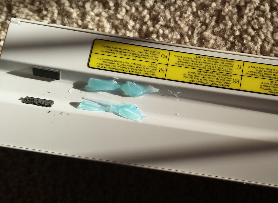

mamerc

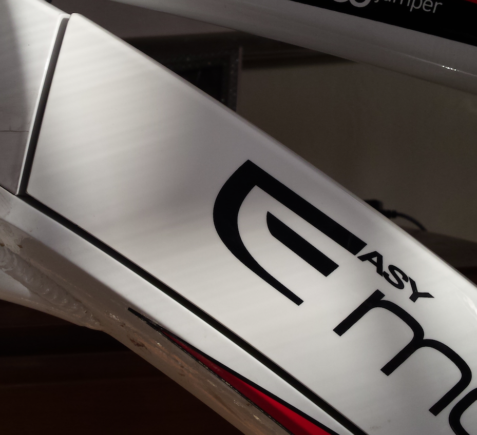

Put two strips of silicon overnight that did it..for now. silicon is not as thick as the picture looks it is. Maybe I'll change them to dots Now about that GAP?

NYC Rider
My bike had that sound from day one. I thought it was the fork for a long time. Just put a few layers of blue tape under the battery, but now the top of the battery is not perfectly flush with the frame, but I don't really care. If I was a perfectionist, I would have gotten more merit raises at work and have been able to afford a Stromer, which by the way I tested at the NY Bike Expo. Its nice but no big woop for double the price of a BH.

Put two strips of silicon overnight that did it..for now. silicon is not as thick as the picture looks it is. Maybe I'll change them to dots Now about that GAP?View attachment 2626View attachment 2627
Check in the woodworking section of your home center for adhesive backed cork, it will soften the rattles, won't compress as much as foam and will last longer. The gap doesn't look as bad to others as to you and nobody will notice if you don't point it out. Good luck with it!
