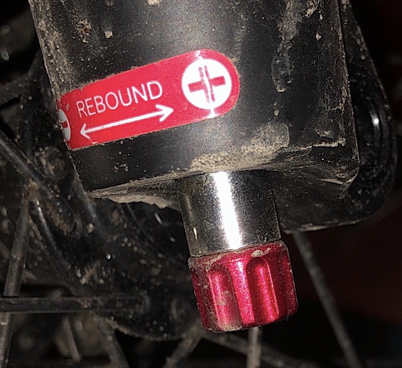

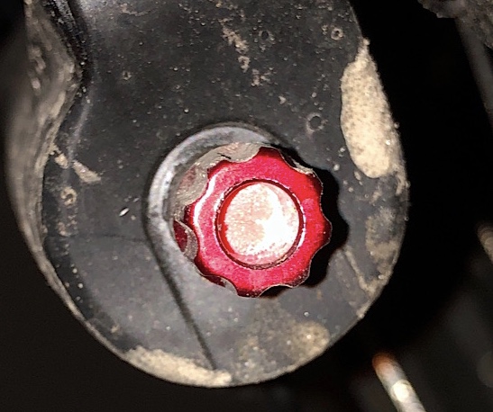

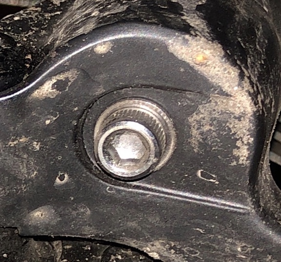

Good thread! Actually, two threads on the same subject have appeared on the Forums.
I have ridden almost 2000 km on my Good Ole Mule (which is equipped with the Suntour Nex sus fork) and I didn't know I could adjust the coils. The fork was set as very hard at the factory. I turned the "screws" anti-clockwise at both sides and, voila!, the e-bike became soft and comfortable...
Thank you for the advices!
PaD
I am in Canada so our bikes are slightly different specs than yours. I now noticed that I also have an air valve under the fork I am assuming that it is also for preload adjustment?
This is what the bottom of my NCX E25 fork looks like. No air valve as far as I can understand.
Right
Left
Edit.
I promise I will clean it next warm day. Today was a fine sunny day, 13-14°C, and I prioritized riding over cleaning:D
