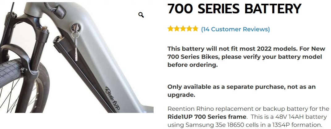

I was notified by Ride1Up today, March 3, that my 700 model is being shipped and will arrive next week.
I immediately logged onto their website to order an extra battery for the 700 as I frequently ride distances requiring two batteries.
On the battery page for the 700, I encountered the following message:
700 SERIES BATTERY
(14 Customer Reviews)
This battery will not fit most 2022 models. For
New 700 Series Bikes, please verify your
battery model before ordering.
I have an email into sales to see what is going on. Has Ride1Up changed what battery the 700 series uses? Are there any other changes to the 2022 700?

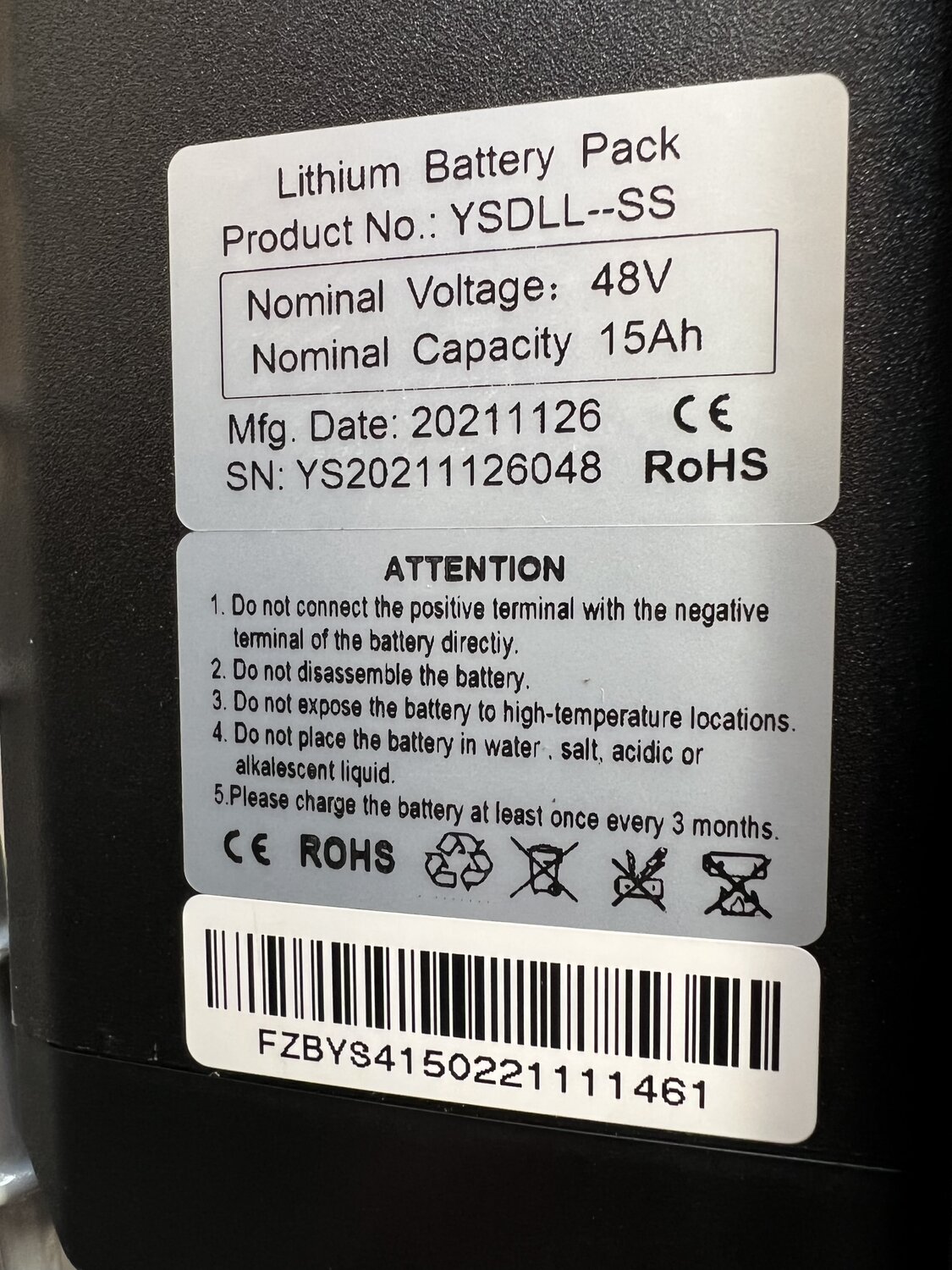

I can confirm the battery change for the newest Ride1Up 700 series. I received the bike today and unpacked everything with the expectation of assembly tomorrow.
Not able to determine the manufacturer or model of my battery other than to report it is now rated for 15AH instead of 14. See the attached photo.

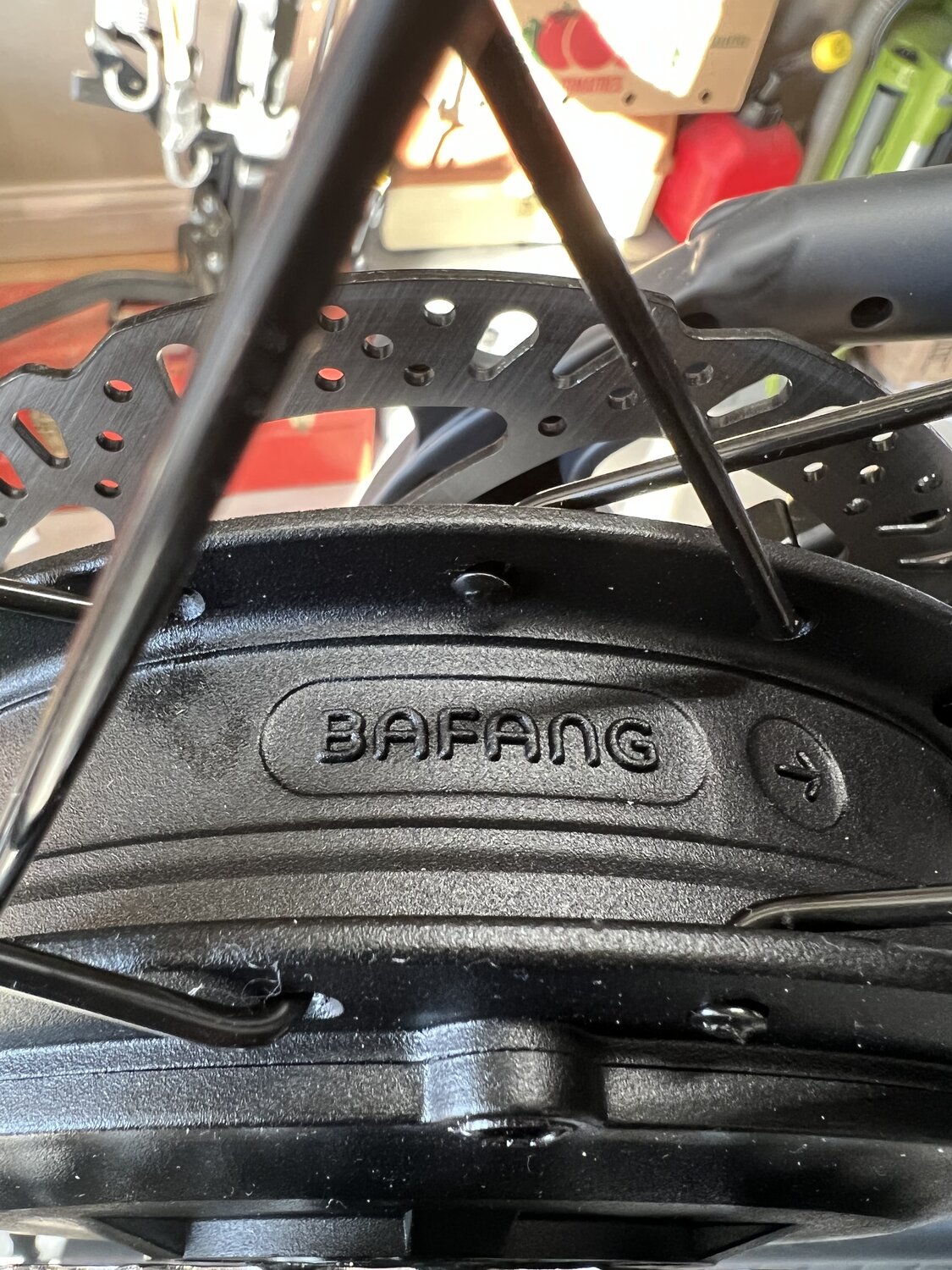

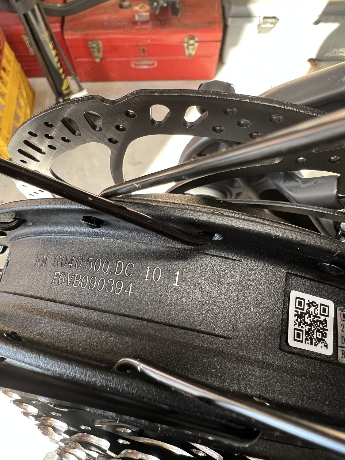

Another change I noted was the motor has changed from a Shengyi to a Bafang. I have attached a couple pics of the motor.

I’ve got a suspicion it’s the same battery used in the new Cafe Cruiser. From the Ride1Up Cafe Cruiser website:
Battery
48V15ah Reention Rhino, 39 x 21700 Samsung Cells
It also shows the Cafe Cruiser to use a 60NM 750 watt sustained Bafang motor and that’s what I’ve got on my new 700 model, not the Shengyi.

It is the same Reention that the Cafe Cruiser uses. Ride1Up told me to order that battery as my 2nd one. It is currently on back order, due to ship in April for $489.00.
They told me the Bafang 500 watt motor is an equal swap for the Shengyi. After a quick ride after assembly tonight the 700ST appears it’s not quite as peppy as my friends 700 with the Shengyi. I will have to ride more next week to confirm that. We’re due for a snowstorm of several inches here in WV over the weekend.

How fast does your bike go?
RM G040 with 10T winding. That's rare. 😲
Timpo
I have googled the Bafang RM G040.500 but I’m Not sure what the 10T winding does.
Generally speaking, lower winding will give you higher max rpm.
Higher winding will give you lower rpm.
I said generally speaking because apparently it's only up to a point, (if you get something like 1T or 100T, it could be a different story)

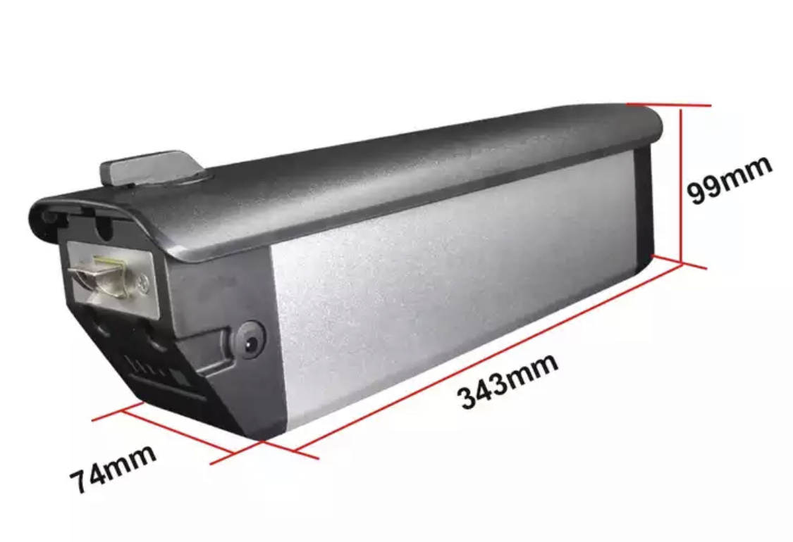

There are 2 sizes of this battery. IR-5 and IR-7. The IR-5 is the original size, it measures like this…
Does the new battery measure the same? I’ll bet that the newer battery will measure longer.

The battery is indeed switched from Reention Rhino IR-5 to IR-7 version on 700 series.
IR-5, 363x74x99m, 52pcs 18650, 48V 14Ah max.
IR-7, 441x74x99mm, 70pcs 18650 or 42pcs 21700, 48V/52V 17.5Ah by 18650, or 48V/52V15Ah by 21700.
IR-21700, 441x80x108mm, 60pcs 21700, 48V/52V 20Ah max by 21700.
(Length is measured as plastic cover length.)
