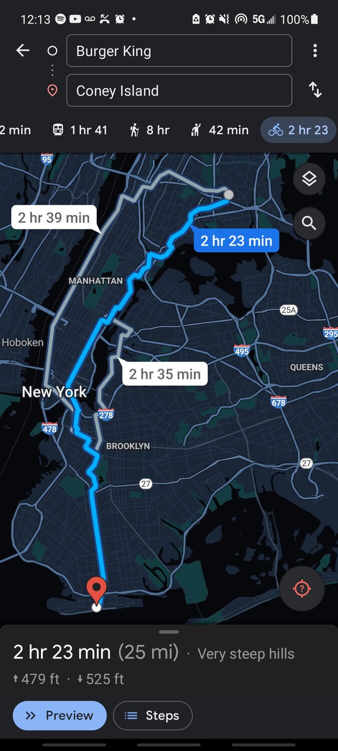

BeltzerNYC
here's a trip I'd like to make with a rear passenger. if I can up the PAS I can make it an 1.5 hours which beats the train. I want to be guaranteed to make the trip and still have the ability to turn down PAS and make side trips on the way back let's say. sometimes something comes up or we get an idea and want to be able to go a few miles off course and not have to worry. ideal would be a NYC-PHL trip (110 miles) on one charge solo but let's see.
