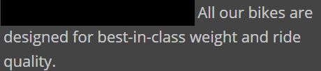

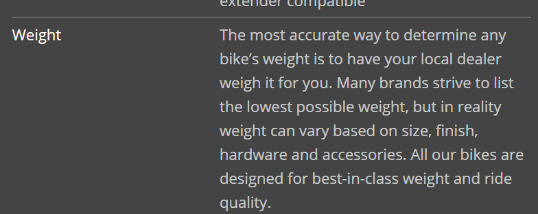

As I tried to indicate - their charts, Specialized charts, have rows for stem length, crank length, seat tube length, sprockets, angles, dangles, etc and then columns of xs, s, m, l, xl, xxl. They could add one more row at the bottom WEIGHT. Weight for each of those sizes. I don't care about the extras. They know their vados from their vado sl's. They know precisely the weight and could publish the info if they wanted in a clear manner with/without accessories.
And Bike Shop weighing is also a bit late. Specialized sells these damn things over the web for delivery to your bike shop. What is the weight????? Oh, we can't possibly publish that top secret specification.
No what we publish is this:
Come on! Seriously. What does the damn thing weigh?

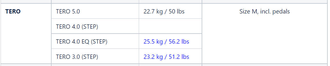

chucker11
@rj cedar
I find that is one thing Specialized seems to hide - Bike weights. What I find meaningless is 2 times or 4 times cyclist's power. Huh! Simply what does the bike weigh? And they conveniently post all of the geometry dimensions for all the sizes and models but can't fit weight into those voluminous charts. They can as easily post WEIGHT. And an * asterisk can point out fenders, lights, etc may add x kg or y ounces.
Here are the Tero weights
