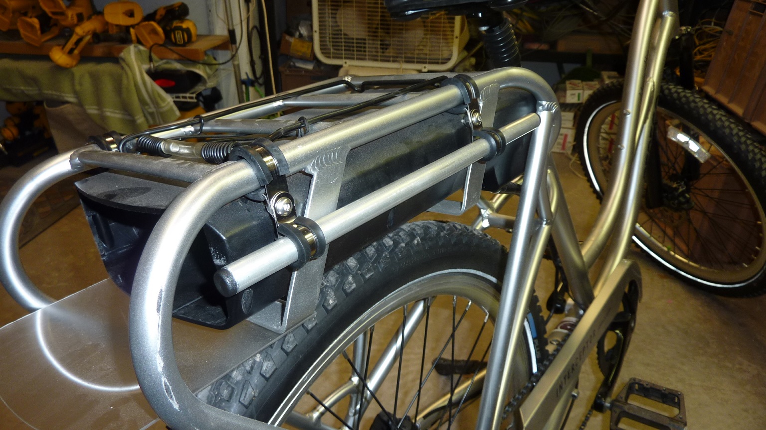

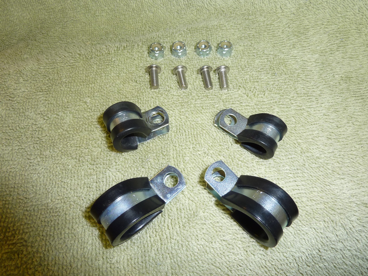

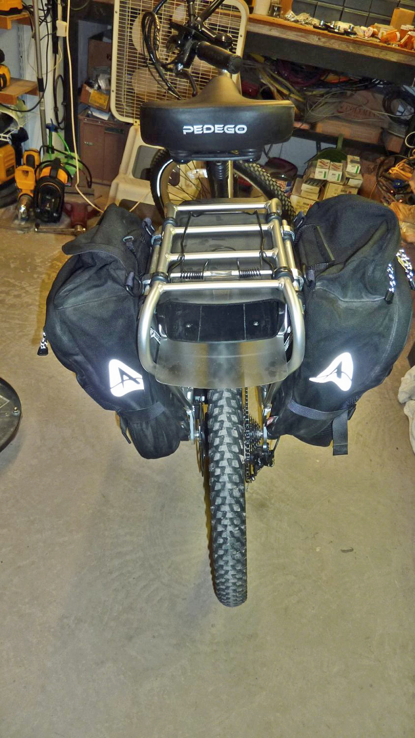

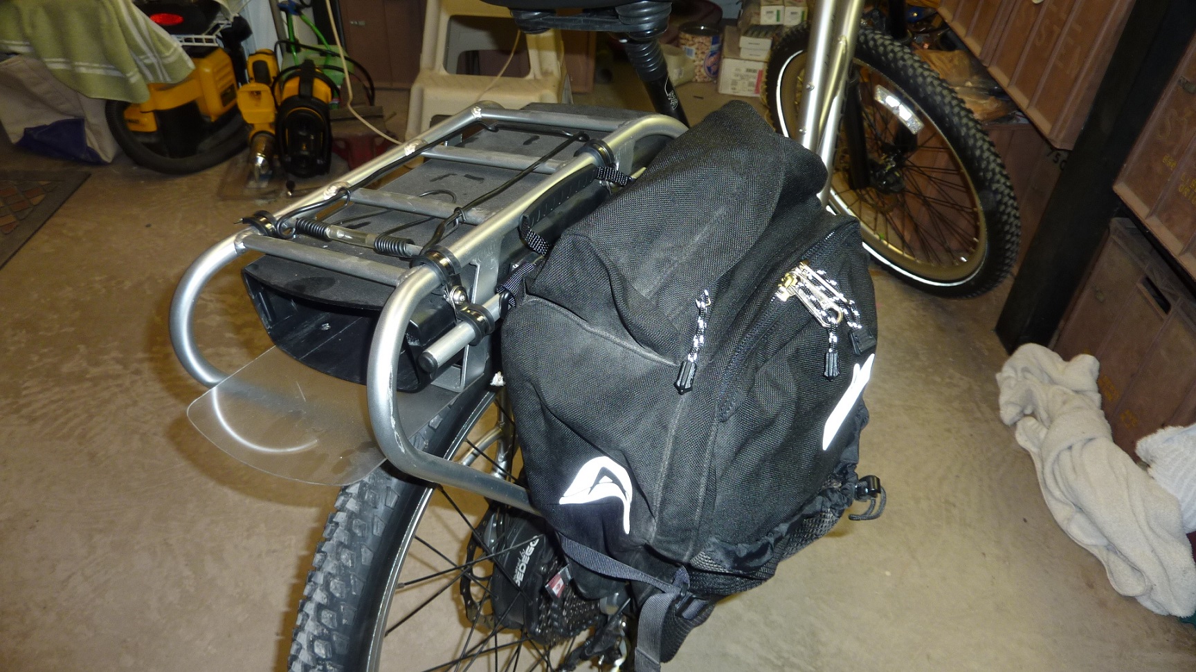

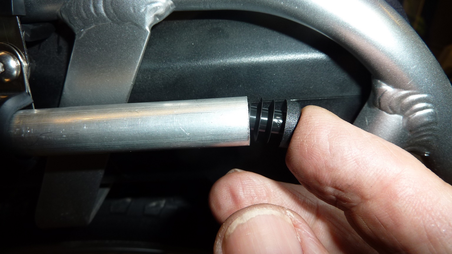

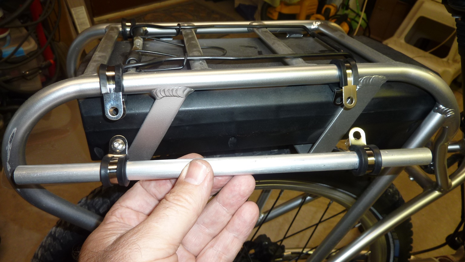

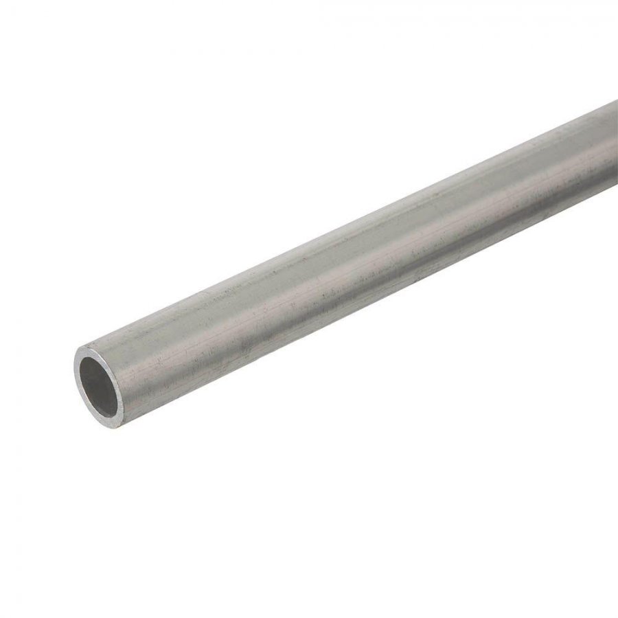

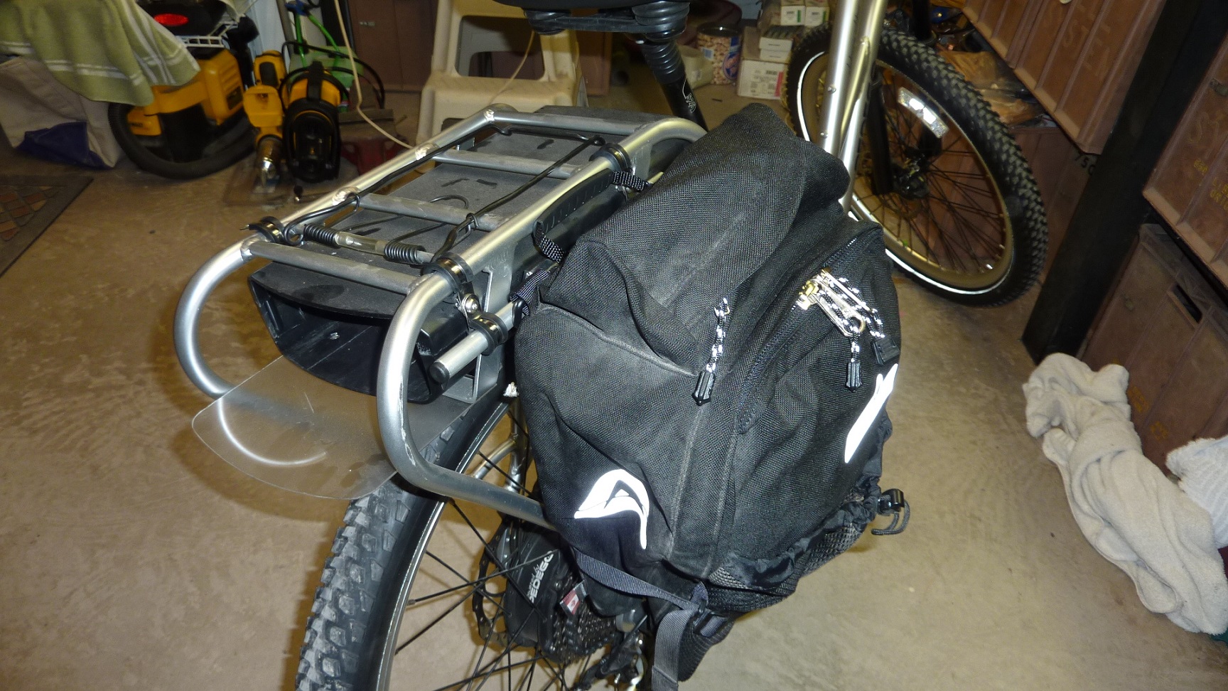

Without seeing your panniers, I'm not sure if this trick will work or not. I was able to make adapters that allow my panniers to fit my rack. They provide a lower rail so the panniers don't interfere with the upper rack rail. I made them from short pieces of .5" aluminum tubing and insulated cable clamps.
It isn't necessary but I used plastic plugs to dress up the ends:
I bought the parts at my local home improvement center but they are also available on Amazon. The total cost was around $10 US.
The adapters are quite strong and I've carried 30# in each pannier without a problem.
In any case, welcome to the forum! I hope this is of some help.

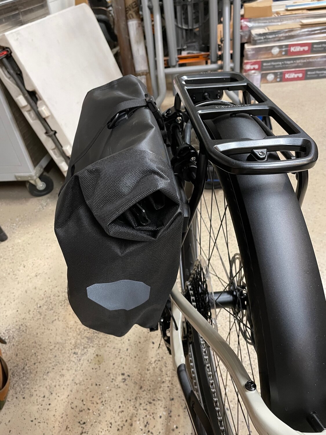

I have an Ortlieb Backroller pannier mounted to the lower crossbar of my new Turbo Vado 5.0 as we speak. It attaches just fine.
I only use one pannier for my work commuting setup. It is a top-load pannier with a big open cargo area where I stuff my work backpack with laptop inside to keep it clean and safe while riding in the rain. I have a Patagonia Refugio daypack that I use as my work bag which has a nice laptop sleeve and is the right size for work. It slips inside the Ortlieb if I don't stuff it too full. I leave the Ortlieb on the bike permanently but then I have indoor secure storage for the bike at work so no worries about theft or meddling with the bike.
The two ideas behind using a backpack inside the pannier for work purposes are (1) the work backpack stays clean and dry here in the rainy Pacific Northwest, and (2) if I need to get groceries on the way home I can pull out the backpack and wear it the rest of the way home while using the now-empty pannier for groceries. I have 3 or 4 grocery stories right on the way home from work so that is convenient.
View attachment 118814 View attachment 118815
View attachment 118821 View attachment 118817 View attachment 118819 View attachment 118820

Thanks for the detailed reply. My rack already has a lower rail so it's more about getting a pannier system where the mounting clips fit in the existing gap between the existing upper and lower rails (I was surprised that the Altura Grid clips didn't). Interesting to see your build though! Thanks.

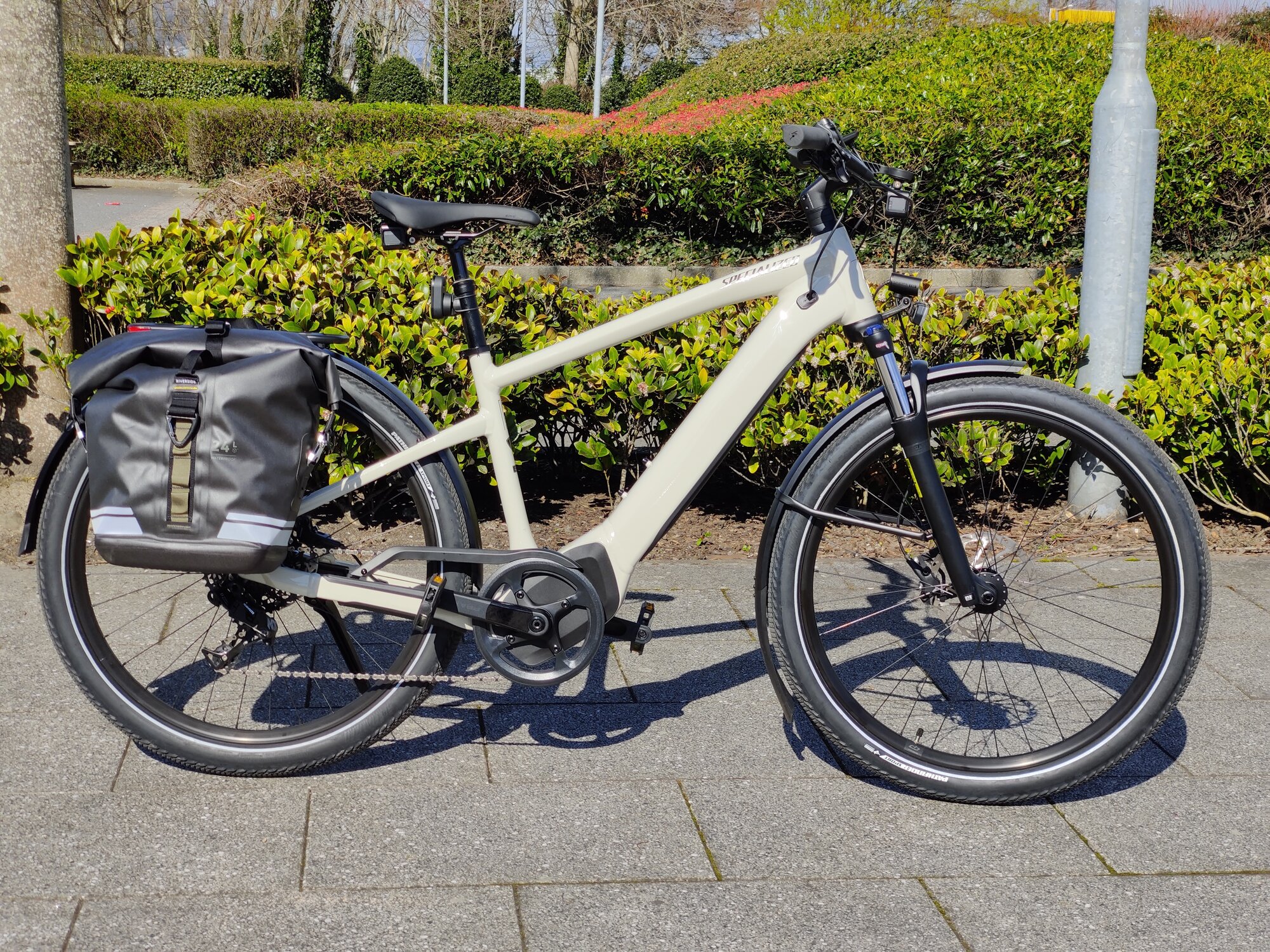

Thanks for the various suggestions.
I bought the following from Decathalon as: they fitted onto the lower rail, were a good size (24l) each, waterproof, very good reflectivity at the base of all 3 outward facing sides, sat low on the rail, had a solid base, and I thought looked well on the bike. (They also have a thin unpadded but suspended internal sleeve that apparently will hold a 13" laptop)
https://www.decathlon.co.uk/p/ipx6-24l-waterproof-touring-pannier-bike-bag/_/R-p-311050?mc=8561752
