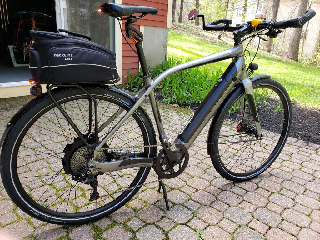

I thought I might attach a few photos of the two bicycles including the most recent driveline changes to the Vado SL.
Here is the 2015 Turbo with 11 spd Shimano 11-42 mech. Ths is the pretty much final configuration of the bike with the exception that I removed the Ergon grips and replaced them with Bontrager ergonomic grips..

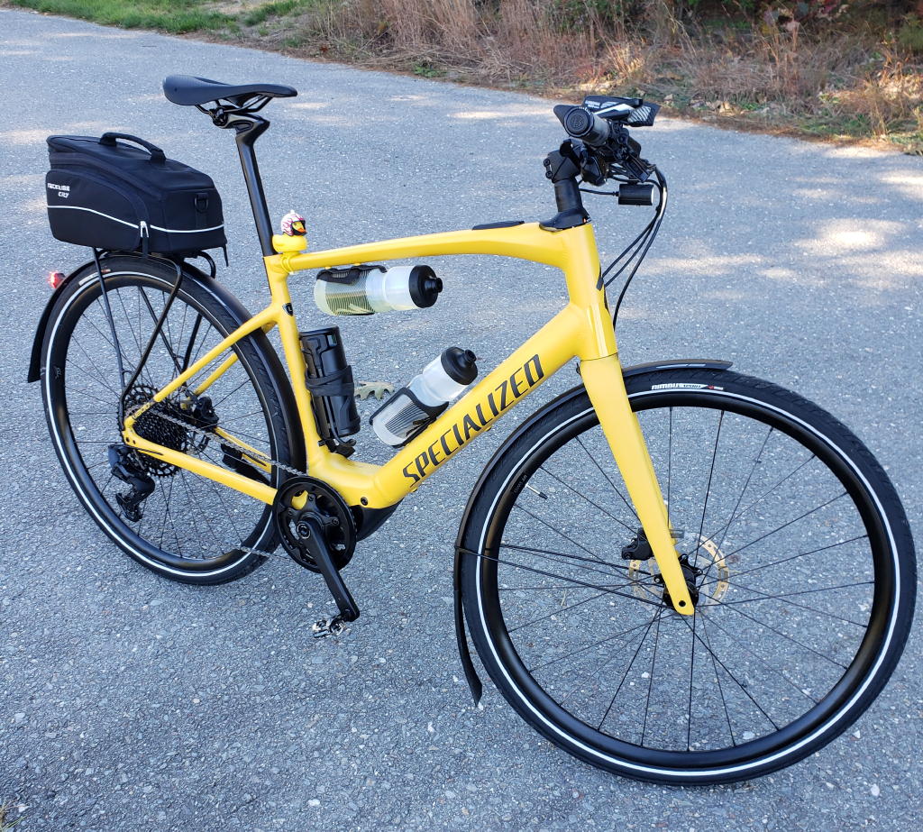

The next picture shows the Vado SL 5.0 EQ minus the most recent driveline changes.

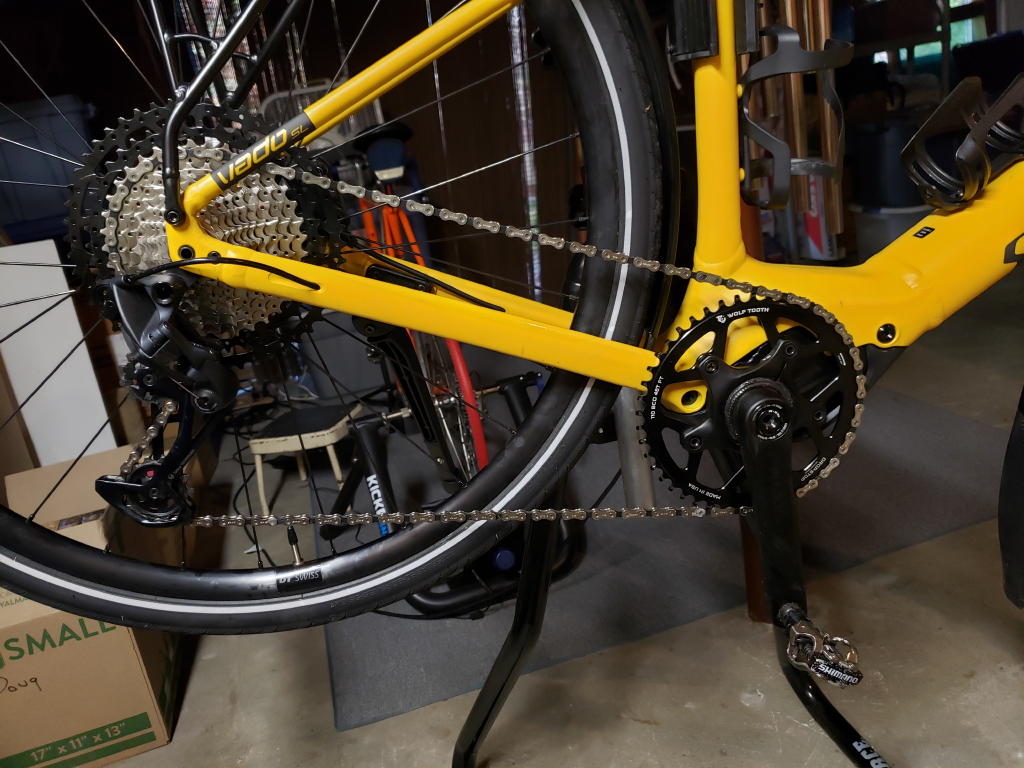

The final picture shows the very recent driveline changes, a 46T Wolf tooth front chainring, a VG Sports 11-50t rear cluster, and a 124 link SRAM GX chain. I did have to add a 0.6 mm shim between the 7th and 8th cog on the cluster since they were too close together causing the chain pins to drag on the 7th gear when running in 8th.

None. I was getting some wear on the SRAM and wanted to get a less expensive replacement to see how it works. Appears fine so far after shimming the 3rd spider. Plus I wanted to new chain, cassette, and chain ring to be worn in together. I know the SRAM cassette will always work fine. If I decide to go for a change in ratios on the cassette, I wouldn't go to an 11-51 or 11-52, but rather would look into seeing if an XD driver freehub could be fitted to the wheel and the use a 10-50 or 10-52.
