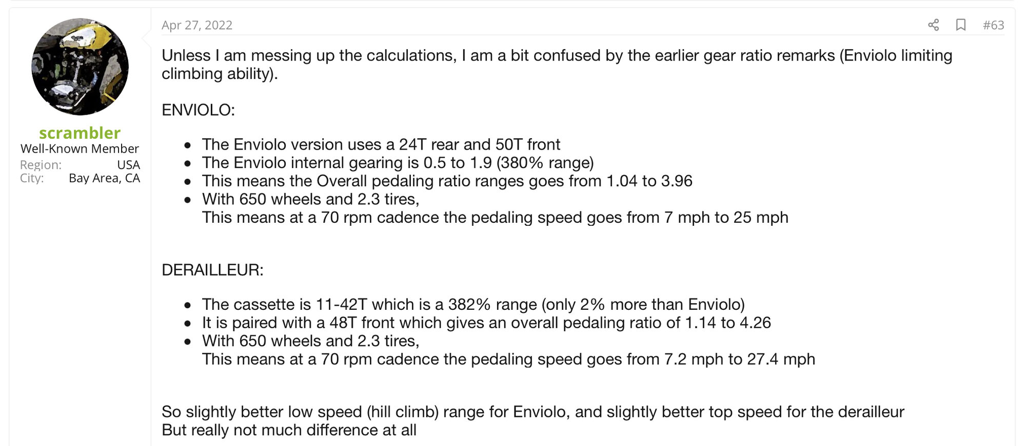

This earlier post gives a good idea of expected speed vs. cadence.

Enviolo offers a cadence to speed calculator for its hubs on their website as well. I’ve had issues with mine, but haven’t confirmed the fix yet. When mine wasn’t acting up I was able to (on a no wind day) hit 29 - 30 on a flat road. Cadence was I think low to mid 80s. For some reason I recall their calculator. Putting our hubs near 83 at 28 mph.
