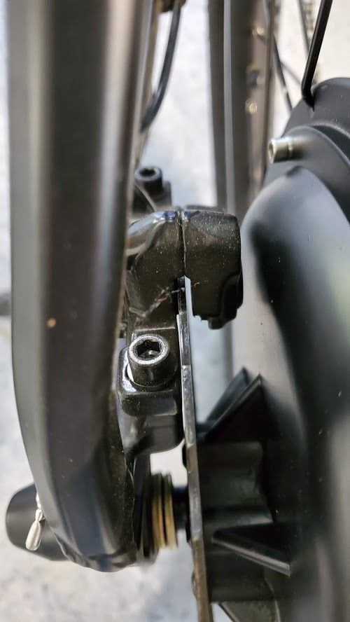

One final thing is that my disc is now rubbing on the pad. It's not alot, but it is enough to where if you spin the wheel, it's not as free as it should be. I'm thinking the only way to really center is, is to add another washer between the motor and the frame, although I already have two in there. Look at the pic to see what I am talking about.

Another way to fix that is to put on a bigger rotor and buy an adapter that moves the caliper out away from any possible interference with the motor. It's not expensive and the bigger rotor gives the brakes more leverage.
I see what you mean, however, the caliper is not interfering with the motor. I may add another washer there to move everything a bit to the right.

Well, I seem to be an idiot. I looked more closely at where the brake assembly mounts to the frame, and low and behold, you can loosen the screws, and side the whole thing a bit. I now have the rotor in the middle of the pads.

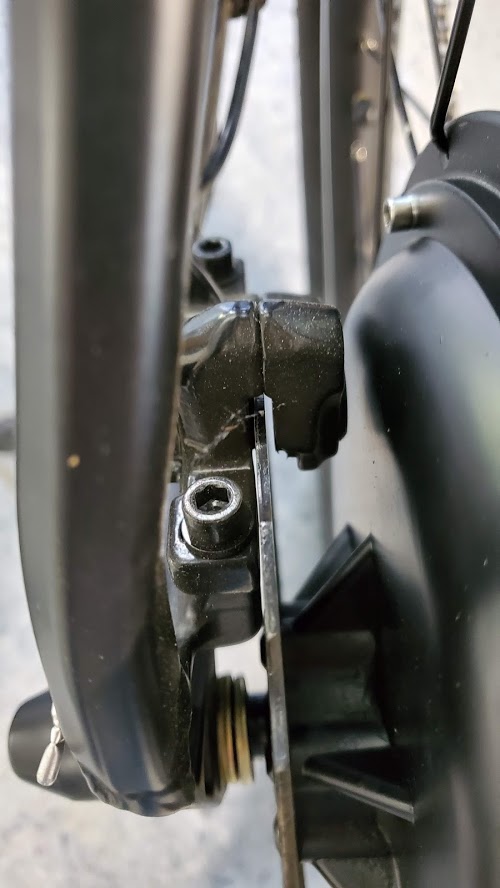

Problem solved. Checked over all the plugs again, and noticed one of the motor phase plugs looked a bit shiny. Went to unplug it, and it wouldn't budge. I cut the plug off, as well as the others, and soldered them. Works fine now.

Better find out why that plug is melted, it is melted isn't it?
Maybe pull it apart and see if the connectors look normal, also keep a watch on that wire for exessive heat.

I cannot pull them apart, and seem to be fused shut. My guess is, when I replaced the ring terminals with the Andersons, I did not get that one crimped well. I did have issues, as the only crimper I have is for Molex trifurcon connectors (I do pinball repair). Anyways, the wire looked fine going into the connector, no melted insulation or anything. I will keep a check on it though.

Ahh that explains the mismatched colors. Seems like a logical explanation, a spark gap in the connector.
