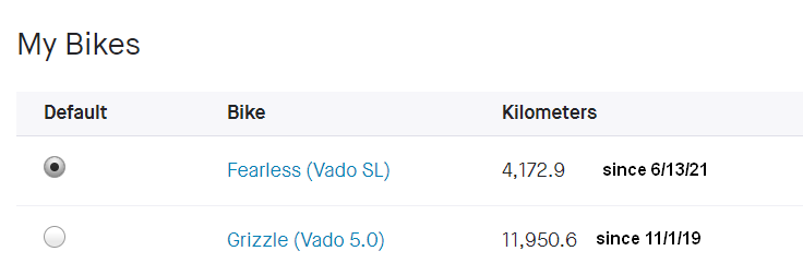

Hi @ebikerr: I made 189 km (117.5 mi) over last weekend on my two different Specialized e-bikes (older Vado 5.0 and a 2020 Vado SL 4.0 EQ), and I plan riding more :) I need to sleep sometimes...

I also used to own a Giant full suspension e-MTB (2,288 km), and a hub-drive motor generic e-bike (3,923 km). I keep these two Specialized e-bikes now.
