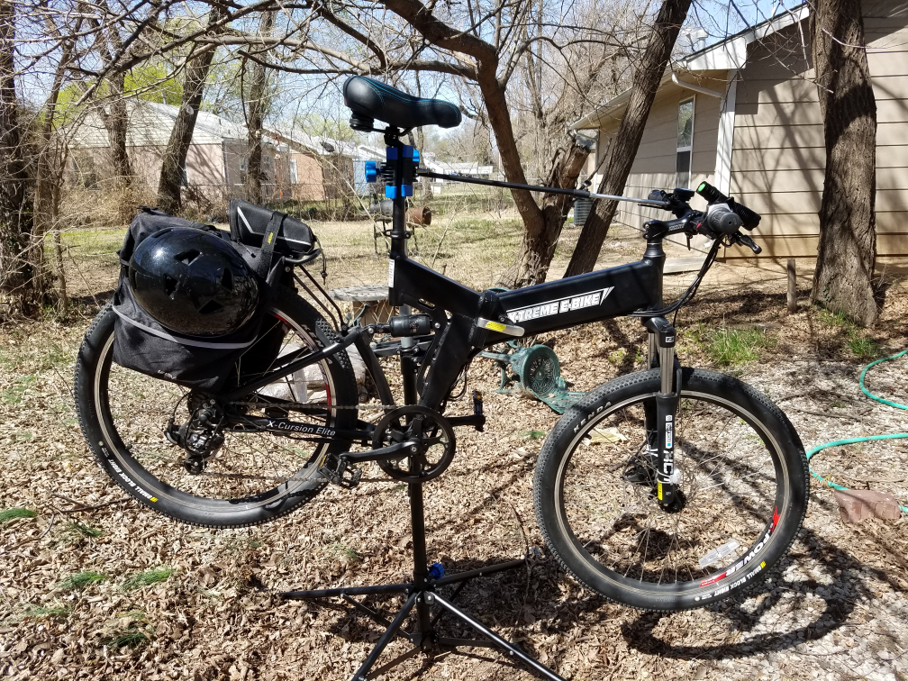

i have the 2018 x-cursion, think 300 or so dollar big box bike with a 300w hub motor kit thrown at it and a custom frame built to accept conversion kits. the frame has great welds, the bicycle parts are standard but cheap.
Cpt.Cream
oh, and support on x-treme scooter stuff isn't that bad, i get a response just to suggestions in a day or so, when i had questions they responded just as fast, and i never gave more than normal priority on their support page. calling someone i think wouldn't work, but they respond pretty good to their support page.
EDIT: although i threw away the warranty the day the box arrived in decent condition and the bike worked. better to upgrade than warranty it.
