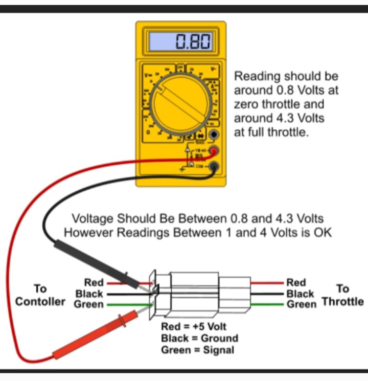

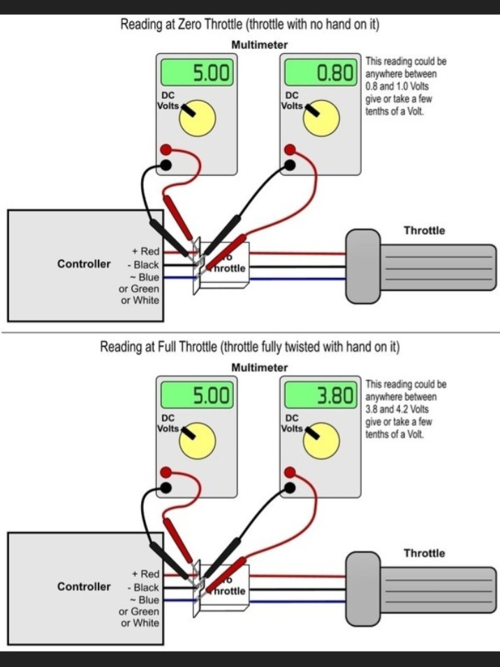

My throttle has multiple wires but according to your diagram I only need to identify the +, -, & signal wires. (3 total) Is that correct?
Here's some more info that should help you identify the wires.

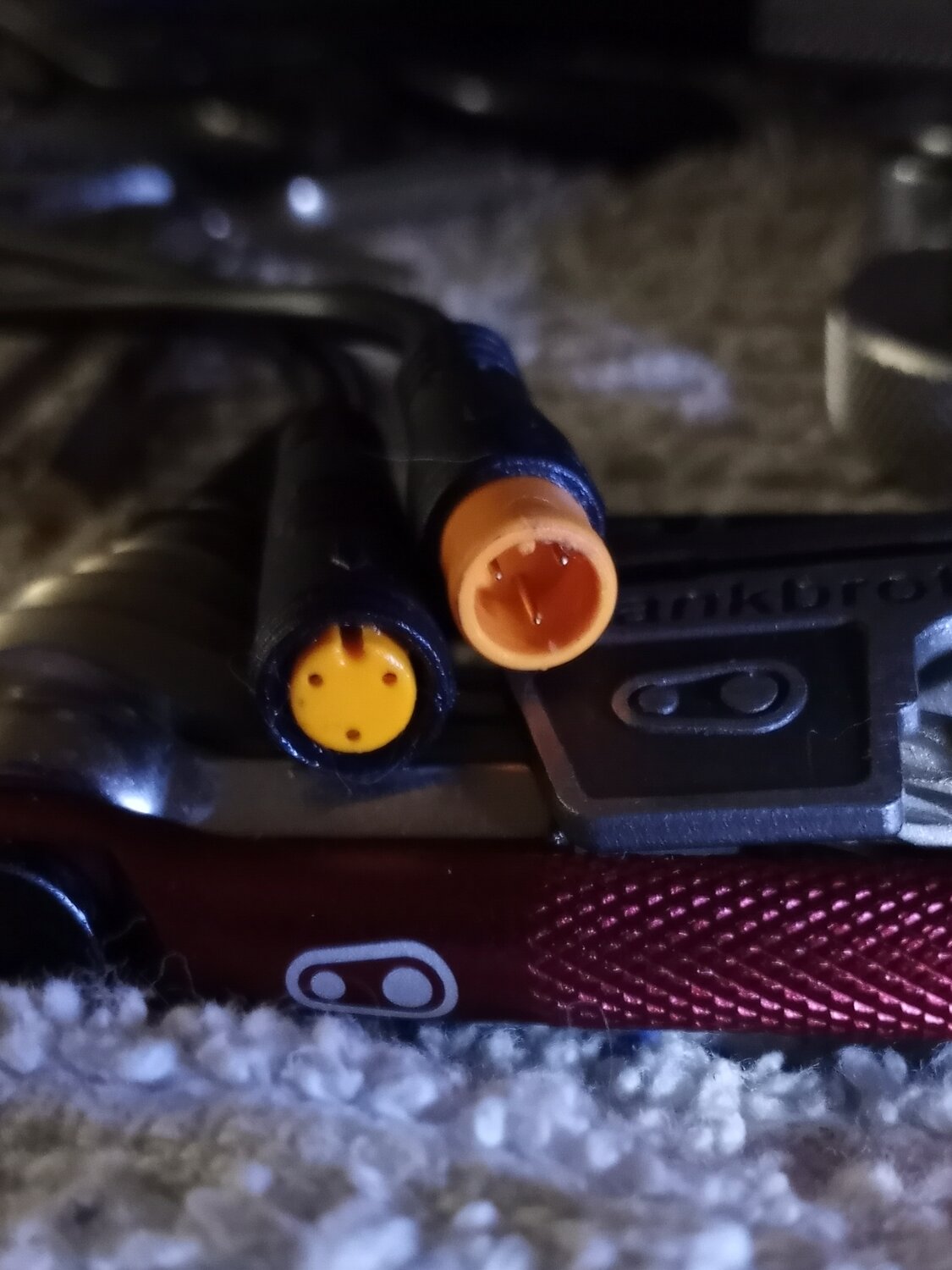

I found out that regular throttles come with both male and female 3 pin julet connectors, and I'm pretty sure that the only difference is the pin configuration and what resistor connects to what pin.

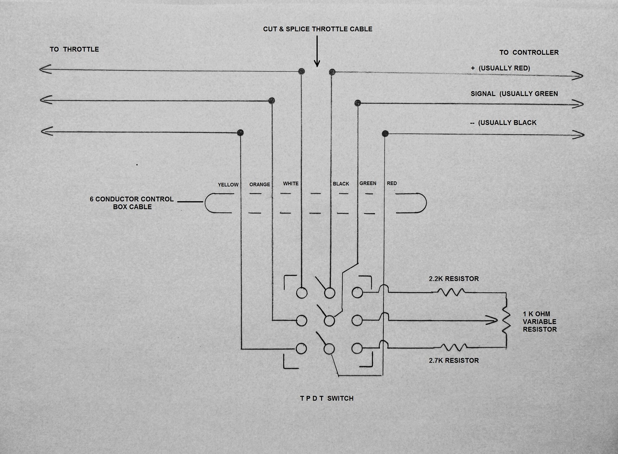

Care should be used when making any connections to the throttle circuit. Wiring faults can cause the bike to go full throttle unexpectedly.
If the project becomes too difficult, you can always use this product on your twist throttle instead:
It's primarily used on motorcycles but it works on e-bike twist throttles as well. It provides the same cruise control effect but requires some adjustment to change speeds.
View attachment 149614View attachment 149615View attachment 149616

I don't think it's common knowledge. I just figured it out by trial and error starting with 6zfshdb's diagrams.
I just hooked up two throttles in parallel. +5v to +5v, negative to negative, and signal wires connected together and it worked.
Which ever throttle was turned up the highest overroad the other.
The +5v powers all the sensors, the display, and both throttles (or the potentiometer). If the controller ever sees less than ~0.8v or more than ~4.1v it registers a code and disables the throttle.
On my ebike, if I had a throttle left on when I turned on the ebike, the throttle was ignored and didn't take off.
Simply turning it to zero then back on reset it.
Most throttles are Hal sensors with magnets inside, but some throttles use a precision variable resistor/potentiometer.

6zfshdb's design is safer in that it completely removes the throttle from the circuit before engaging the cruise control circuit.
And the switch for it is easy to hit with your thumb to turn it off in an instant.

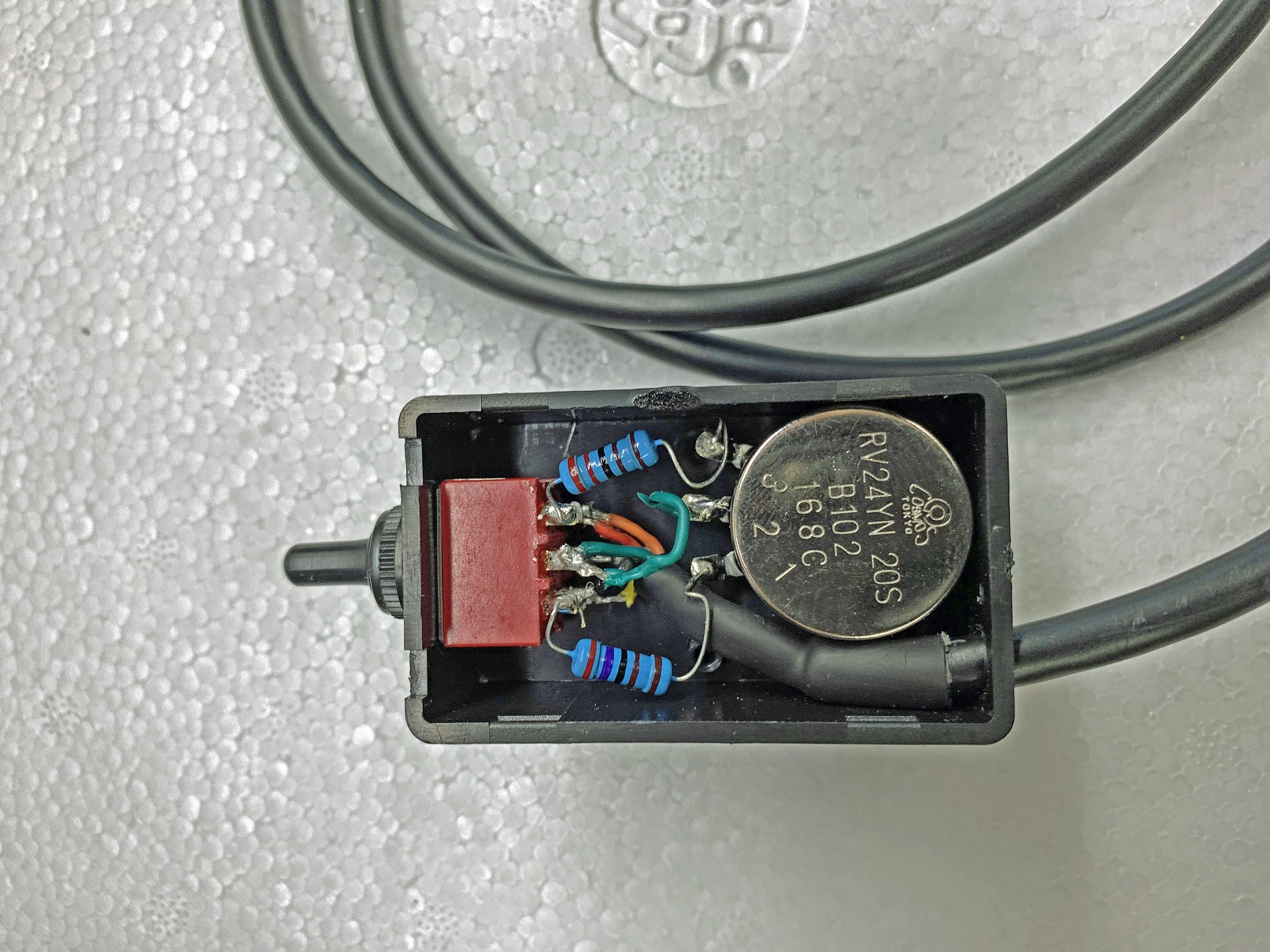

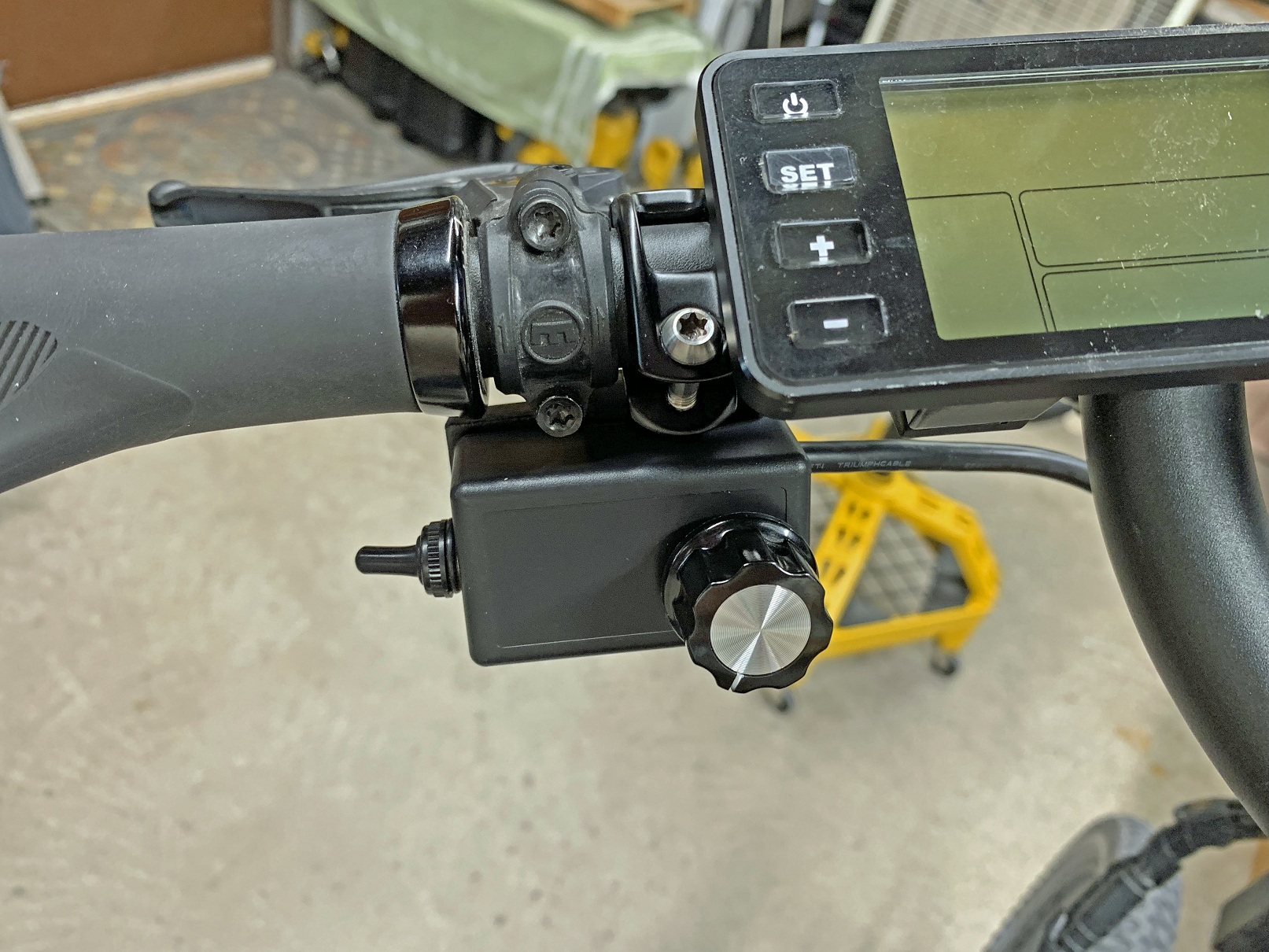

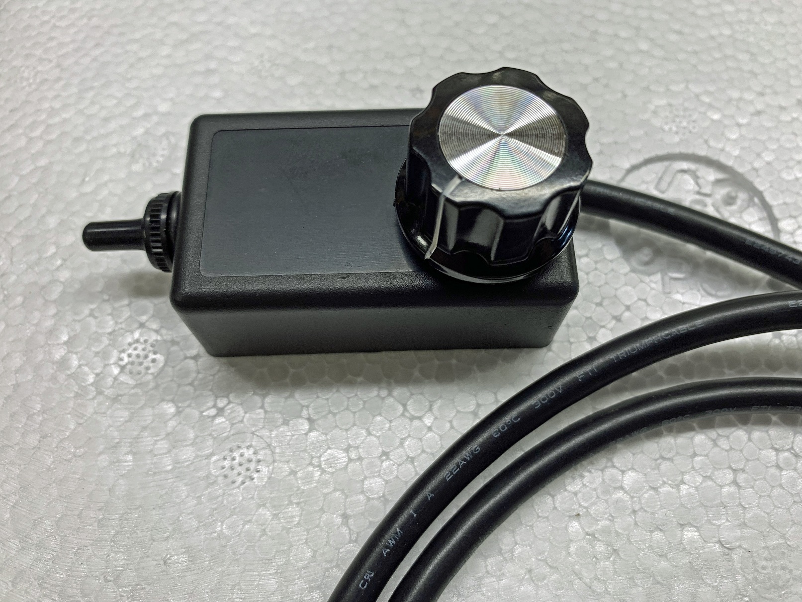

I use the rotary speed control on bikes with 30A controllers and have had no issues. The motor wattage should not be a factor. The controller has to be configured for a 3 wire throttle however. The resistor values should work with most controllers that use the 3 wire standard.
Parts list:
2.7 K ohm resistor: https://www.amazon.com/gp/product/B07WGMKTQB/ref=ppx_yo_dt_b_search_asin_title?ie=UTF8&psc=1
2.2 K ohm resistor: https://www.amazon.com/gp/product/B07WGMZ7ZD/ref=ppx_yo_dt_b_search_asin_title?ie=UTF8&psc=1
1 K ohm potentiometer: https://www.amazon.com/gp/product/B074KGJ7N6/ref=ppx_yo_dt_b_search_asin_title?ie=UTF8&psc=1
Plastic case: https://www.amazon.com/gp/product/B07Q11F7DS/ref=ppx_yo_dt_b_search_asin_title?ie=UTF8&th=1
3PDT Switch: https://www.amazon.com/gp/product/B07VHC9LYG/ref=ppx_yo_dt_b_search_asin_title?ie=UTF8&psc=1
6 conductor 22 GA wire: https://www.amazon.com/gp/product/B07Y33WL43/ref=ppx_yo_dt_b_search_asin_title?ie=UTF8&psc=1
I used the raw ended wire above to cut and splice into my wiring harness but you may be able to find pigtail connectors that will fit those used on your bike. These are a possibility:
I used these handlebar clamps for a mount but there are many cheaper alternatives:
Please note that most of the parts listed above are quantity purchases since I made up several speed controls. You may be able to find them individually and save some money.

The manufacturer of my eBike kit tells me that my controller is between 26-30 Amps so I guess mine falls into the category you mention. I have a question. How did you come up with those values for your resistors and potentiometer? I will use the same because you have the prototype but I was just curious. From my perspective, you're no less than a genius. Must have been loaned to you from Heaven's allotment. <><

No genius, just a retired electrical engineer with too much time on my hands 🙄
The circuit is just a simple voltage divider. The resistor values are based on the measured impedance of the hall sensor circuit. You can also use an ohmmeter to measure the resistance on most 3 wire throttles since they all seem to follow the same loose standard.
The resistors I used work best with my particular controller / motor combination and should give acceptable performance on most others. You can play around with the values a bit to fine tune the performance of the circuit for other bikes. I have mine adjusted so the max speed is slightly less than full throttle and the minimum is around 4 MPH. That way, I can use it as a walk assist for walking the bike up steep slopes or even stairs.
If you can find a connector that matches the throttle on your bike, I would "breadboard" the circuit first and test it before assembling the case and cutting into your wiring harness.
