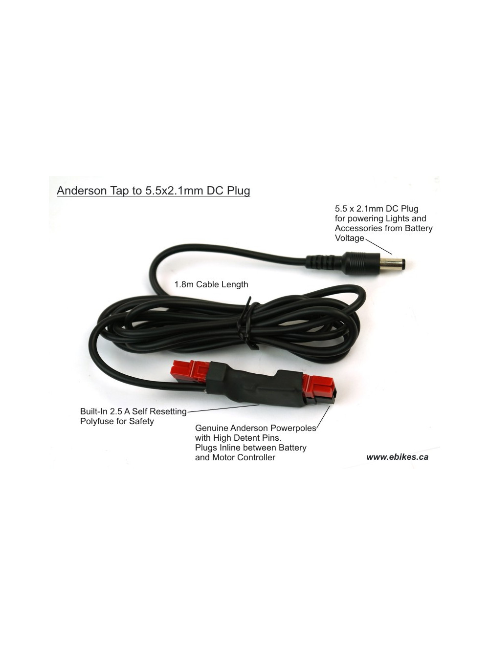

When I put lights on my E-bike, I just made sure to get ones with variable input voltages. As I recall, my tail light is variable from 6-60 V, which works fine for my 52 V system. Then I can just splice the two wires into a 5.5 x 2.1 mm round connector and plug directly into my CA3. Biggest thing is that most lights have a plug-in cable and you either have to glue it in place or modify the light so it is permanently wired in.

You can always use a battery operated light or a rechargeable light. Problem is, when you need the light and the battery is dead, you never seem to have the right battery or charging cable handy. You've got a big battery on your bike. Why not use it?
