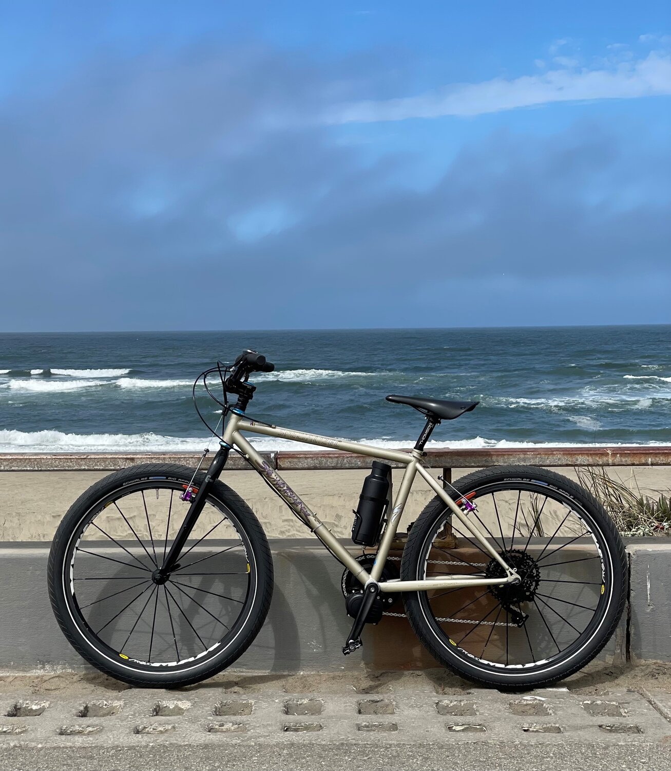

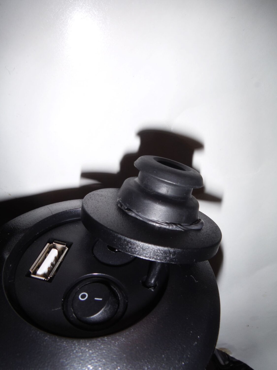

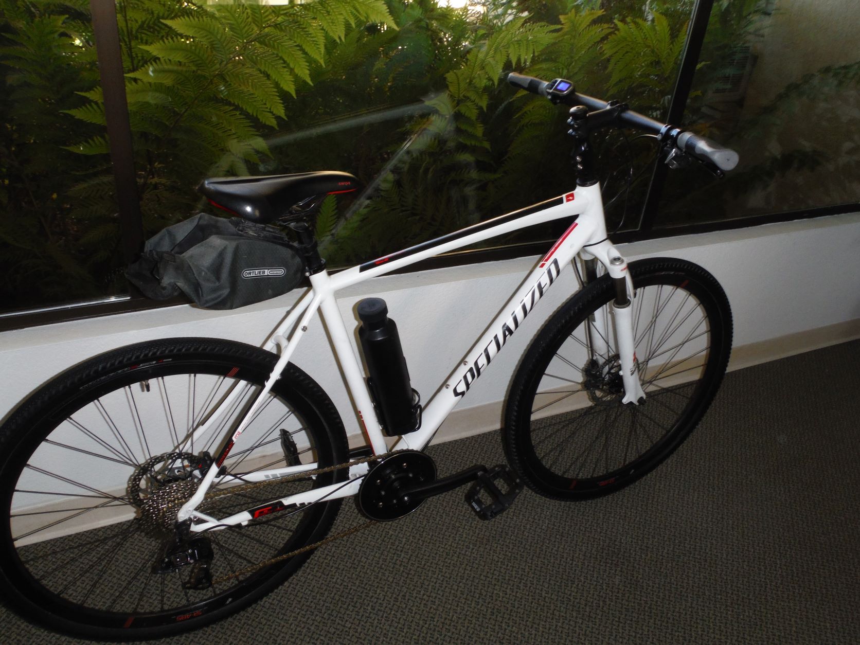

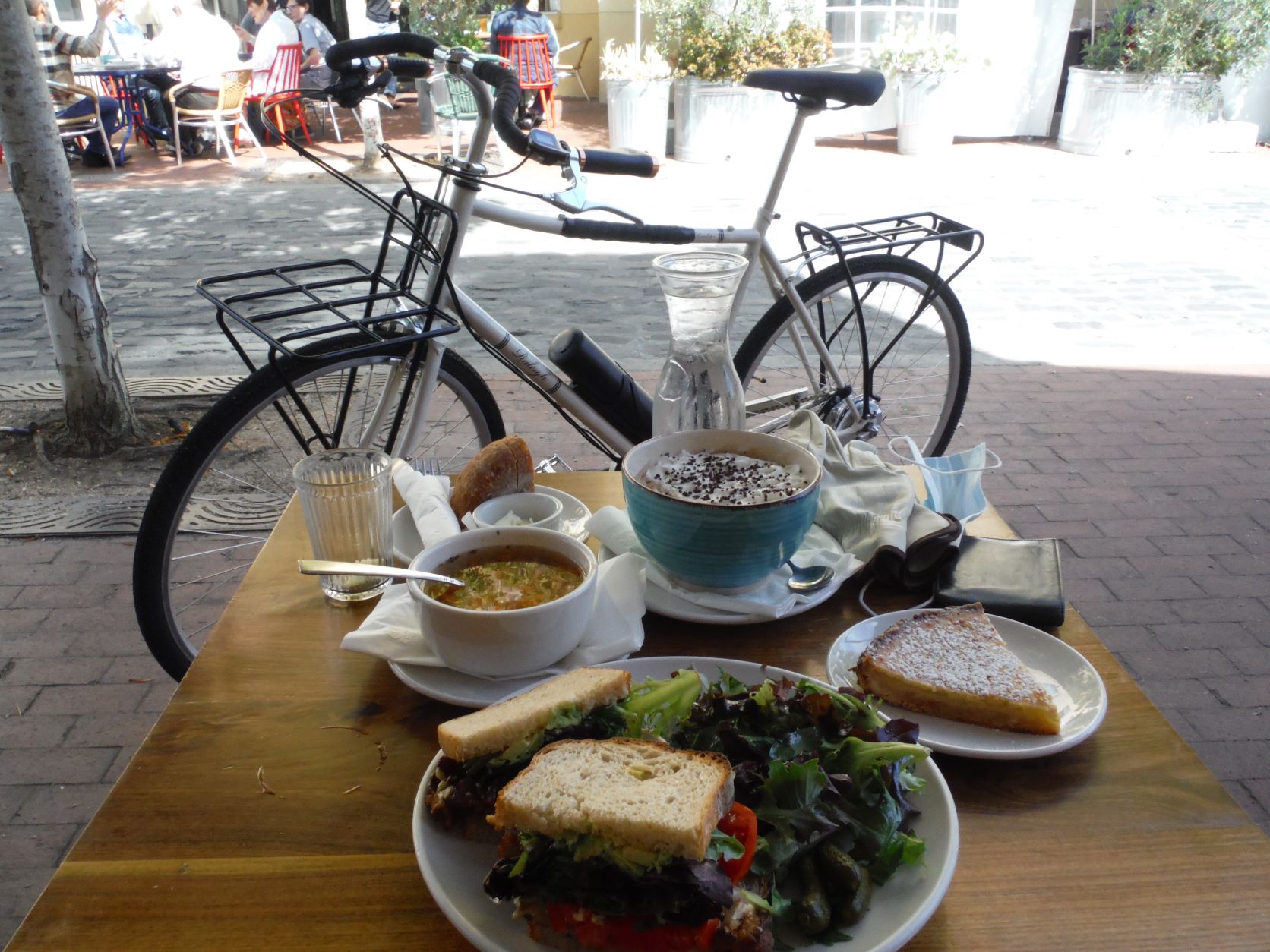

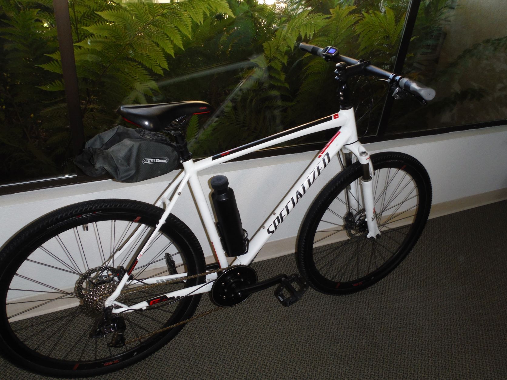

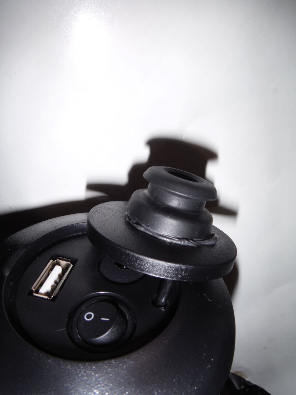

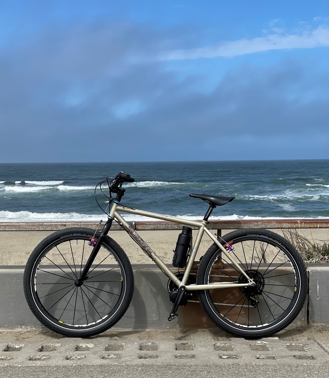

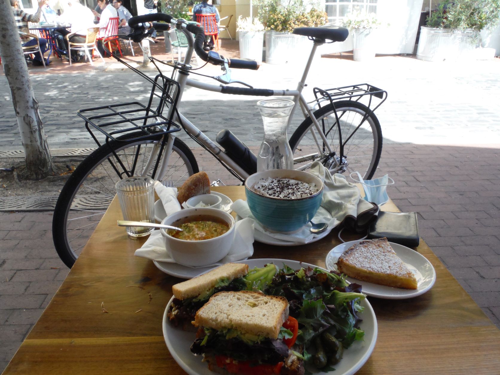

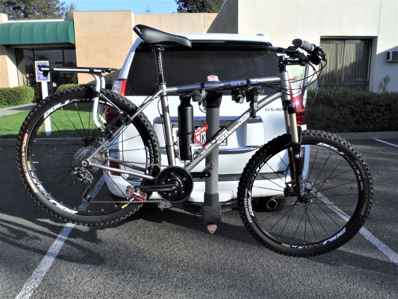

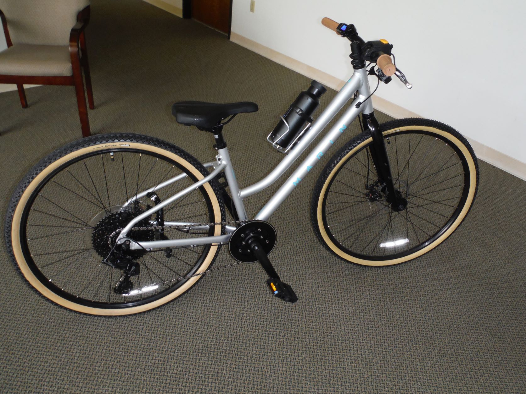

I am in the North Bay and do these torque sensing conversions for people regularly. When done right they are wonderful to ride. Better than the high-end bikes some of my riding friends have. They are open source like Wiki, Linux, or Firefox, not Apple, and replacement parts are easy to find and not expensive. A part that is $250 and takes twelve weeks for a Specialized, takes four days and costs $17.50 on these bikes. Here are some recent builds. I am working on an old bike now that will blow away and out last the ones from stores. It is subversive fun. One of my buddies had to walk his high-end store bike up a section of Sonoma Mountain wile I rode ahead and waited.
