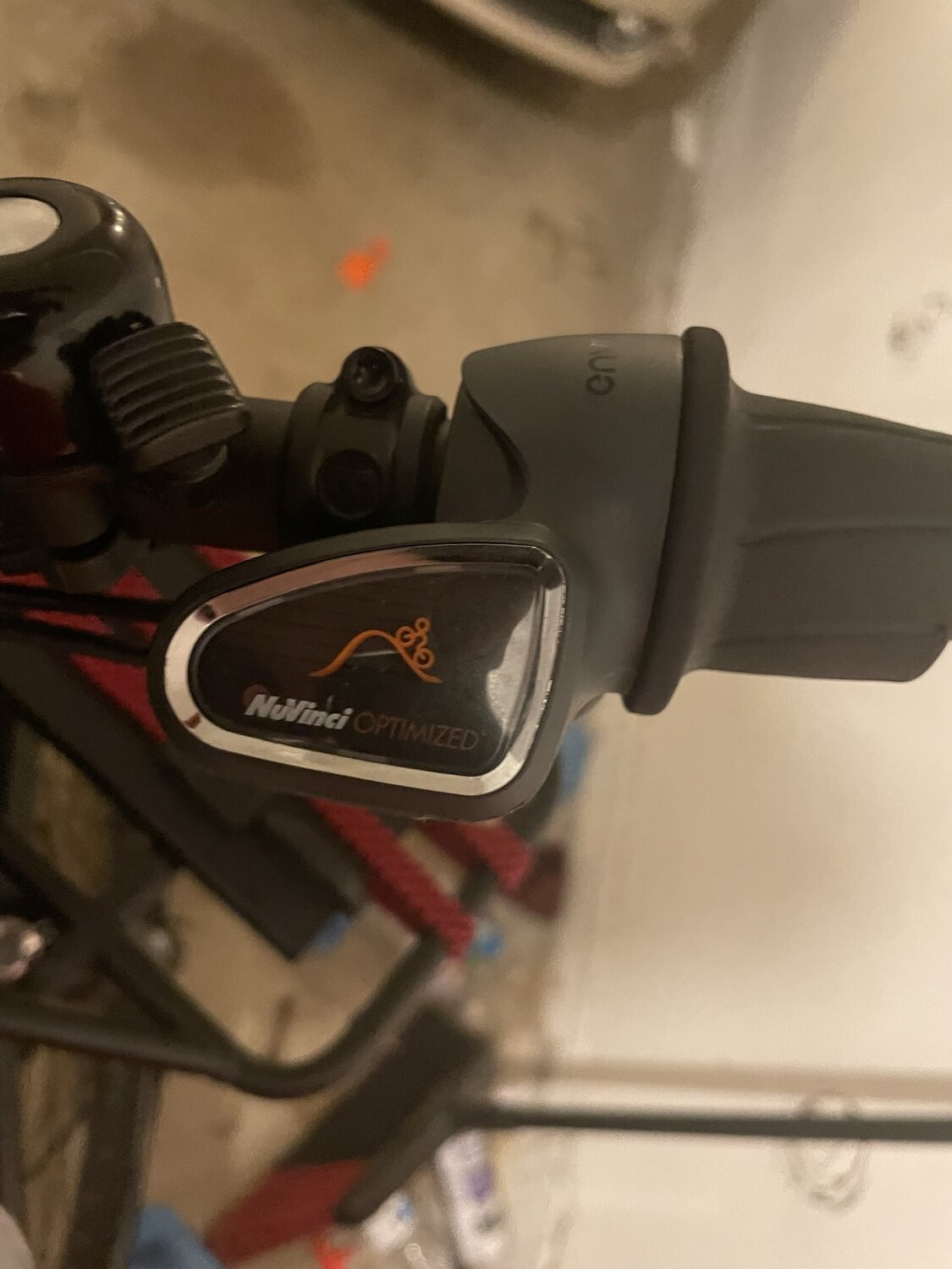

My RM, with the Enviolo manual shift handle broke. I bought a new one on eBay. Tried to install myself but one of the cables broke. I took it to bike shop who did a pretty nice job on the cabling. The problem is I have lost my overdrive gears now at least probably 20 to 30% of them. Do you believe it’s the cables or is it more than likely the interface and hub need to be reset For max overdrive?
I also had them put on a new interface because mine broke at one of the cable mounts.
I also had them put on a new interface because mine broke at one of the cable mounts.View attachment 127637

A loss of overdrive is the result of interface at the hub physically stopping about 2/3 of the way through it's rotation and this is reflected in on the shifter by the little man being unable to transition to what's illustrated as "flat ground."

So I think I figured out where I was going wrong. I was doing a lot of my testing stationary and the bike needs to be rolling to give you full range of the under/overdrive.
Additionally when my brake cable snapped I believe my shifter indicator got mis-calibrated so even when in full overdrive it wasn't reading flat. I was able to take it apart and manually move just the last gear in the set of gears that control that indicator to make it read flat while in full overdrive.

I had similar problem and eventually got it sorted, but my icon interface was off (hill to Mt Everest). The two internal plastic gears on the shifter display were out of synch, but I was afraid to force them to a new position. How did you do this? Thanks.
mkeys
Yeah I was similarly afraid to force them, for good reason. They are plastic and if forced I think you are likely to break a tooth on the gear or maybe the axle.
After some fiddling I realized that the plastic display cover you look through to see the rider indicator comes off. It is just press-fit with a 3 pretty weak clips that keep it in place. When you have the shifter open exposing the cables it is pretty easy to pop it out using a small tool to poke from the inside.
Once you have that out, it exposes a small philips head screw. It was after taking out this screw that I was able to lift up on the top casing and create enough separation between the gears so that they were not meshing with one another. While in this state I was able to manually turn ONLY the very last gear that attaches to the rider and get it into the full overdrive/flat position.
