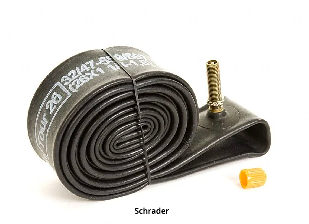

Frustrated by valve stem issues I started using tubes with steel stems with a lock ring.
Both Schader and presta available.
