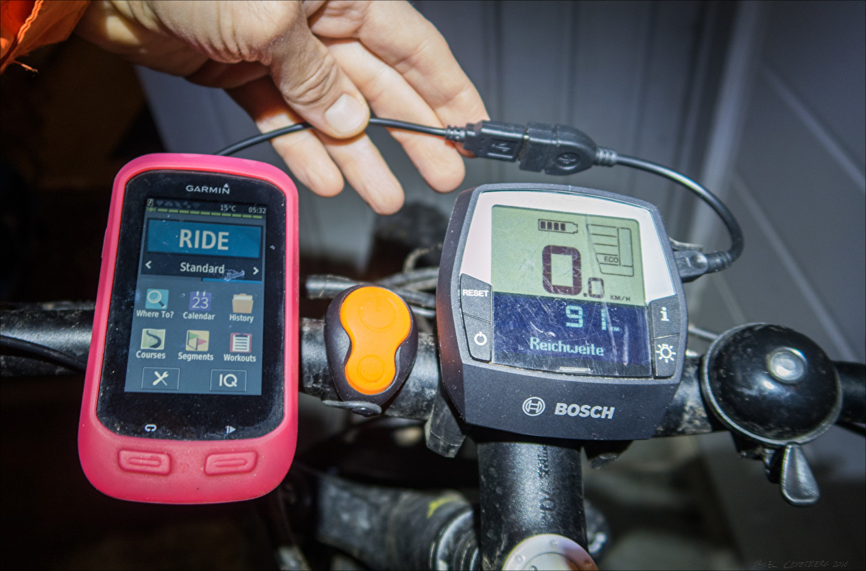

EddieJ
Plenty of people that I know use the Intuvia port to charge mobile devices.
Just one example.
Just one example.
Eddie,
Most mobile devices need at least 5V, 1A USB. Some of the latest fast chargers need 2A or more input.
When you plug in the device to Intuvia's micro-USB, the icon changes to 'charging' status but that's like super slow trickle charging.
Even at 0.5A, it takes about 7 to 8 hrs to charge an iPhone.
