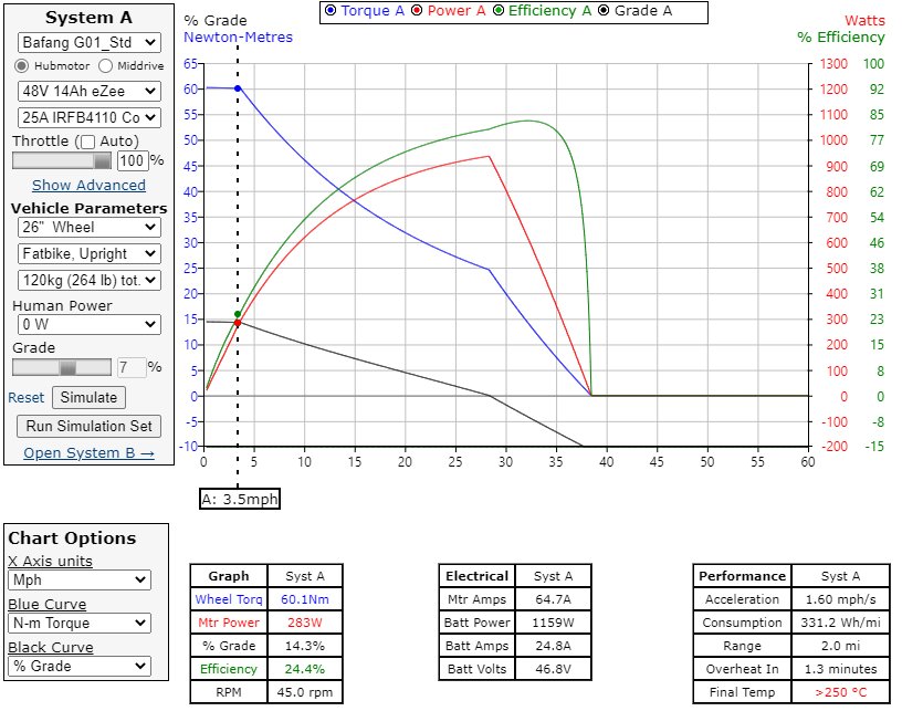

IOUZIP
Tampa
I did not see you listed the gear you were in when climbing in. Any steep climb gear down to 1st you need to keep the pedaling cadence speed up. At 3-15 mph mph you get the best power. 13-15 mph is the sweet spot for max power. The graph below is to show how the Bafang hub 750w and your 7% grade climb up Pilchuck are combine when you don't pedal.
Timpo
Sorry I'm a bit confused.
The chart says that you get the max power at 28mph with well over 900W.
But you said that 13-15mph is sweet spot for max power.
Also between 3-15mph you get the best power???

Where Motor power and Torq meet. 13-15 mph is the best speed to get the most out of the motor.
Timpo
Okay so, torque and power are two different things.
They do not "meet" each other, it may seem like they're meeting each other on that particular chart because Grin decided to combine power and torque on one chart.
Look at the scaling, one is Nm and the other one is W.
The increment of that chart is arbitrary by Grin, and Grin decided to use whatever the scale that's easy enough for users to see.
For example, if Grin used same increments for W and Nm, that would be very hard to see, because the increments for W is way more dramatic.
Therefore, Grin decided to use 5Nm increments and 100W increments on that chart.

PedalUma
The sweet spot looks to be at about 12 Mph with Blue, Green & Red in the same area. What is jaw dropping is the lower right performance box that says 'Overheat In - 1.3 minutes.' I like hour-long climbs. No wonder people fry their bikes. I have a fried bike coming in next Tuesday. The promo videos do not mention that.
